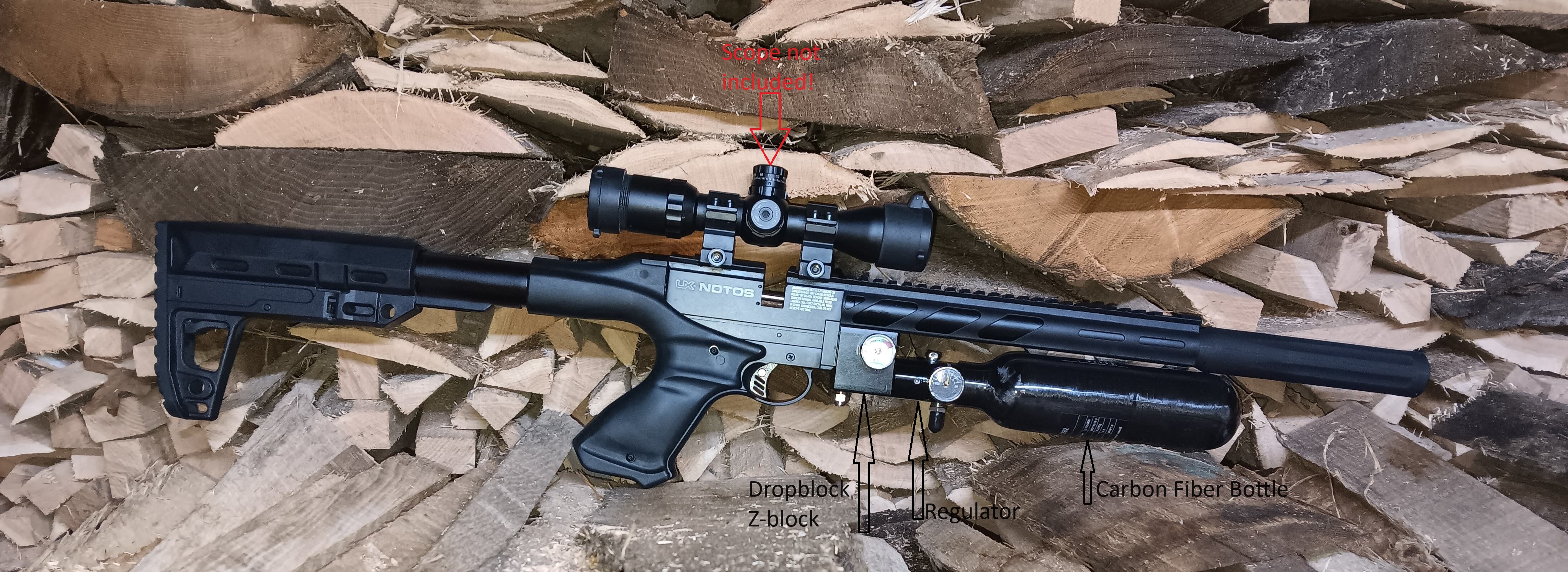

Thanks Dave. The bottle is on my wish list already. Did you have any issue having the Drop Block to "time itself" so it seats at the perfect angle ? Yours looks spot on. Do you notice the weight or have balance issues ?
This is the crux of the modification craze. Buy the parts, assemble and be disappointed with clocking or air leaking or worse yet, destabilization leading to breakage.
I actually chuck up the single gauge drop-block in my lathe and face the block to clock correctly and seat completely flush with the airblock.
I also thread the 16mm hole another 5mm deeper to allow the guns airblock to fully seat in the drop-block.
The Z-blocks are completely different, they cannot be faced, I have attempted it a few times but the outcome was sub-par. I moved to using a plenum as the clocking feature and have not looked back!
I've posted this before but I believe the weight only increased 2-3 ounces over the airtube configuration but, the balance moved forward a couple inches and the air tank made for a rock solid grip.
I've increased my off-hand hit ratio significantly with the bottle mod as the stock Notos leaves the gun a little light on the barrel.
