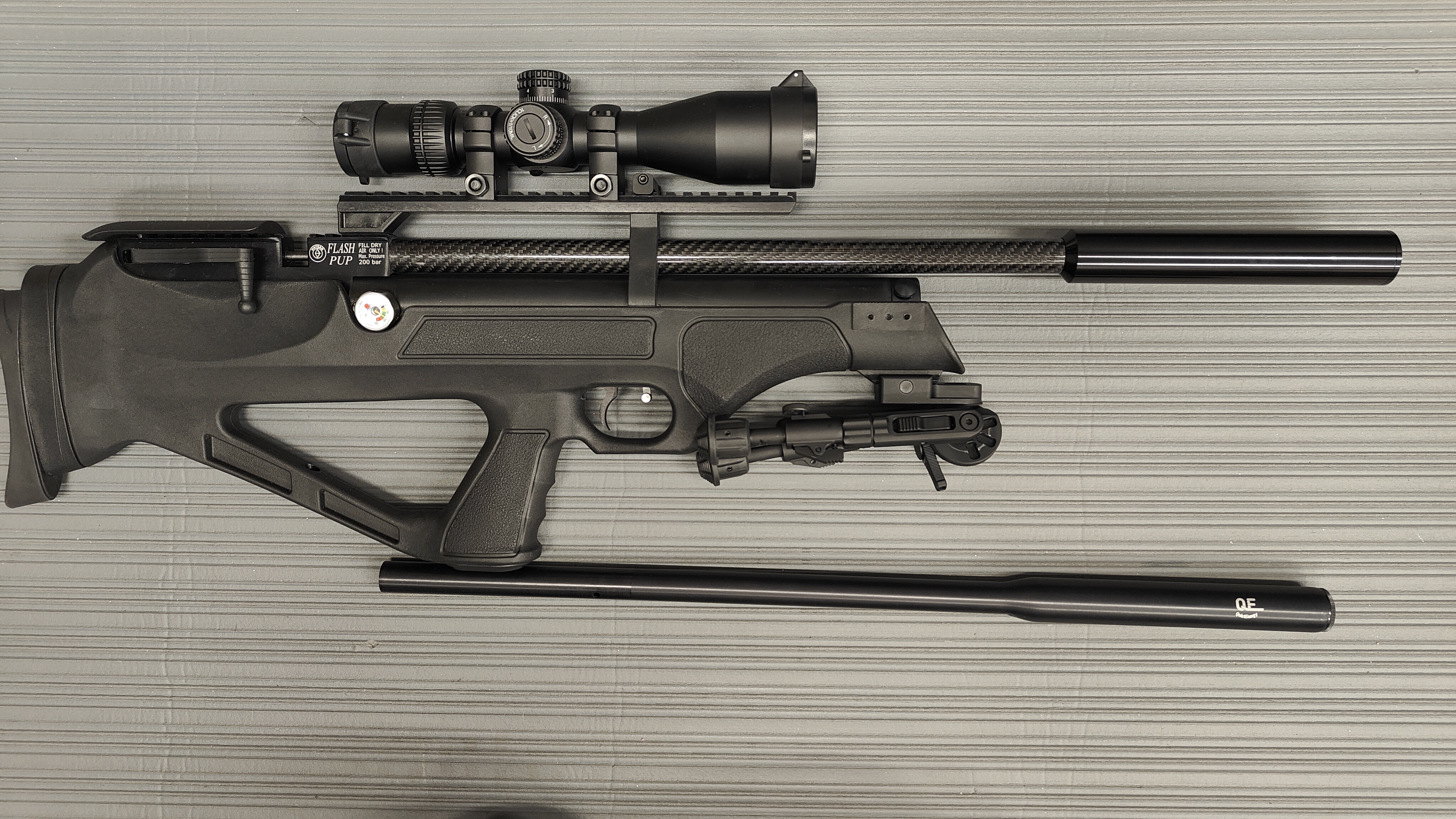

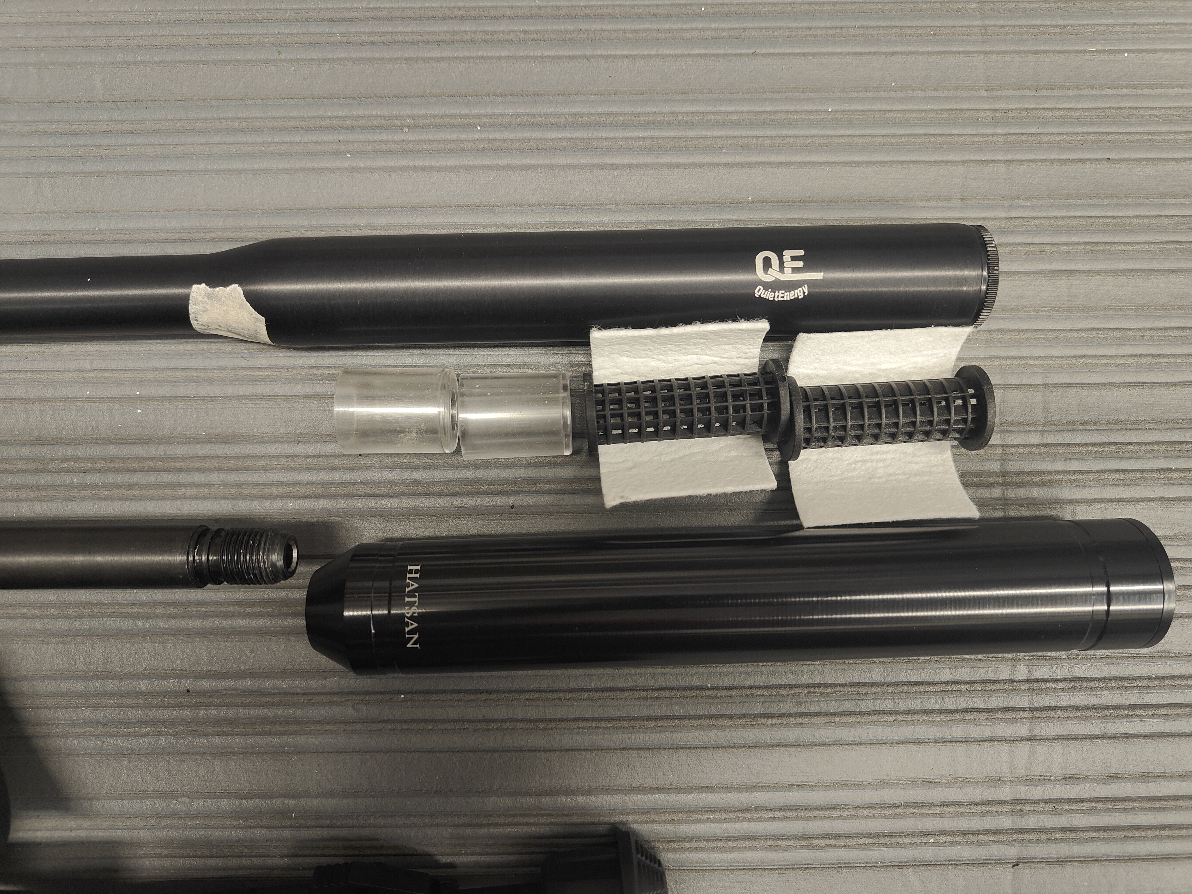

I did buy Hatsan Flashpup QE S .22 cal.
It was built in quiet energy silencer so i hope it will be quiet.
Was it really quiet, no.
I did try modify that qe silencer little better, but it did not help so much.
So i did order adapter for end that hatsan pipe that it can fit also 1/2" unf moderator and need to buy moderator.
That moderator was also hatsan and it did work ok.
After that gun was too long for with that extra moderator and i didn't want cut that original barrel "cover" pipe.
Also did test with moderator strait to barrel without that outer pipe. Gun barrel was unstable and pellets didn't fly where those should fly.
So i did find ebay carbon pipe right outer diameter and inner diameter was little too small.
That carbon pipe was not my own idea. I did found that some youtube video and also how to make that inner diameter correct with sandpaper with wood rod and drill.
Moderator did changed just litle shorter Hogan and it was better and more silent.
Later i did buy huma regulator and get tune for lower fps.
Regulator is set for 130 bar and last hammerspring setup was 4.5 open if i remenber right.
Now it shoot Jsb hades 15.89gr.
For 872 fps.
Better crono result are my old phone.
Those numbers it is silent.
Only can hear light hammerspring sound and pellet hitting for target.

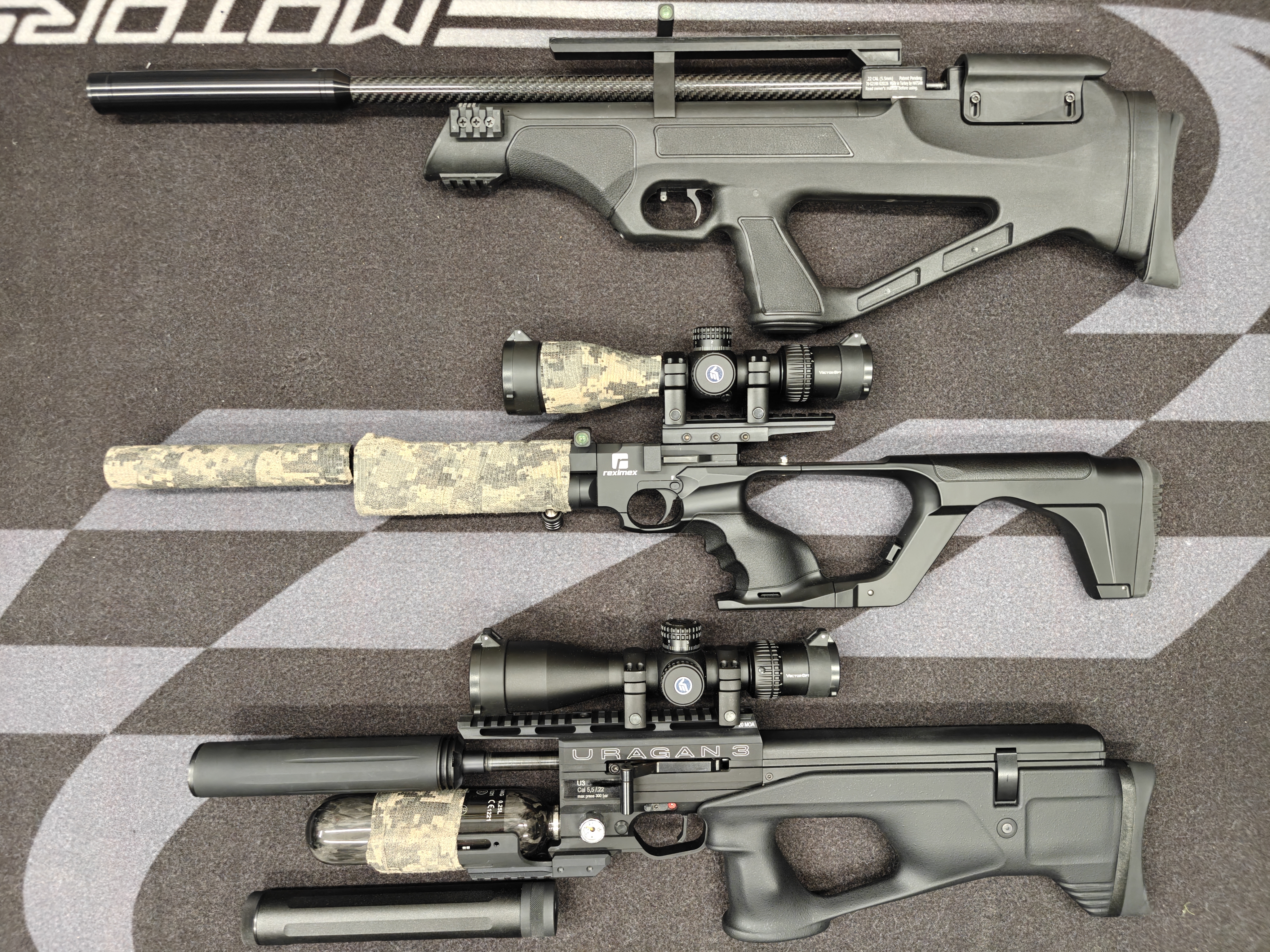

I also have Reximex RP .22 cal. carbine.
First it was with Hawke Vantage Red Dot 1x20 3 MOA.
But it was not good and i was able to return it.
After that i did buy Vector Optics Veyron 3-12x44 SFP and it did need Umarex Picatinny Rail Adapter 130mm (5″) x 21mm.
Newly i did buy Agt uragan 3 compack.
Very nice and accurate gun.
Surprising or not, but it need some silent mods.
