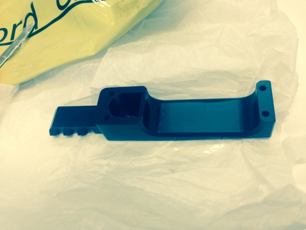

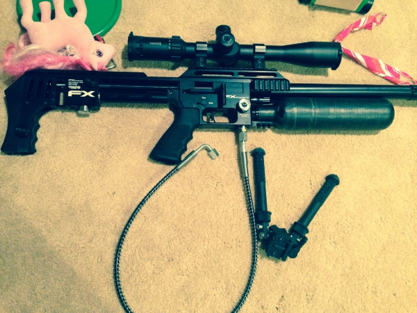

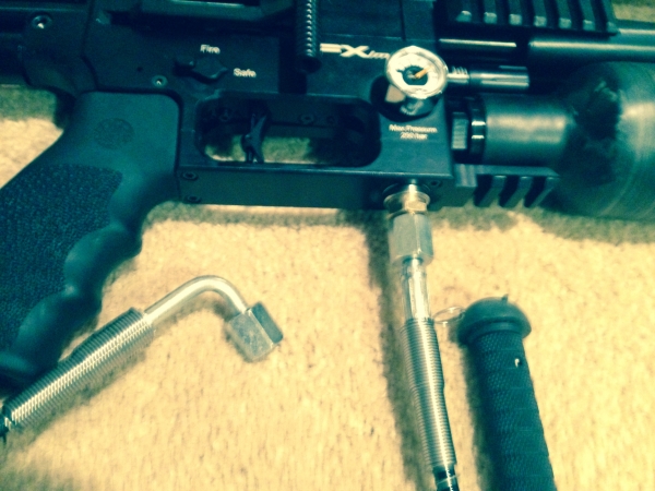

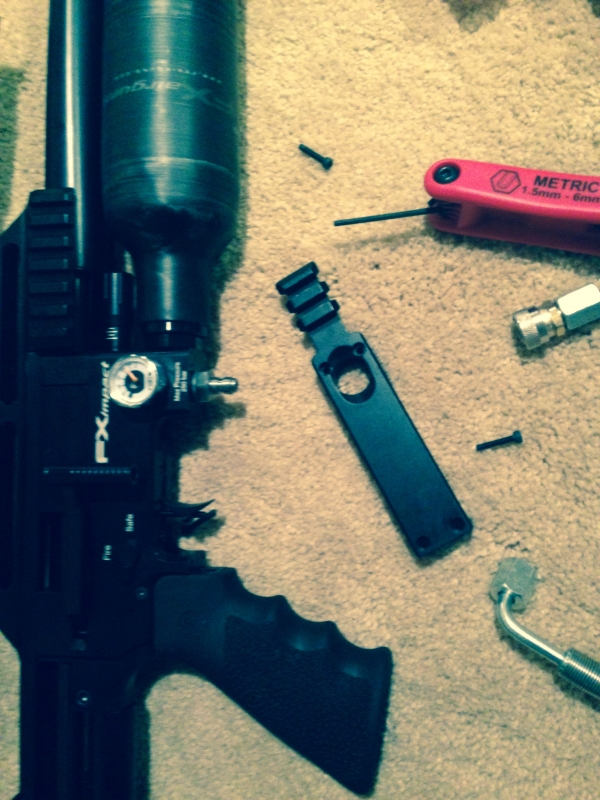

Most have all been here before, unable to get the female foster out of the impact fill port. Any thoughts or suggestions before I take off the trigger guard? Looks like it's time to purchase my first mod - the Kraford & Lypt "easy access trigger guard". I very nice demo on what I am doing next, which is unscrewing the trigger guard. I really do think their product is worth it. I trim and file my finger nails very close, so getting that hose out without some light disassembly work is a no go for me.
By the way, it took about 60 seconds to fill my Impact from 150 bar to about 230 bar with the compressor. Not sure that 75 cubic foot tank was the right call - should have gone with the 13 cubic foot Omega tank. With AOA's 12% sale and free shipping ending tonight, it's either the tank or another carbon fiber bottle for the rifle. Plus more .30 caliber pellets, I suspect I am going to be shooting this a bit more than I thought.
Well, that was easy, the screws were not that tight, so taking them out was a snap. The foster came loose once I started to trigger guard off. No way I will be able to ever get my fingers in there with the current set up. I did get a fill probe extender, which I may put on until my Kraford & Lypt arrives. Eventually those hex heads will strip on me if I keep doing this every time I air up.

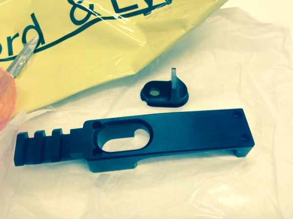

Last post for on this thread, my trigger guard arrived today from Kraford and Lypt - great construction, I will post a follow up if there is an issue with the fill port cover staying on, or if the piece does not fit onto my Impact. If they used a good magnet (hopefully it is Neodymium), and the dust cover this stays on with no issues. Can't want to install this tonight, my female foster also arrived today from AOA so no I can fill my Impact with my 75 cubic foot tank. Again, I will report back if there are any problems, or to answer any questions other members may have about this Mod.

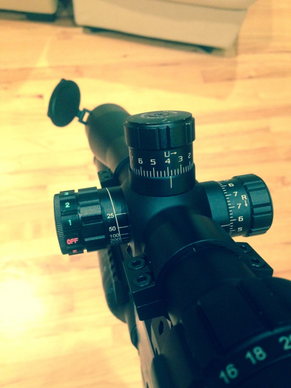

I still have a lot to learn about shooting from a scope and need to consult the manual big time. For instance, if I magnify too much, the target gets blurry. At 40 yards, a magnification of ten (or less) gave a clear sight picture from my Hawke Sidewinder. But as I increase from 10, the target starts to get blurry. Not sure if there is a focus adjustment so that I can dial the magnification to twenty and shoot at 40 yards. Will read the scope manual later tonight. The illuminated reticle is very cool, it's a very good scope on a great rifle. I was getting quarter sized groups at 40 yards - this with zero wind. But with a compressor and my set up, practice in the back yard is a snap, the hardest part is finding time when my two young girls and wife are occupied.
Yo Shortslide ... You have the same scope I do 8-32x56 Sidewinder. There is a SWAT (side wheel adjustable turret) on your scope located right beside the illuminated recticle adjustment ... soooo as you look at your mounted scope from the top ... it is just to the right of the illuminated reticle adjustment. A little closer to the main tube you will see numbers like 10 yards .... then 25,50,100 all the way out to infinity. As you change distance that you will be shooting, turn that adjustment and it will focus for you at whatever yardage you will be shooting. you can also use it almost like a range finder to figure out your holdover.
​There is also an ocular lens adjustment at the rear of the scope and this should be adjusted for your eyes so you can get the brightest crispest image possible. Actually it is the first thing you should do after mounting the scope. Hold the scope about 3 or 4 inches from your eye and look through the lens at a blank flatly lit, bright area such as a wall or the open sky. If the reticle is not crisp, clear and sharply defined INSTANTLY, turn the eyepiece a couple of turns in either direction. Quickly glance through the scope again, if the focus has improved, but not perfect, continue focusing until you get the best picture possible. As mentioned earlier, this should be done quickly ... raise the rifle, take a quick glance into the scope, lower the rifle and adjust. You want it to where you can throw the rifle up to your shoulder and you automatically have a crisp clear reticle right in front of your eyes. Do it as many times as necessary to get the focus correct. When the focus is correct, rotate the inner lock ring until it is tight ... that will prevent it from getting out of adjustment.
Lsplyt,
I have the Hawke Sidewinder Tactical 6.5-20x42 so I am not sure my scope works the same as yours. But using your post, I found that there is another control wheel on my left turret - this as you look down the scope. The outer dial is the illuminated recticle adjustment and the inner dial on that left side turret has numbers to infinity like you said. And there was just enough light for me to focus on a 100 yard distant tree and use the SWAT to focus the leaves - this using my full magnification of 20x. Thank you so much for helping a scope newbie out on that. The guy I was shooting with yesterday did not know how to focus either.
