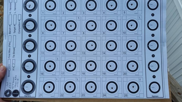

Yes those Polygon barrels foul up quickly. The RAW BR rifles use the same barrel. I think most of the BR shooters run a patch or two through their barrels between 25 shot cards? Have heard of some doing it half way through the card? I shoot Field Target with mine which isn't quite as critical. Took me a year, but I finally shot a 250 card with it.
And I've never even put a scope on a rifle until I got my first Gamo silent cat in 2013! LOL The addiction was strong with this one.
Maybe Ken Hicks will chime in? He won 25 meter at EBR this year with his RAW. I think he has a pretty strict cleaning regimen as well?
He's shot plenty of 250's
Me only the one so far, but haven't shot BR competition ever. Just something to try at home. Shot plenty of 247's, 248's and even a 249 with it.

Hi Jimmy my friend, yes I usually pull a patch after every 25bbull card..... but..... at EBR i did not.... the dry desert air i guess made a difference from the humid fla air I train in. I didnt clean the barrel at all during the match and i shot a 248-11x
250-13x
248-10x
just when u think you have your gun figured out....lol
