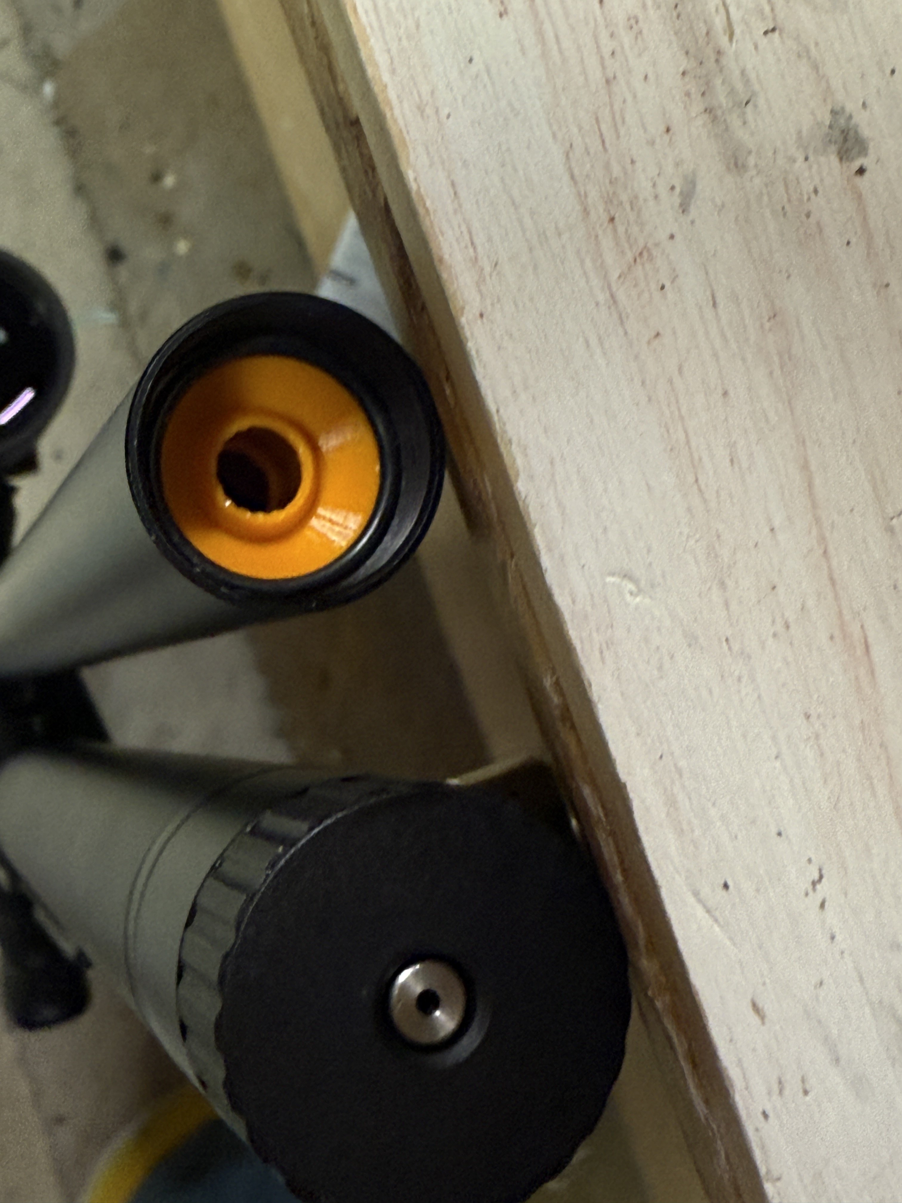

I thought I would share an update regarding internal baffles.

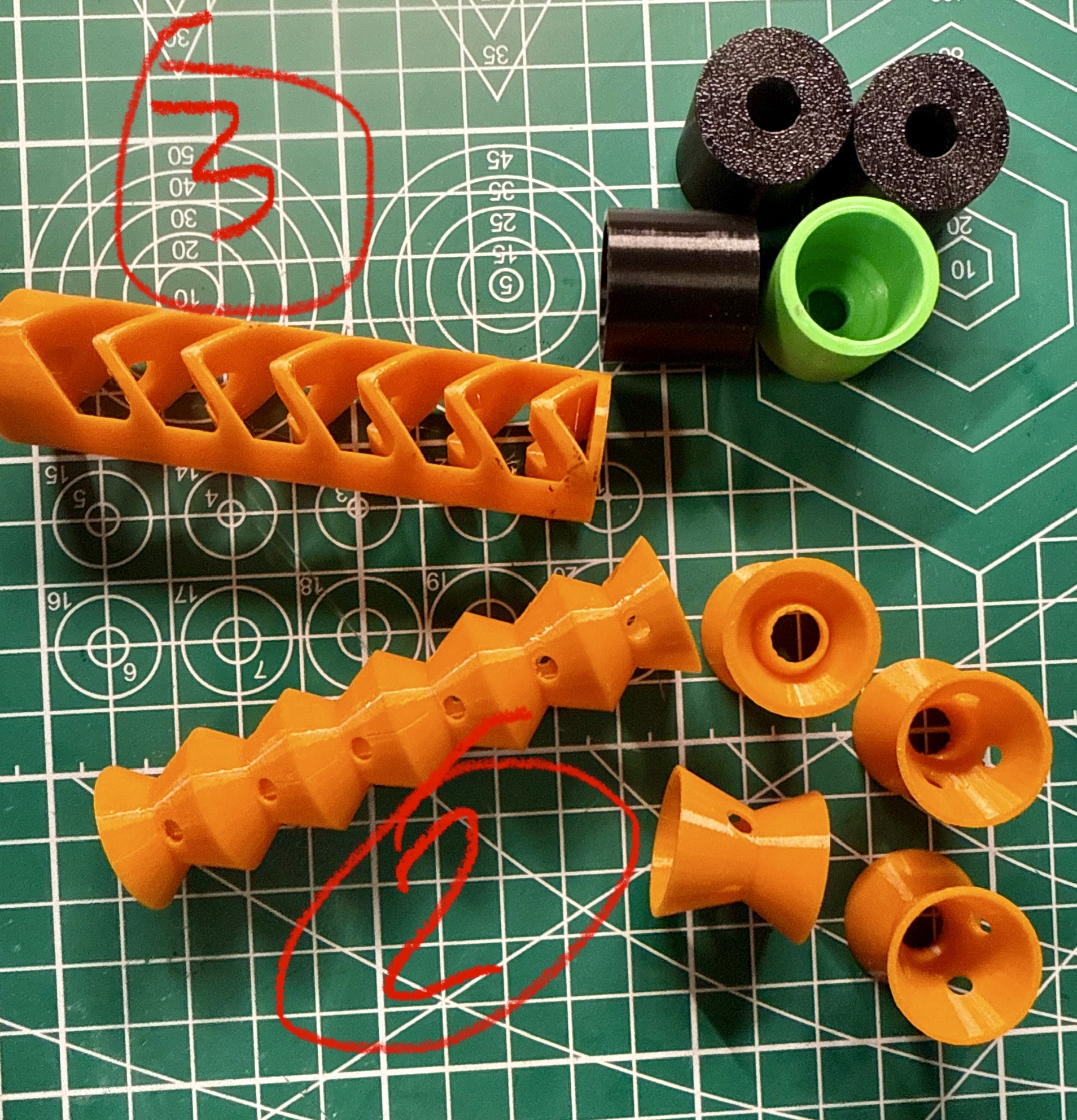

I have a 3D printer and decided to try a couple different baffles to see if I could discern any noticeable difference based on design. They are based off of existing scaled/modded versions of free designs on 3D sites. I did not engineer them from the ground up. I did not have any expectations but it was just a chance to merge 2 hobbies.

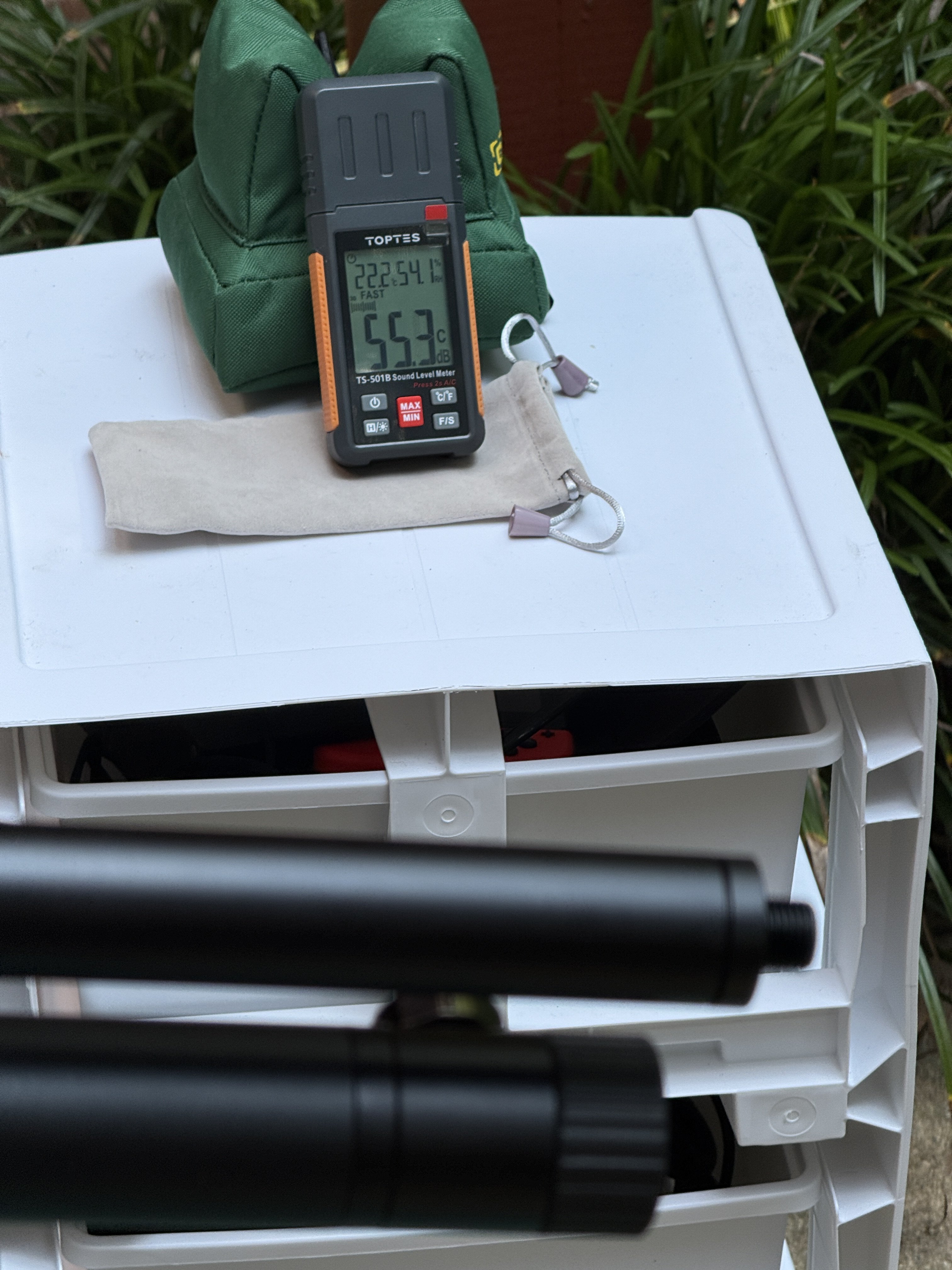

Backyard back of napkin results. Not high science by any means. Just my own personal experience for fun.
I measured against stock using an spl meter 3 feet away.
Ambient noise level was about 55db. Measured each 3 times.
1. ~79.8 DB -Stock no baffles inserted into the shroud.
2. The two 3D printed models were roughly the same~ 70db. The Bravo3D I had on hand did about the same.
Subjectively, the tone of the report does change even at the same db. I found my version 3 to have the least Snap sound vs Version 2.
I plan to run this version with my DonnyFL fatboy 2 or impulse air moderator for backyard plinking.
