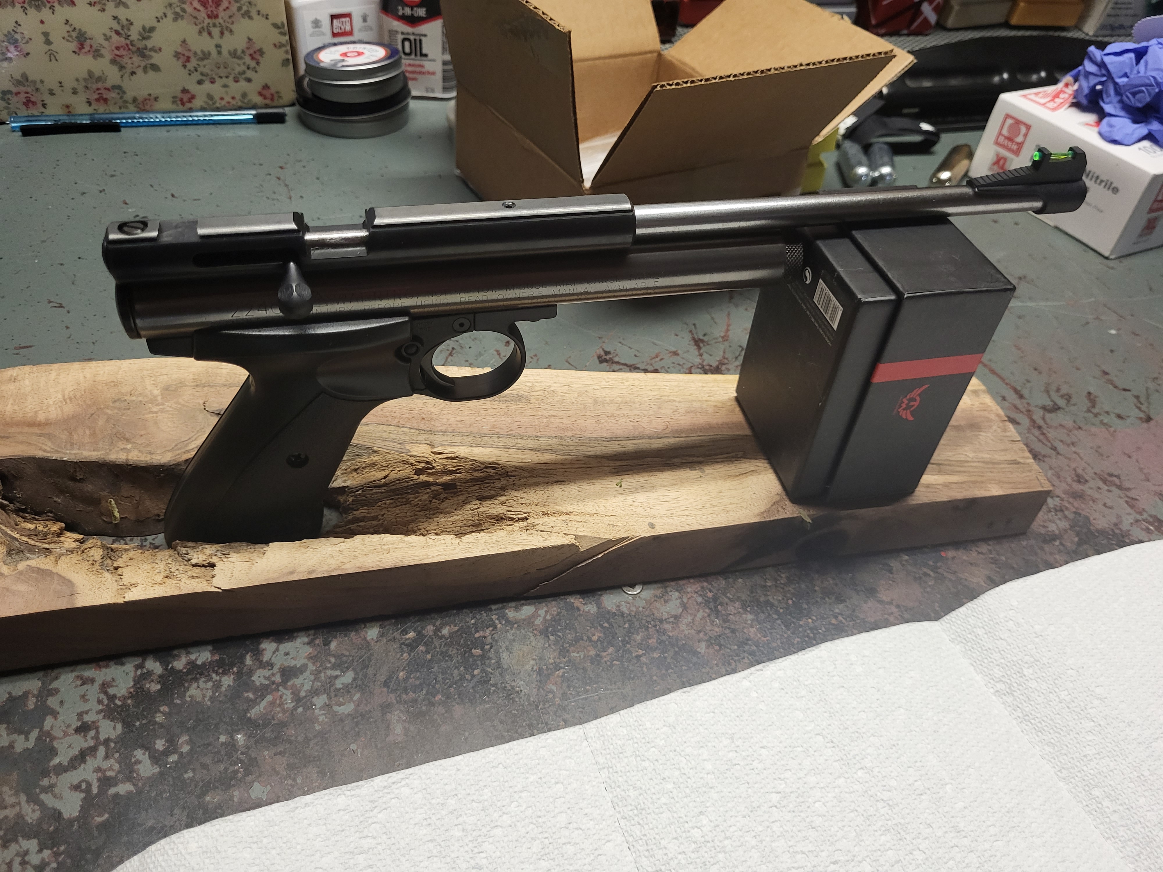

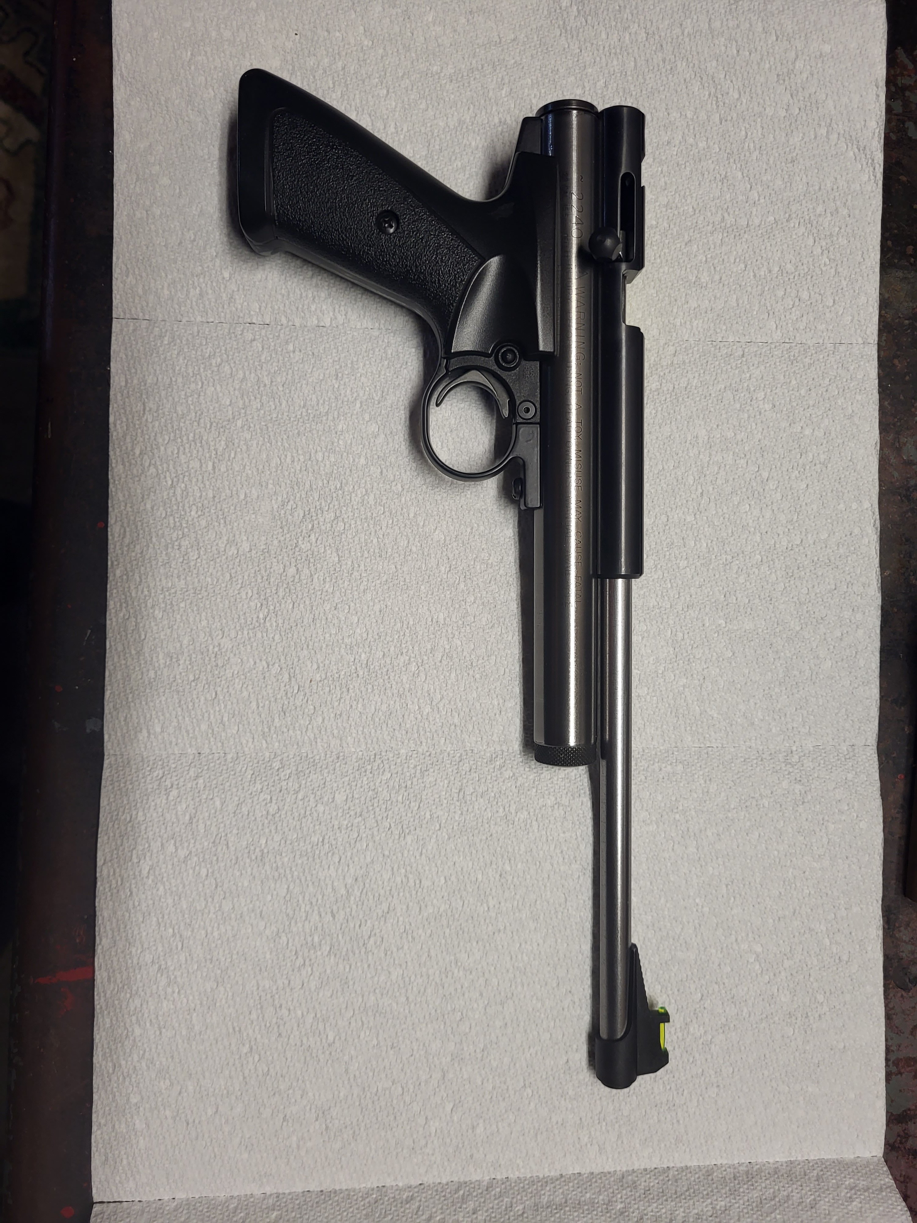

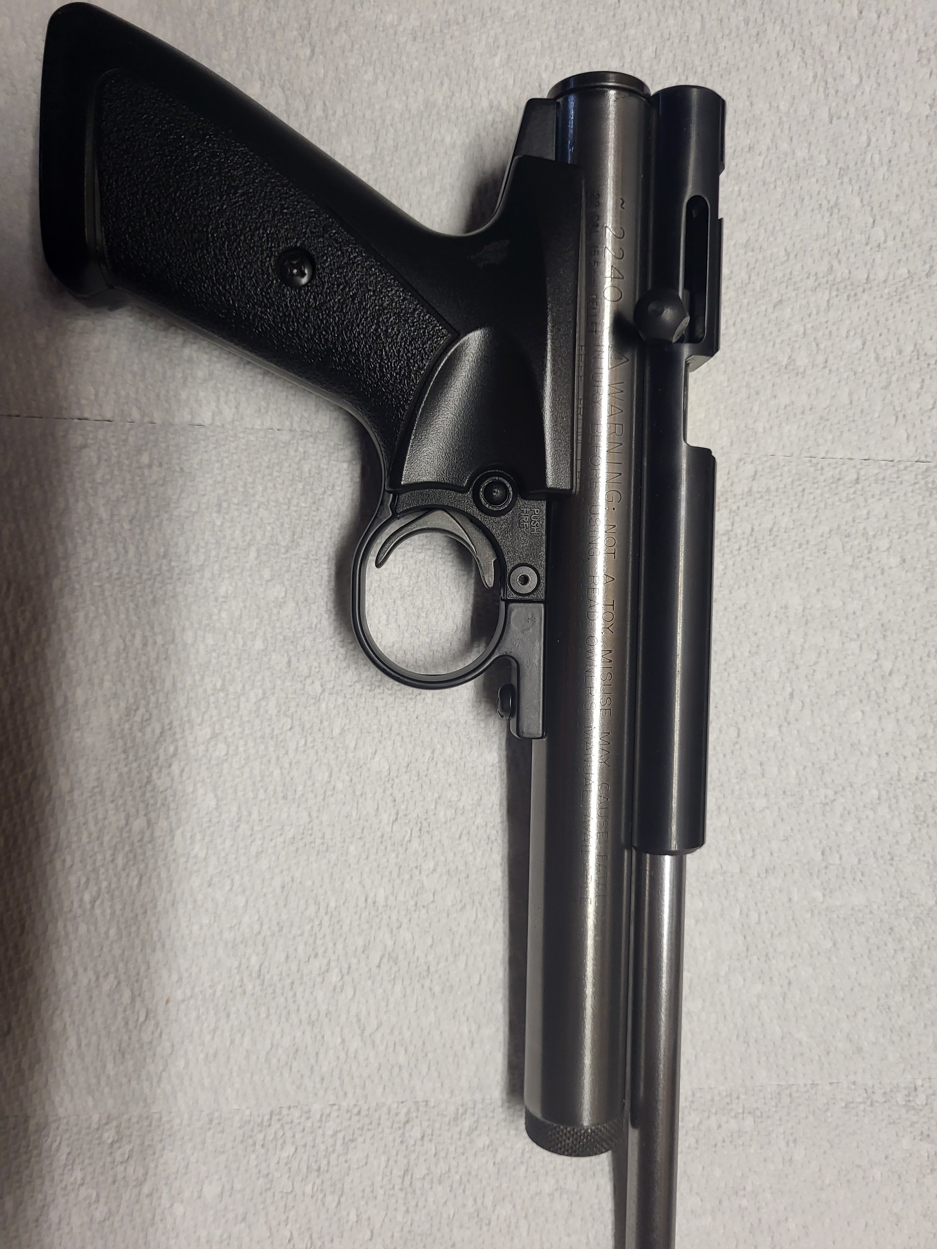

Hey guys I'm new here, looking for some imput on a build I'm working on see what ya think and any suggestions. Also what is commonly used to seal the metal on the tube and barrel after polished.
The pistol was a 1377 to start now its more like a 2300
What mods are actually worth it? This pistol is for target 10m, id like the finished build to be around 420fps to maximize shot count.
Is the extended bolt probe really effective?
Do I need a barrel band?
rear iron sights?
Cost effective grips?
Is bulk fill C02 good? How to regulate?

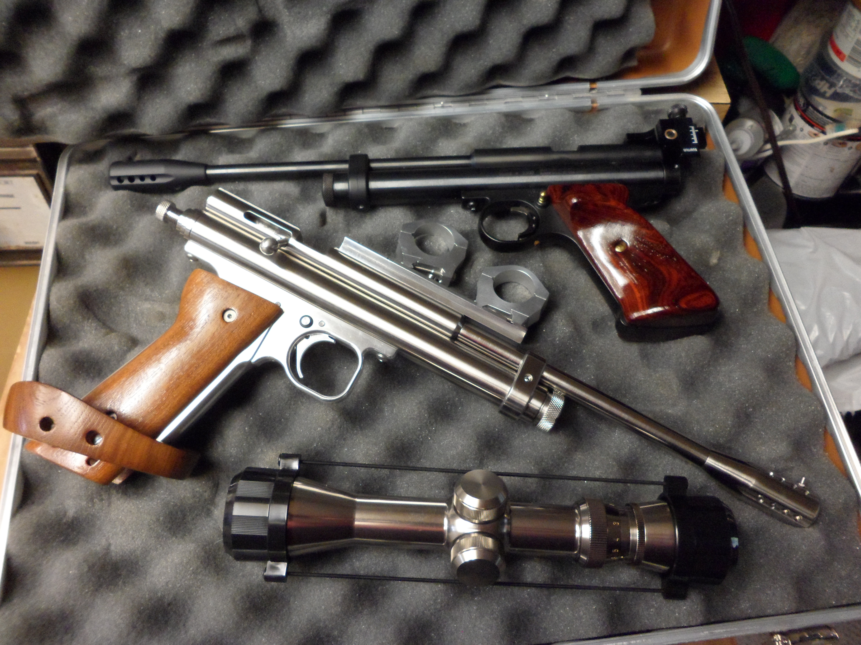

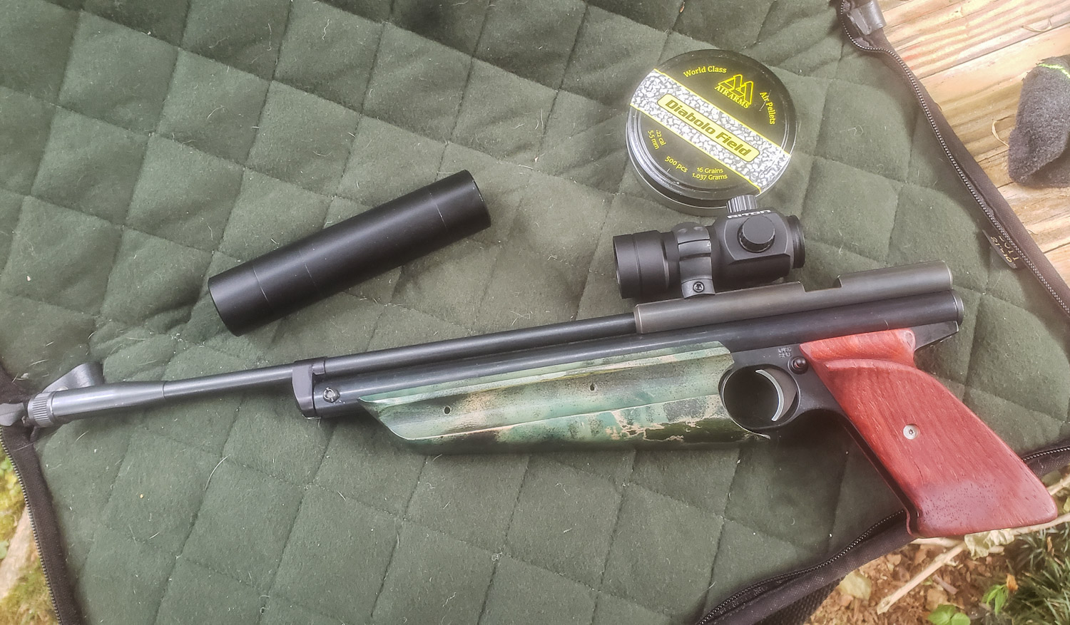

EDIT: I must apologise for my rushed initial response, but here's a pic of my latest build -
a 2400 CCS tube with a pinned co2 rear valve/disco valve head combo, a mellonair prepped 12" 22 caliber barrel & power adjuster, Magnum Airpower fill adapter, alchemyairwerks breech -

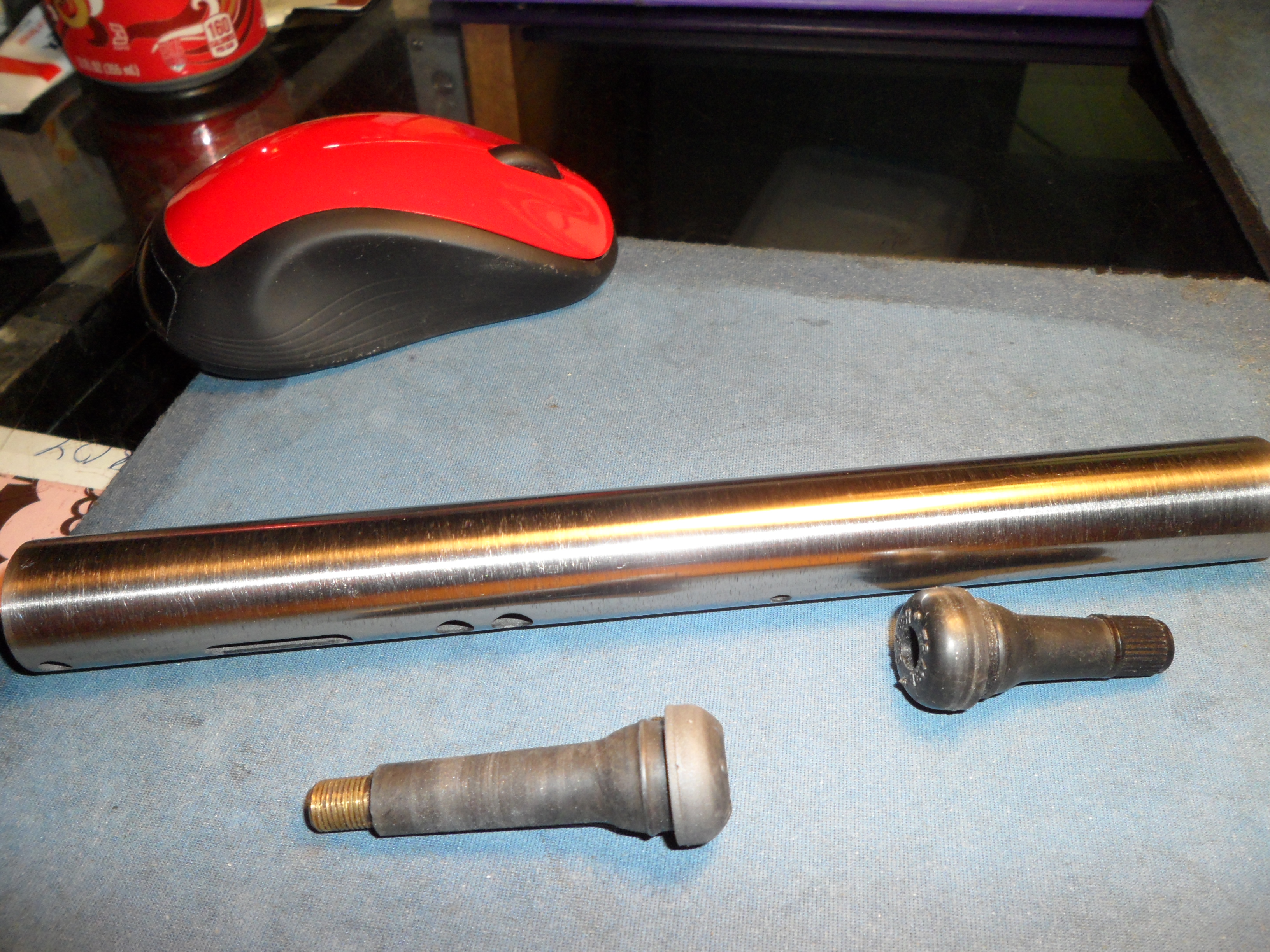

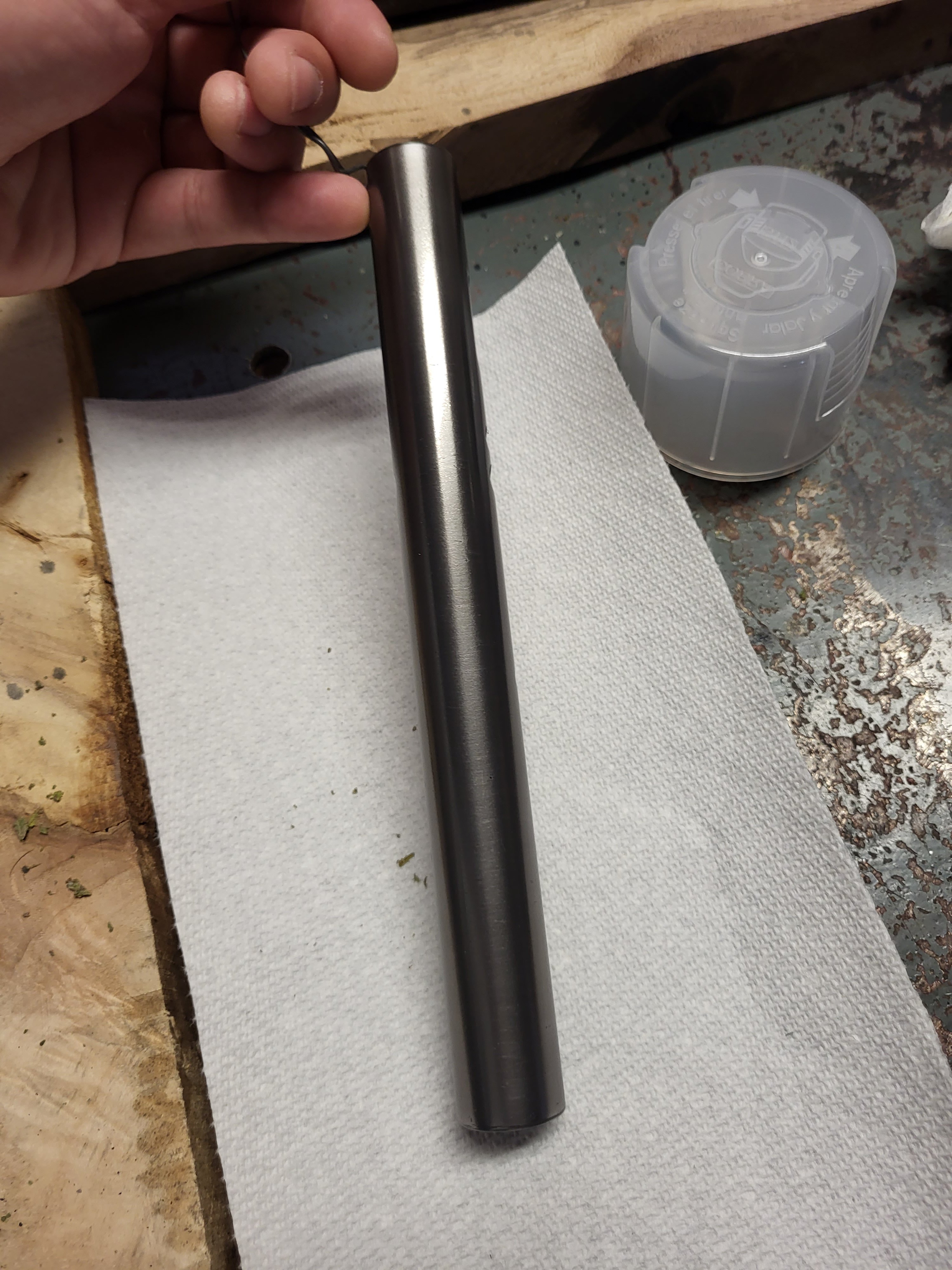

first off trying to polish a factory 2240 tube is a complete waste of time, you have gotten to where you are but it is not even close to being polished
the Crosman 2240 tube is the crudest of metal parts you will ever find
if you want to polish a tube and get somewhere go to Ebay and but a 2300s tube
t polish the barrel use a tire valve, it will fit in the tube and chuck it up in a drill and have at it and after 3 or 4 hours you will be there

get a new tube and start over and if you what KS metal makes stainless tubing that fits the barrel OD of 7/16 but the front cap will be tight on clearance
if you what to wax the bare steel or keep it wipe down

the tube pictures are of a 2300s tube and it is not completely polish but you can see you will something that is very nice

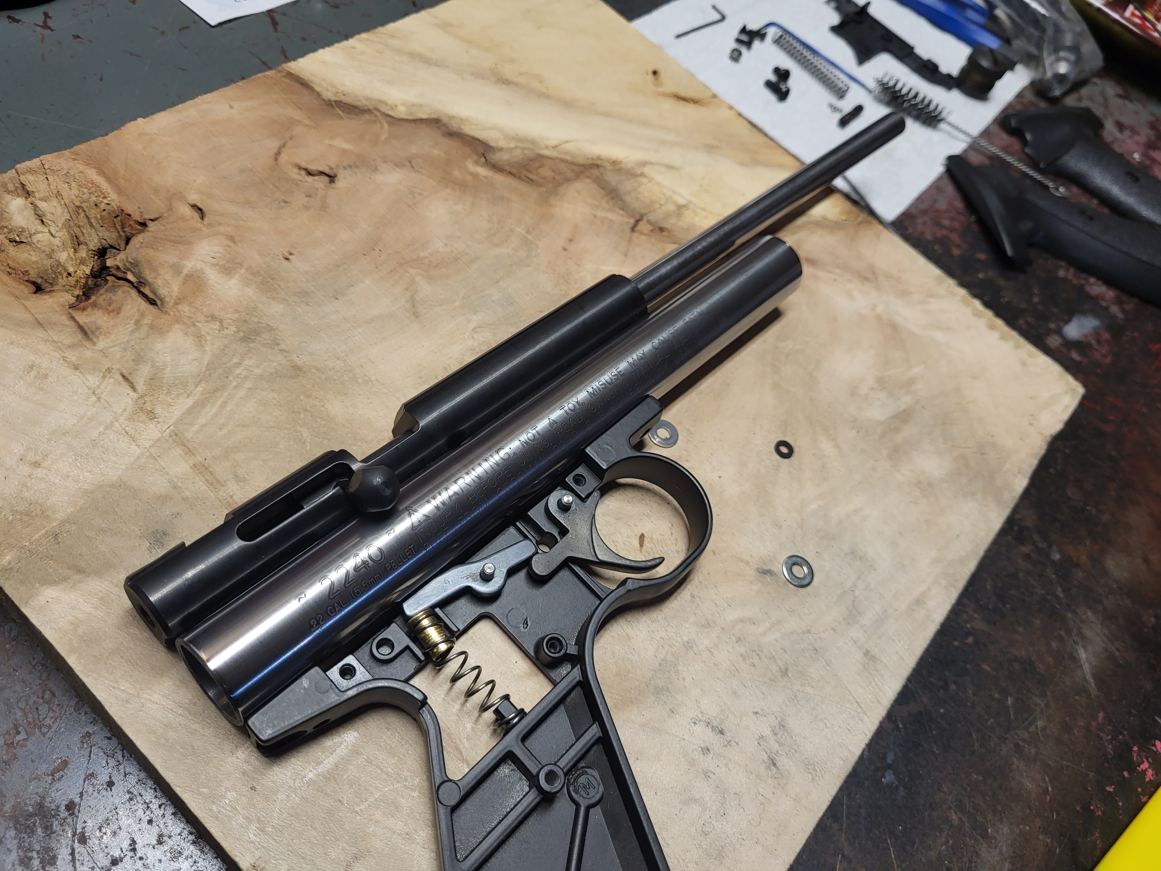

Thank you for the reply I love the grips especially in that redish brown very much what I'm looking for, thank you for all the info. I was thinking that the extended bolt was a bit much. Barrel wise I think im good I had the barrel and trigger frame/group as a 1377 for years and it was a great shooter. Now this might be a little crazy but I just cleared the power tube and barrel with clearcoat and it looks great. Is this a thing or am I crazy. Has a great look like a pewter
Reactions: Long_Gun_Dallas
Shoot, I have. And do. I have a steel transfer port that is bored out in my pumper. I never get a complete seal, at least on the top side. So I use just enough black rtv to seal it. I'll press it into the under side of the receiver, and then use a q tip to clean any excess. The bottom has a rubber ring that does seal. Wait 24hrs for it to set up. Gota be cleaned and redone if I take the gun apart, but that's pretty rare.

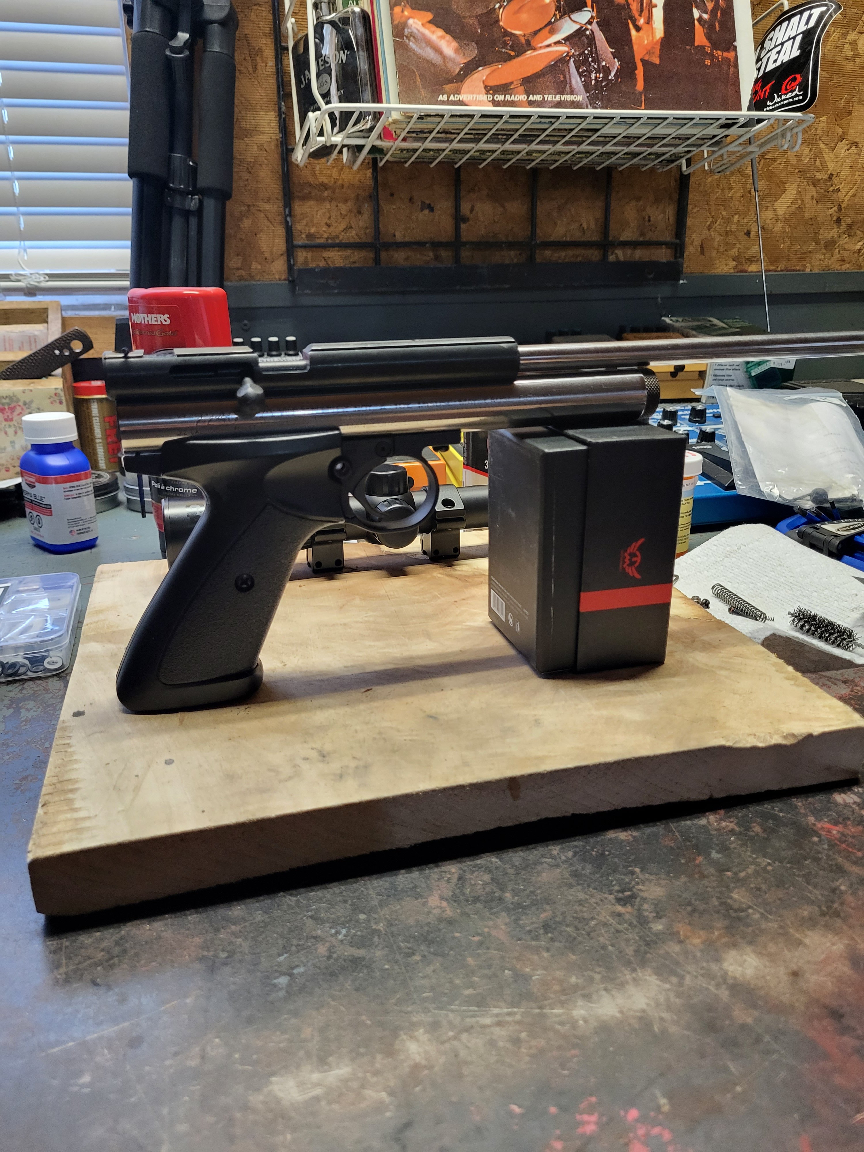

Looks really nice! Not sure what you did to polish it, but I like the darker steel hue compared to how bright it gets when polished.... reminds me of brushed steel.

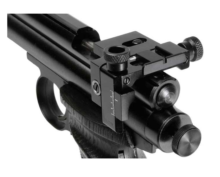

Not sure if you got sights picked out. But if irons, I would personally use a willims sight. (stock image of 2300s)
But if you want something less bulky then, maybe this. LPA rear sight
I love the Williams but I seen some people say you need to replace the bolt hand to cleat it. Is thus true?
Hm, that is a good observation. It looks like you could use the factory one, but it might be a bit awkward. I can see how an extended bolt would likely be a better choice.
I also updated the link for the other one since it didn't want to load. Not sure why?
