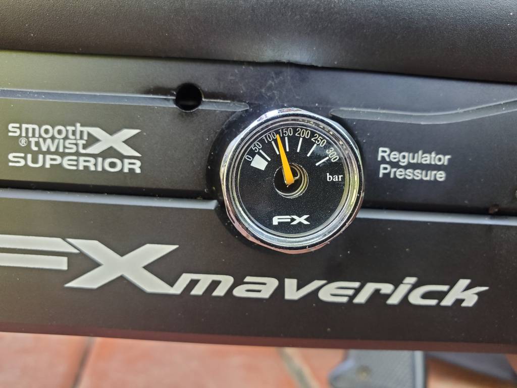

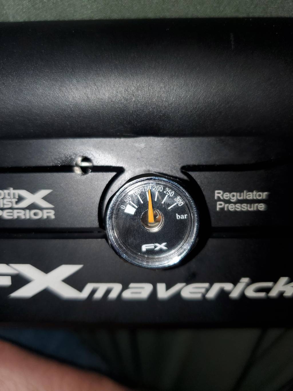

So just to be clear.... You have your hammer adjustment turned in completely so the head of the screw is sitting up against the body of the spring retainer? What are your first and second reg settings, if ya don't mind? Last night I set my first reg to like 160-170 or so and the rear to like 140. I also just requested the 11gram hammer from FX, but it sounds like I may not need it (will buy it anyway).
Small world Mr Doom. I have been playing since 1988 and not only that, but I am playing ICPL and ICC mech (which is all I have played for the last few years) for Wiseguys.
I do have my screw turned all the way up against the body of the retainer. I was in the exact spot you are now...although when I started I was at 150 on 1st reg and 120 on 2nd reg. Changing to the heavy hammer and nothing else, I was getting the same flipped velocities you are. I just started screwing that hammer spring screw down a half turn per shot and chrono and could watch the velocity on pw7 increase every turn til I finally hit bottom. After that, I replaced the FX gauges with Huma so I could figure out what my pressures really were....then bumped them up to 170 on 1st reg and 140 on 2nd reg. I put the slug probe in (after I finally got around to drillng the damn hole the right size) and was seeing the 24.8 NSA slug at 1050 on pw7. I am pretty sure that going up in pressure would help with the tune and allow a smoother spread across the power wheel. I get small decreases of about 10 fps from pw7 down to about pw4 then it kind of drops about 40 fps per click down from there.

Holy hell, bois! I have the Maverick .22 tuned PERFECTLY now.
Settings:
High reg: 160bar
Low reg: 120 bar
Slug power kit installed, 13 gram hammer, power wheel at 6, hammer adjustment all the way IN
979-986 FPS across 20 shots

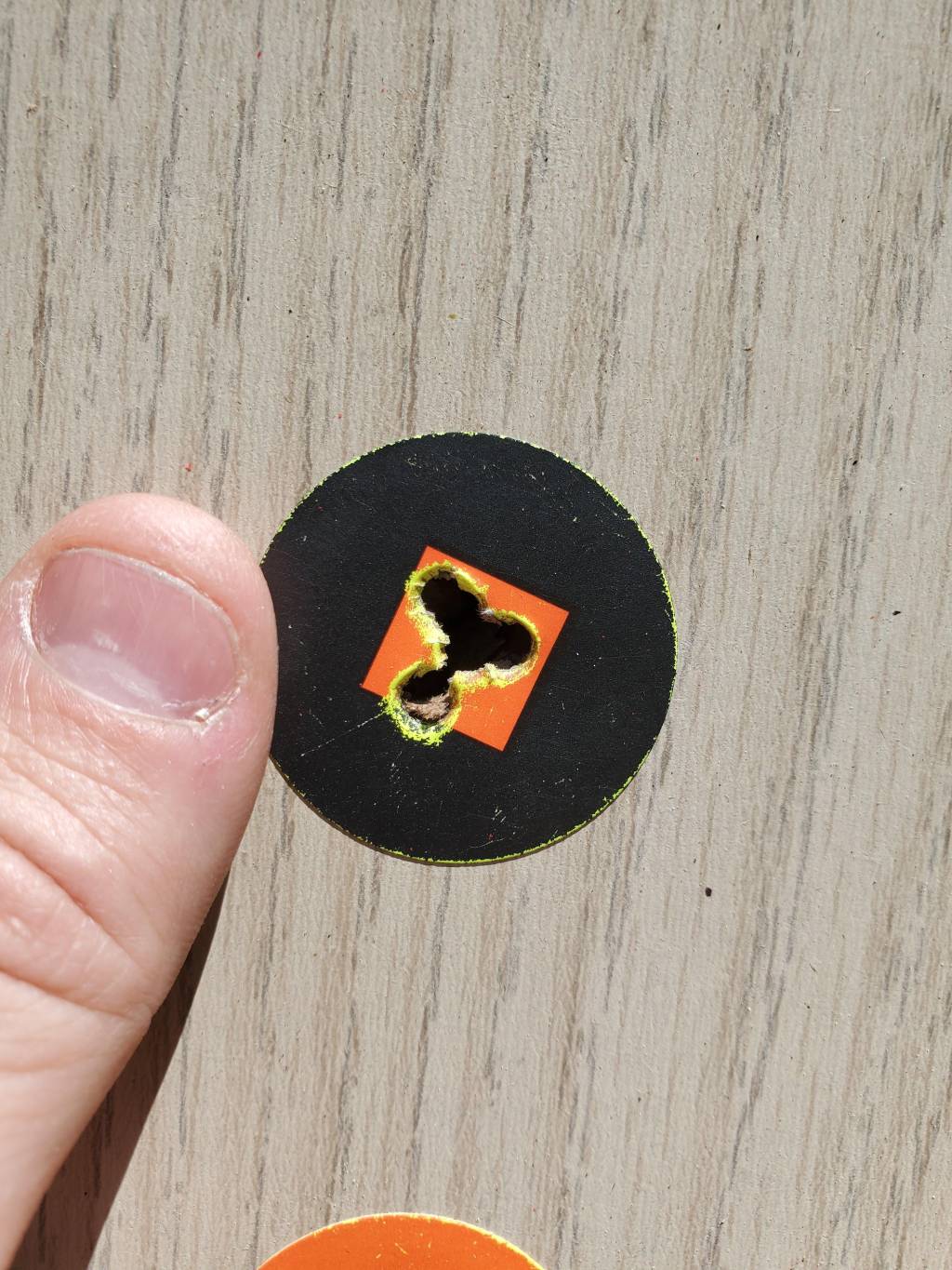

5 shots w/25gr NSA slugs @50 yards!!
