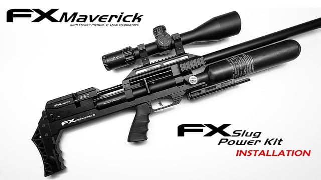

Watched the reassembly...when putting on the wheel how does one know when it is indexed to the actual start of 1, 2, etc.
The position of removal vs installation doesnt matter, as the setting is machined into the back side of the wheel itself. Just make sure the ball/detent is lined up and you dont crossthread the allen screw. I can add that my new/used 500mm Wildcat came with the 13g/56mm spring (among other issues lol) and I had no control over the hammer/valve in 22 cal. Turning the hammer spring preload all the way max and all the way min produced the same high velocities. As noted above the heavier hammer weight also increases preload on the spring. So you can end up over-hammered if you mix and match the wrong parts. I put in a 52mm spring and now can control my speeds and pressure usage. It really depends on what reg pressure you intend to run. I settled on 125Bar, but the 500mm/22Cal vs say a 700mm/25Cal is going to want a different setting in both reg pressure and overall hammer strength.

How much of a difference does the slug probe make ? The slug kit for .22 must be the 13g hammer. I guess I watched the wrong video on the power dial. But it makes sense since its stepped. I'm mostly shooting heavy pellets and must have the 7g installed, seems way light. Might just try the 13g hammer without the probe first.
