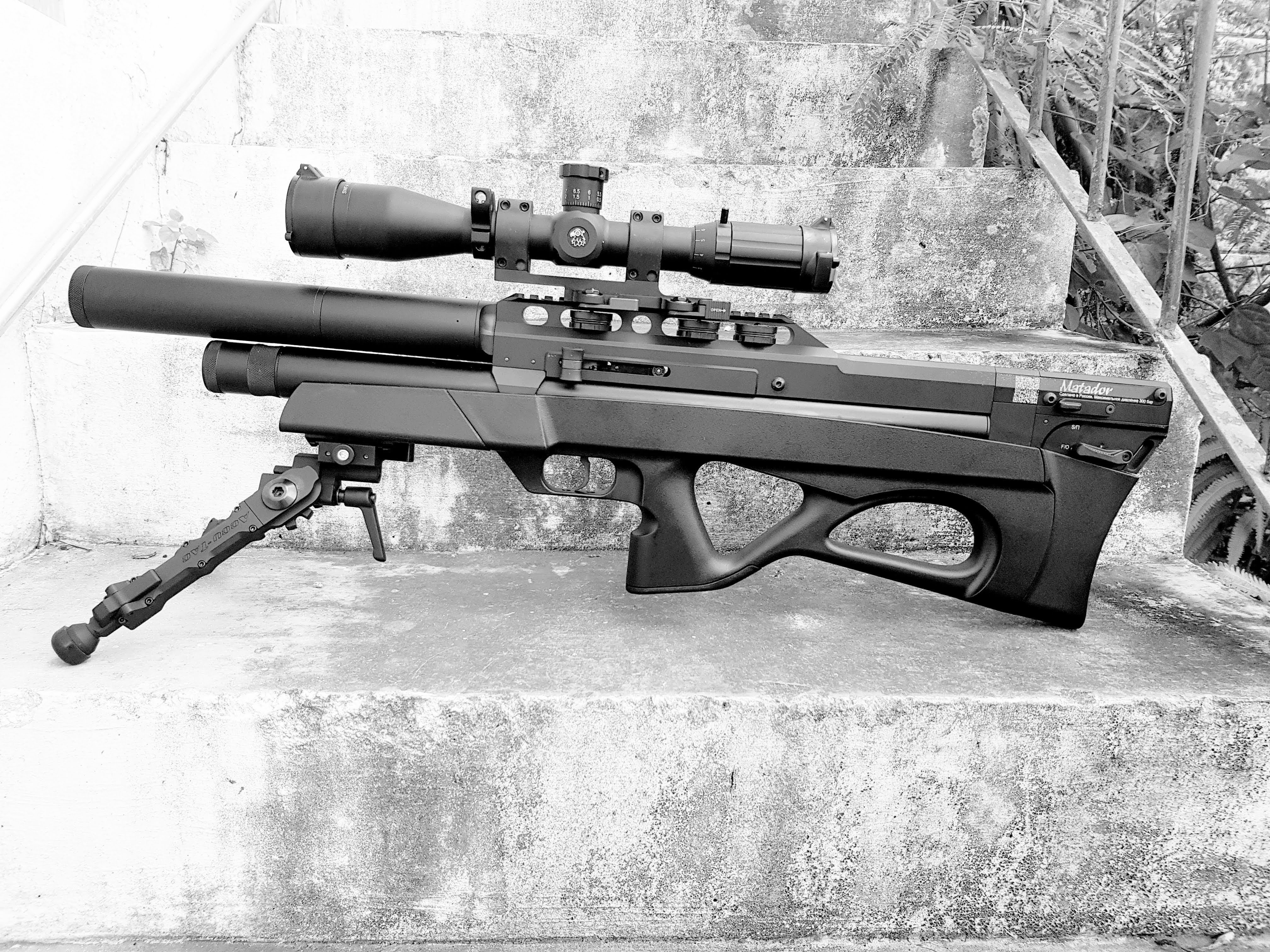

Finally pulled the trigger (oof bad pun) on a .25 Matador R5M. Paired with Helix 4-16x44 scope. Never fired anything like this and other than it being a bit loud at my ear absolutely love it! Thanks Brian and Edgun West. Very helpful with purchase and setup.
@damageINC Congrats on your new acquisition. I really like the R5M platform. If it’s loud to you, you may want to consider swapping out your stock moderator for an Edgun BAT moderator.
Thanks. It actually has a Bat on it. The action near my ear is where the noise is coming from. The business end is actually pretty silent. Just a chuff sound.
