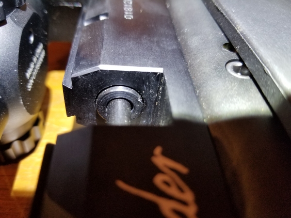

Possibly JWRabbit123 is on to something with the wobble. I did notice that the bolt goes into the barrel slightly high, which may be seating the pellet out of center. When I first got the gun, it was blowing the seal out the bottom below the bolt until I put a new seal in. It seals fine now.
Please see the attached picture and let me know if you think it is off center enough to cause an issue with wobble.
Wobbling pellets can definitely cause accuracy problems but once again how are you getting pellets to wobble consistently at the same rate through many shot strings. That would mean at the start of every string your pellet is either wobbling or not wobbling. Then as you shoot it progressively gets worse or better. Not likely. Looking at your picture, if the front of your probe has nice rounded edges, it being a couple thousandths high is not causing your problem. An issue like you are having is more easy to solve with something that gets hotter or colder as you shoot. A rifle that does what yours is doing is heat related. Every shot the barrel gets hotter, expands more, and if it is making contact with an imperfection on the left side of the barrel channel it will keep pushing your shots further and further to the right. With a PCP airgun, the only thing that changes is air pressure. You start at 3050 and shoot down to 2200 consistently. As your tube goes through that pressure drop, your groups are swinging, consistently. I would pull the gun completely apart and reassemble it making sure everything is tight including whatever Crosman uses to hold the valve in place. Pay particular attention to how the breech block is screwed to the air tube. If you are reluctant to tear your gun down, you should probably throw on another scope, takes 15 minutes. Then try another pellet. Do the easy stuff first.
