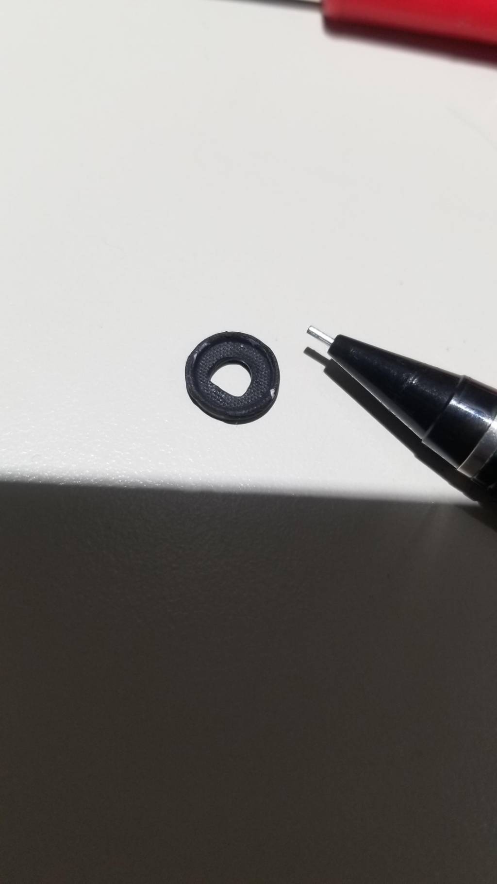

Try as I might, I have been unable to find my answer through searching. I got a new Marauder pistol, and the gauge has parallel threads which apparently is the new and improved design. Well, mine has leaked since the first day i got it (500-700) psi overnight. The first thing I looked at was the gauge. Sure enough it was hardly finger tight after being degassed. I tightened it up, hoping that would fix the issue, and had a similar result the next morning. Tried all the usual fixes and had no luck. Ordered some 009 o-rings, and that has not fixed the issue either. My question is, does anyone know what the o-ring like material is that came from the factory? It does not appear to be an o-ring, but some type of gasket material perhaps? Any suggestions on fixing the leak are also appreciated. Has anyone had any luck with gasket material and a punch set to make a semi-custom remedy?

I've confirmed with the soapy water test. Its leaking from the gauge for sure. I have not tested other places yet. Trying to fix one thing at a time i guess. I'd rather tinker with it myself than go through the hassle of sending it back for now. I've also contacted the retailer to see if they have any suggestions on what that seal / gasket part is.
That’s an X ring that the factory used. Re install it and put an o ring with the same outside diameter as that x ring and 1/16” thick on top of the x ring and that should seal it.
it’s common practice to place one o ring on top of an x ring to help orient the gage to how you want to view it and also by doing so it adds thickness to the seal as you thread the gage back on
