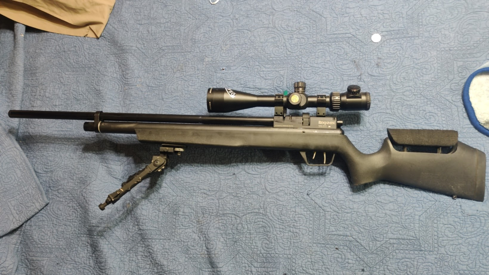

I’m new to the to the forum and PCP airguns. I purchased a 22 cal. Marauder L/W because my wife’s pit bull is deathly afraid of gunfire and she wants me to thin out the starlings at her bird feeders.
I have a ultimate 10/22 I built, so I like to tinker.
So far I’m pretty happy with the accuracy, shot report is very quiet (I can shoot with the pit bull sitting next to me).
So I would like to tinker with my Marauder, I don’t do gimmick modifications to any of my firearms.
I would like advice on truly beneficial modifications to increase accuracy, shot counts, velocity is at the bottom of the list.
I’m not afraid of buying quality parts, I have an embarrassing investment in my 10/22.
Thanks

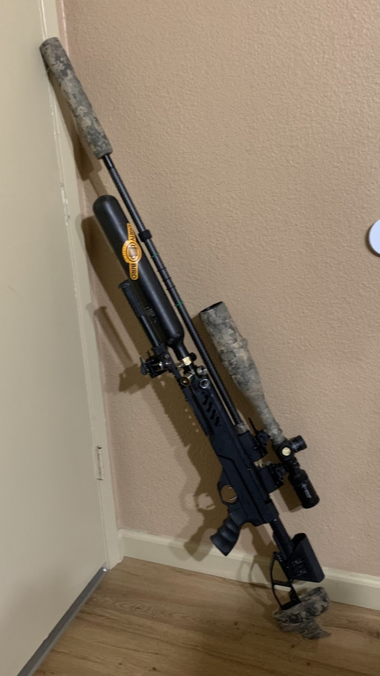

Welcome to the airgun world. This sport is a beautiful thing. You can go over to JSAR (Jefferson State Air Rifles) and look at the valves, lightweight air tubes, hammer mods and springs. I've had my non-reg'd Marauder since 2019 and only ever turned the HS up. Once I got bit by that bug, I went and bought a Dreamline after that. You'll see. Lol.

The aluminum tube was one I was looking at doing. Anyone have a lead on one???
I was thinking about regulating it, I didn’t get the F/T model because it didn’t appear that the regulator was adjustable.

From a guy with a Marauder with all the goodies, some basic advice. Yes, regulate, Yes, JSB, Yes do porting on the bore to valve pathway to improve airflow.
After porting (but before you install regulator) shoot a shot string and monitor the velocity, at some point you will hit a knee where velocity starts to notably drop off, look at your gauge and record what pressure that was at. When you install your regulator, set it for 100 PSI higher than where the knee was. This will also make it even quieter and more efficient (use less air per shot, less wasted air and noise per shot). With this configuration a lighter hammer works better, along with a better hammer spring arrangement.

Hay H, welcom to the addiction. Marauders are great guns. The three I've had were accurate right out of the box. Minute of starling at 60-70 yards with me shooting. 15to 20 yards further with my buddy shooting. I bought a bunch of after market produts for mine before I realized I didn't have the mechanical ability to install them. My remaining Marauder is still factory stock. The parts I bought- Huma reg, .25 cal. JSAR valve, hammer, and springs. Aluminum tank extension. Boyd stock. If you want me to, I'll see if I can find the tank extension and come up with a price.
