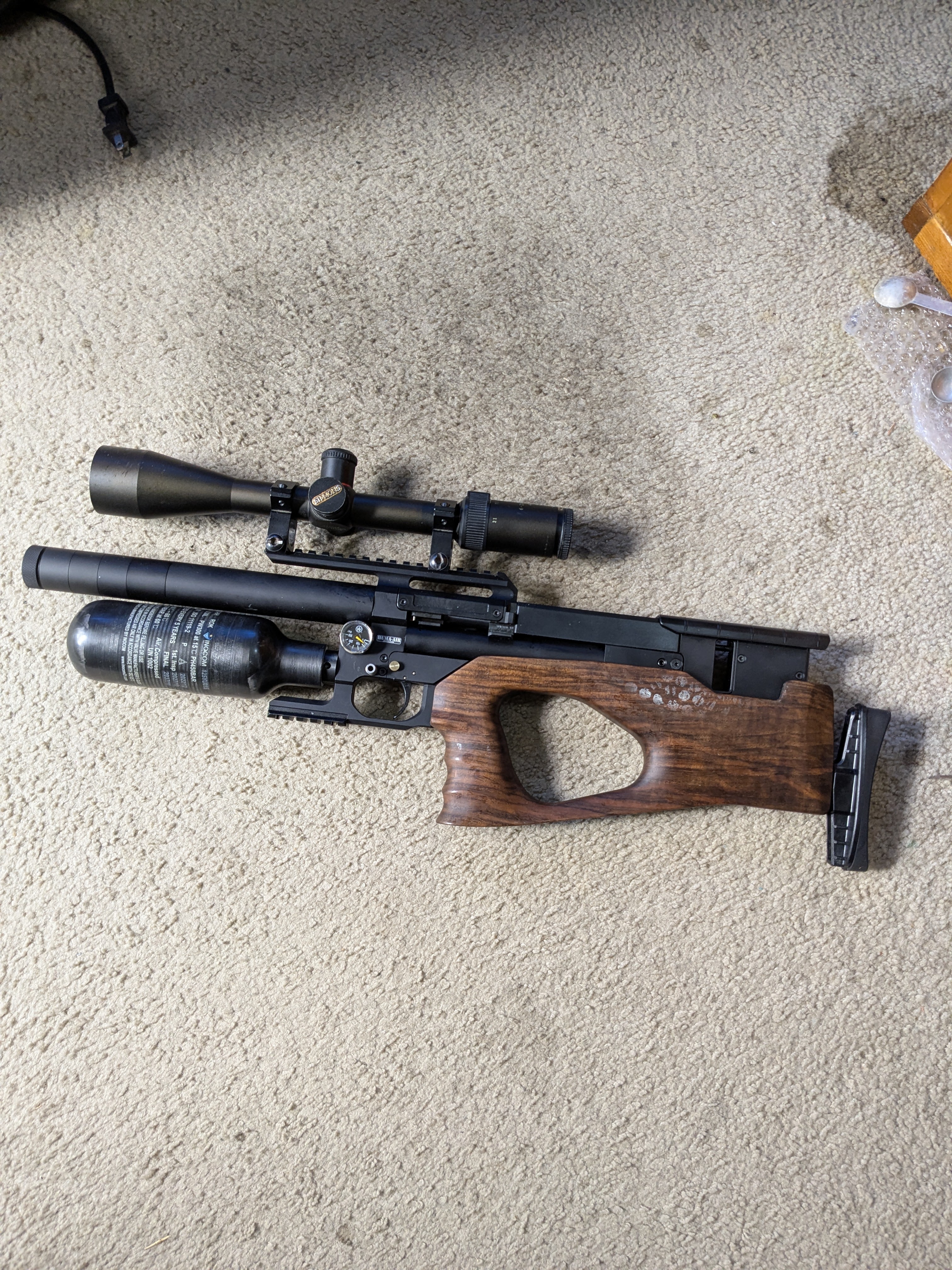

AirMaks Arms New Krait lite standard bottle .177 it started leaking while shooting
Yep leaking air just above the trigger I hit it with soapy water and nothing just air leaking lol.

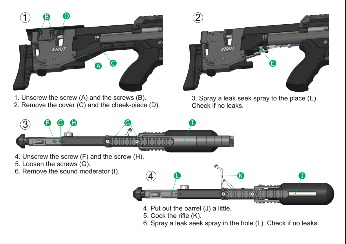

I guess it's more of a problem as they posted this check on their website...
I have the exact same gun with a laminate stock - it's my goto truck/backyard gun. I had the same problem and replaced the o-rings and that fixed it for me. And it is a bear to work on. Once I figured out how to correctly tune it, it has been a relaible performer and I get a ton of shots with H&N Baracuda Extremes 9.57g.
Thanks guess a trip to the Web site would be a good idea!
