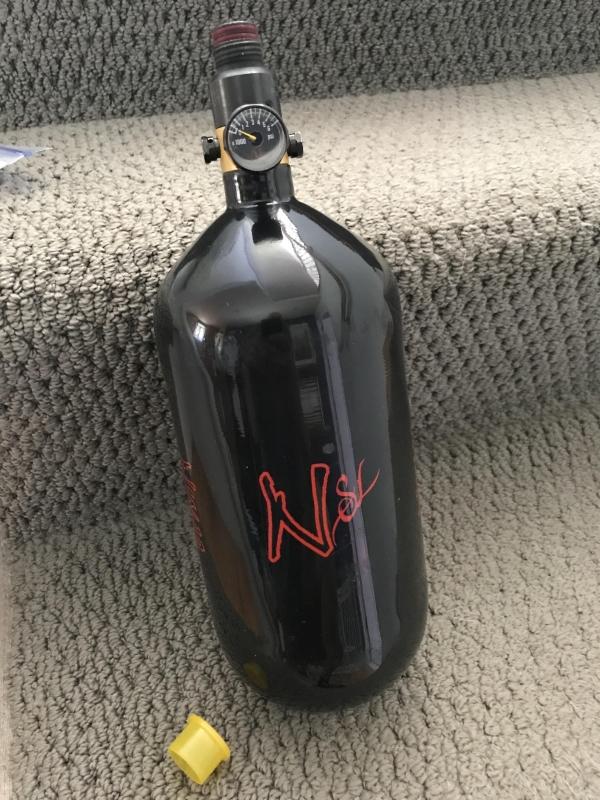

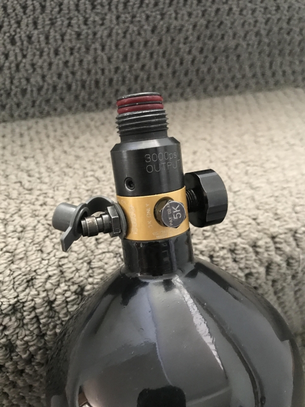

ive put a link to a picture, I’m on my iPad and can’t get the picture to display correctly. Just received an air tank and I’m not entirely sure what else I need now. I bought this:
https://www.pyramydair.com/s/a/Air_Venturi_Foster_Quick_Detach_Hose_Assembly_1_8_BSPP_Female_Threads/4955
and of course the fill probe that came with my bsa as well as the adapter that is currently connected to my hand pump. The air tank assembly has the foster fitting that I’m assuming is what I’ll connect my compressor quick connect to, but what screws into the top? Sorry for all these basic questions, the hand pump was easy to understand.

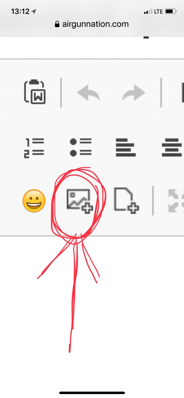

Click on this symbol and it should let you upload pics
