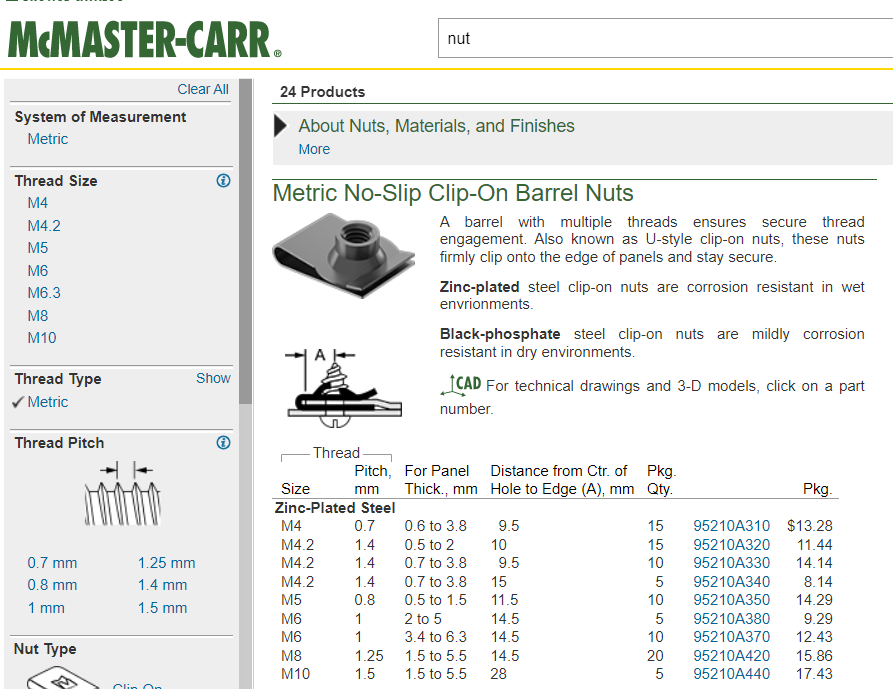

Is there room for a clip on nut. McMaster Carr has them
I had the same thing happen. I was able to run a tap thru and straighten the threads. It looks like there is room for a nut to be used on the inside if all else fails. Anyone know if the fork could be replaced?
