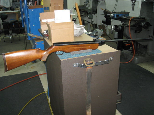

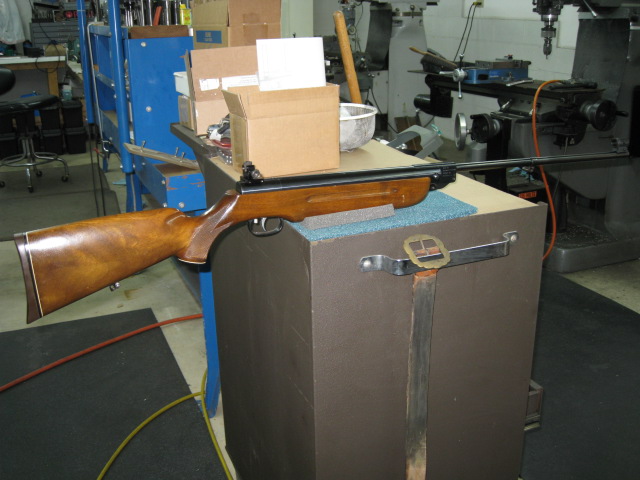

I have two HW35's and EB that was my first air gun From 1977. Since it is an EB it came from Beeman and at that time Mr. Beeman was hand selecting every gun he was going to import. The stock finish is way above the other gun, and also has a 16" bbl as opposed to my HW35E which has a 19" barrel.
The 35E was found in a surplus store and I paid $60 for it . It had sat is somebodies closet for years and got pink house paint dripped on the wood so I refinished it. It is noticeably easier to cock than my earlier gun with the 16" bbl.
I use these guns as my Iron Sight Practice Guns. I can also mount a "Bug Buster" Scope on the 35E and it is a one hole gun at 10 yards.

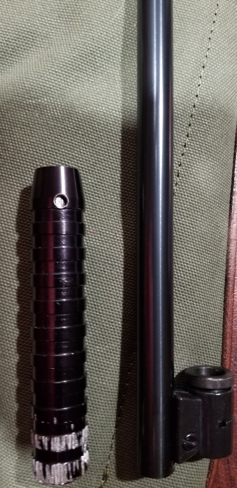

What the business end of a HW35E should look like IMO. Re-installed F&R sights so gun is back to original except for F swivel that I left off. Many thanks to Brian at Veradium Air. The MB was actually pressed on. You can see what it took to take off, he actually had to make a tool. And then had to cut the inner sleeve to get it off. As I suspected the MB was causing clipping, which was why I wanted it removed. Going to melt it down and make a target out of it and shoot it over and over again. Looking forward to it.

Perfect. No damage to the bluing. Good job.
Good Job (y)!
-> Reminds me of taking off the awful LDC from my RAW HM 1000x.
I never liked those Weihrauch/Beeman ribbed muzzle brakes -> IMO, they're too busy and take away from the gun's classic lines.
Yeah, they're funky but they did sort of get the ball rolling. I have a few but prefer the brakes I made.
I call them Beeman Buck Rogers brakes. They would look great on the end of a fazer.
Good Job (y)!
Edges on it were so sharp I feared I’d cut myself. Glad it’s gone. I have a HW moderator I slipped on it. That was REALLY fugly. Couldn’t take it off fast enough LOL. Going to stay the way it came.
