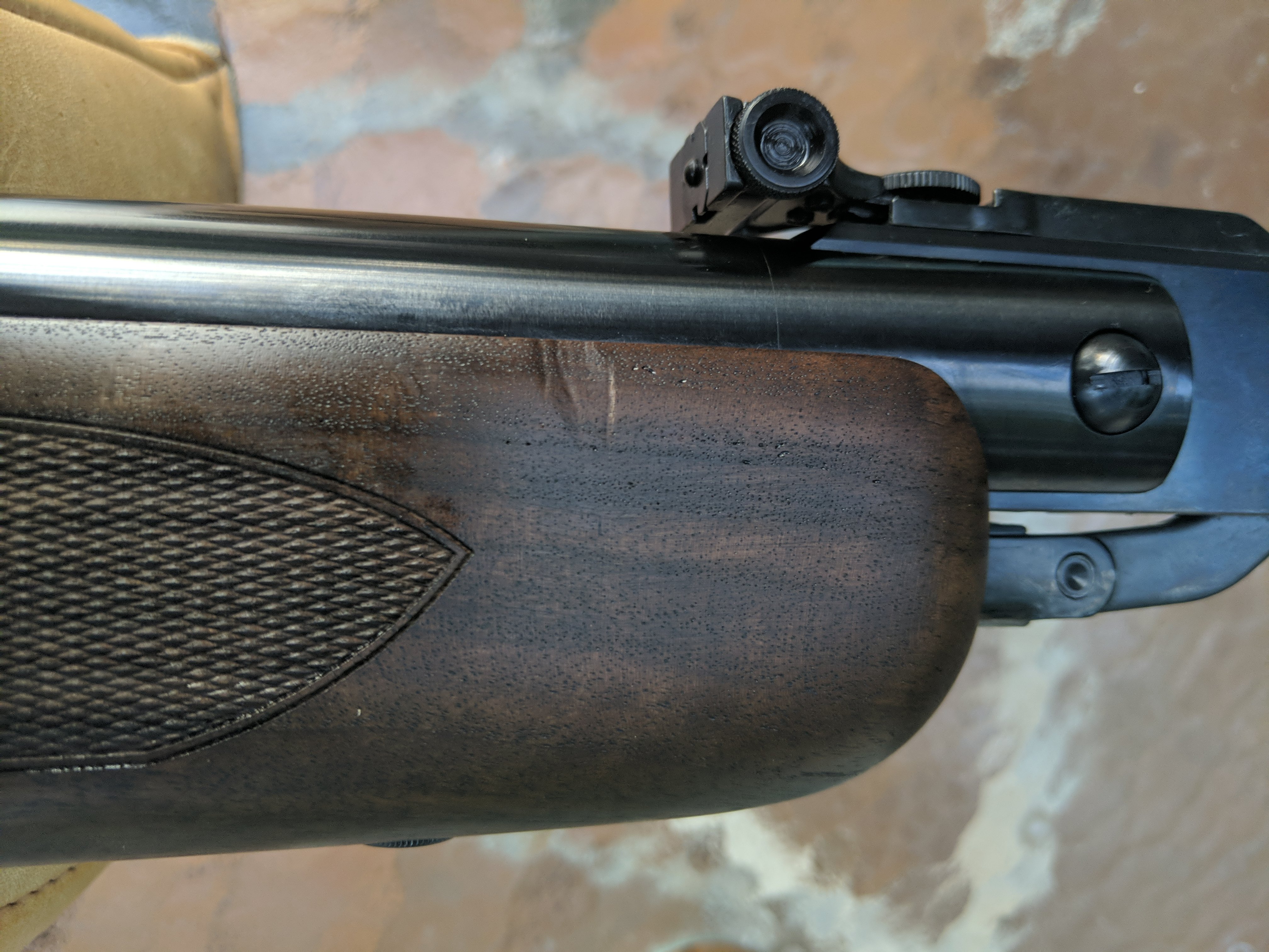

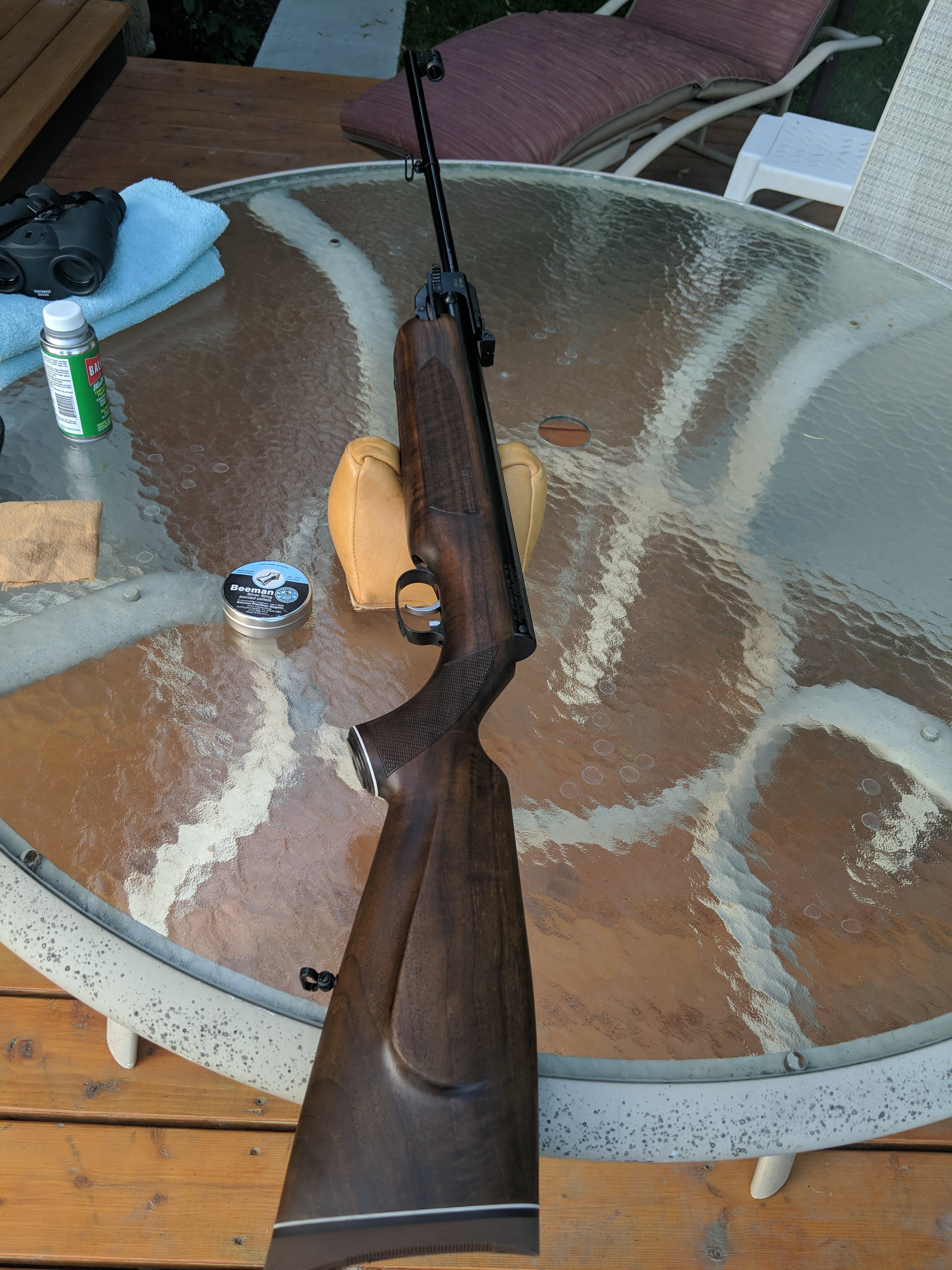

I am a total rookie with these springers. So please let me know your opinions on my initial review.
I received a .177 caliber HW35E from Krale today. Amazing to receive a package from them in only 4 days, wow. But the packaging was really poor. The Weihrauch factory box was in an outer box with minimal bubble wrap protecting the inner box. The outer box had several good dents in it. I am surprised the gun got here in one piece.
Considering the damage to the box the gun only has a small but ugly dent in the forearm of the stock. I might try to steam it out. I am not sure if steaming will work on an oil finish?? The wife says it's the distressed look. People pay extra for that now days! LOL.
I removed the stock to look at the spring. Minimal grease on spring which is good I think. I added some moly to the cocking rail. It was a bit rough while cocking but the moly smoothed it out pretty well. I can see some burrs that need my attention.
The trigger is not working correctly. I tried to adjust it lighter by one turn, but the first stage then became loose like a tension spring is not working to return the blade. It just flops without tension. I put the adjustment screw back to where it was but while shooting, the trigger blade occasionally will become loose again. I have to move the blade back and forth and then the spring tension on the first stage starts working... Not sure what to do about that. Th second stage is working to fire the gun but seems heavy. Any thoughts on this?
The barrel release latch is really gritty to operate. I see the small spring that is inside the spring hole, that the latch's pin engages, is cocked sideways a bit and that seems to be causing the gritty feel. I pushed a little moly into the hole to lube the spring and it does seem to help smooth out the operation of the lever. The lever has a poor machine marks on it as well. So it may need to remove the lever and do some honing to smooth out the feel.
The rear end cap needs to be adjusted slightly. The dovetail rail is not lined up well. It is pretty noticeable and will drive me crazy until I fix it.
The gun is shooting very well so far. I only have some old Beeman Silver Sting's but pretty good groups so far with open sights.
Some spring twang but not bad and after 40 shots or so it seems to be diminishing. Compared to my HW50 the gun is pretty smooth and enjoyable to shoot. The 50 is a problem child!
Here are some pictures

You got some fabulous figure in that Walnut. That little ding will lift right out with steam. If you need some advice with it just message me. Owned a furniture business for 42 years and made repairs daily. The gun sounds like it’s just tight. That’s a good thing. Just shoot it. It will all mesh together. The trigger needs adjustment but again just shoot the gun. Make the fine adjustments after a tin of pellets.
Thanks Bear,
I will see how it goes today with a little steam. I have a nice big soldering iron and was going to put a wet cotton cloth over the dent and heat it up with the iron. How would you attempt to steam it?
The good thing is it is just a dent, not a scratch or gouge.
Thanks Bear,
Keep a 3 or 4 inch piece of t- shirt rag quite wet and do not let it get dry. Fold it multiple 6-8 times and apply the soldering iron in a spot for a few moments. As you hear the steam drying out of the rag, stop. Just be patient. It takes time. You can’t fix a burn. Work it over and over until it is lifted. The wood fibers take time to absorb the moisture. It will entirely lift over time. Patience is key. Lift a spot a little and work another. Keep it even. Then start at the beginning again. Keep working the area evenly. Bring it up together as a whole. Little by little.
Good advice sir, thank you!

That's a gorgeous stock. If it were me, I'd contact Krale and ask for some compensation for the damage. Then I'd do as BoG suggested and keep that beautiful piece of walnut! The trigger issue would bother me more than anything else. Did you test the pull before you started to adjust? Possible yours came with the screw already back out some. Makes me wonder if it was a demo or something. Beautiful gun though, I'd keep it and get it straight.
Nice stock. Even with the dent. Get some compensation and then try to steam it. You should be able to get most of it out. Just go easy on the heat. Probably less likely to happen on a oiled walnut stock but I've discolored the finish on my original Hw95 beech stock. Nice looking stock with or without the dent regardless.
Congrats on the new gun

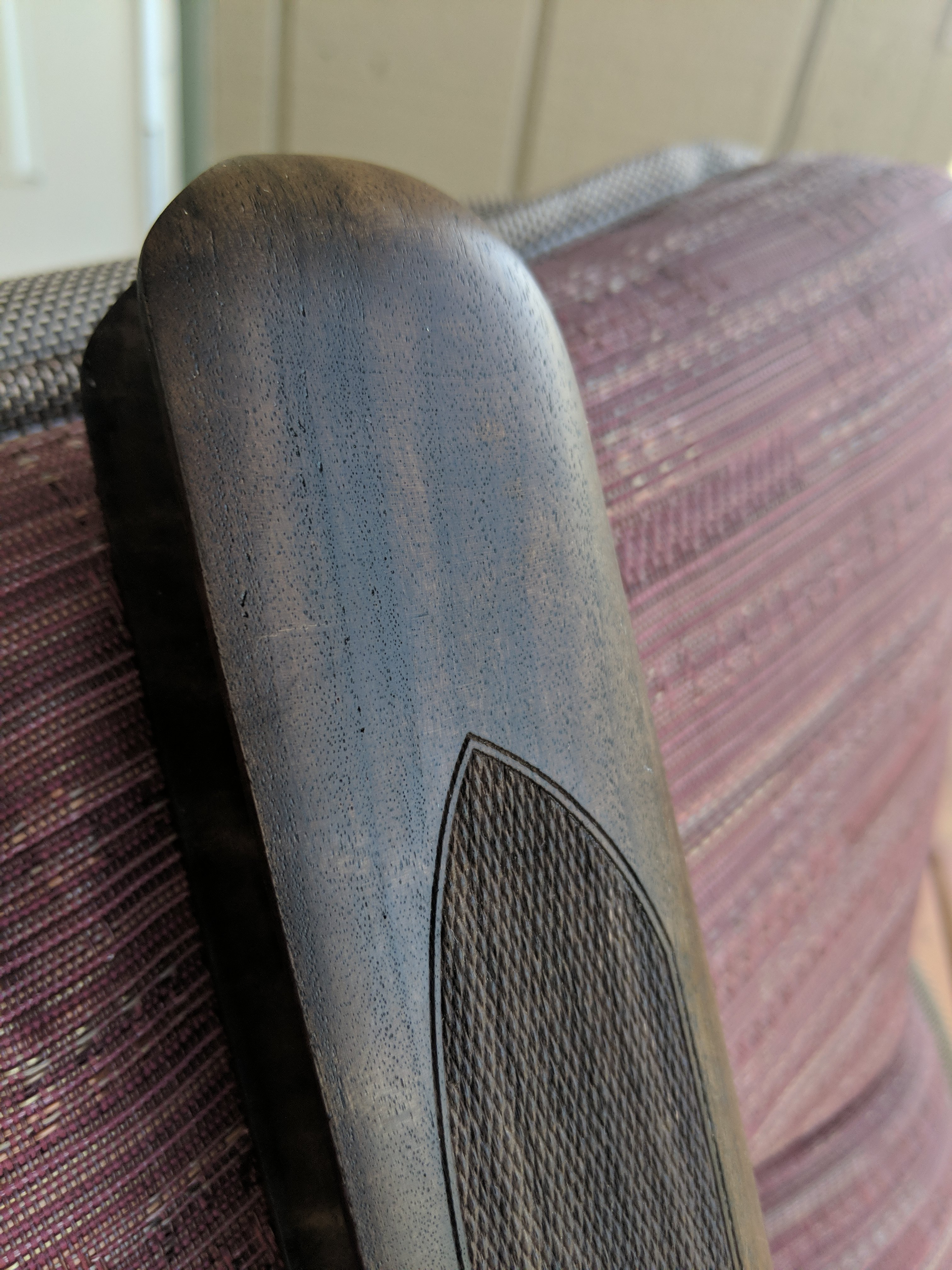

Here is the dent after steaming. Looks pretty darn good I think. Just a hint of a line still showing. Kudo's to Bear of Grayling for the great advice on steaming.

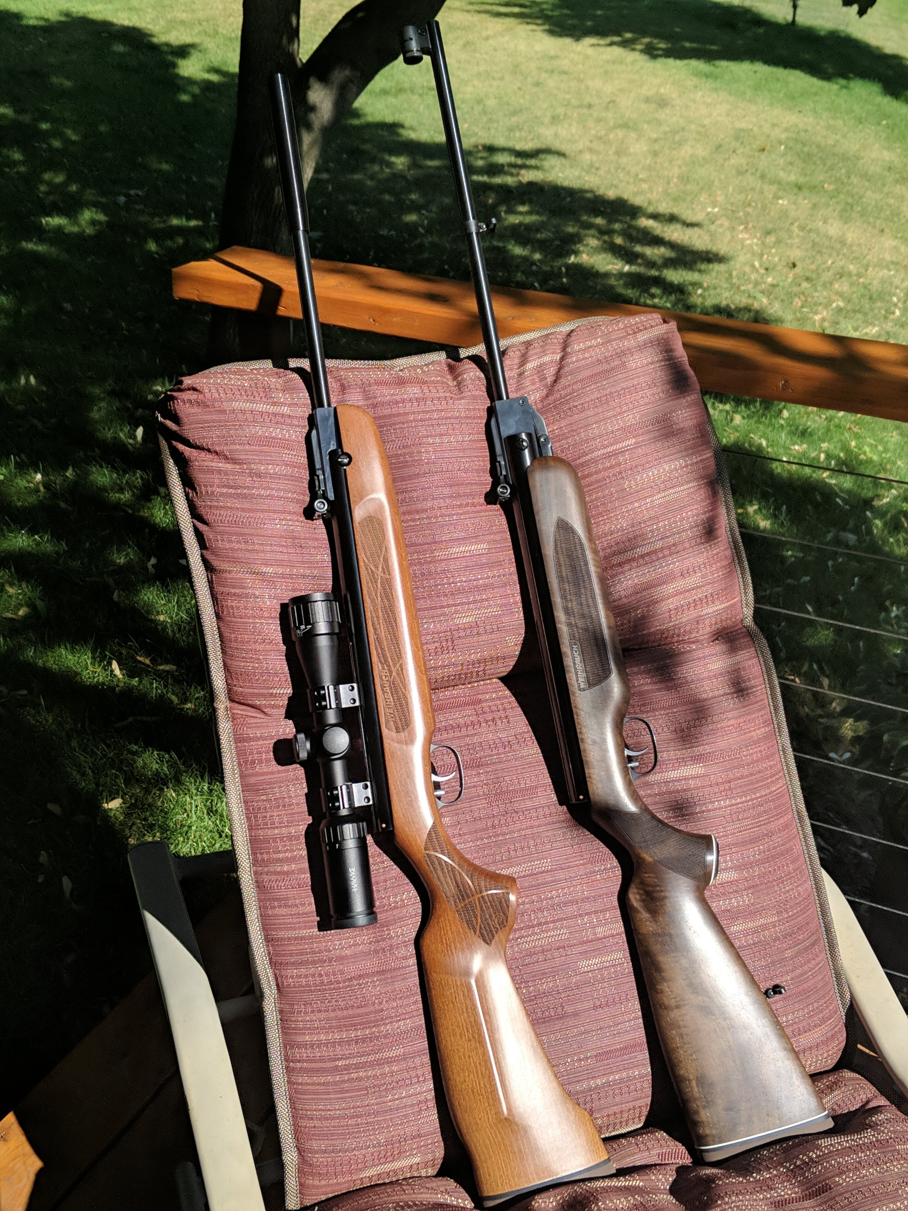

Zut
