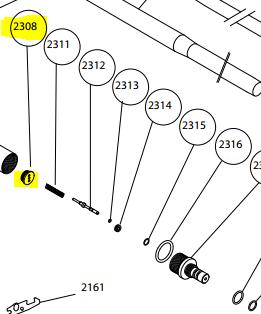

One thing I notice during installation of my Huma reg is the screw-on piece that holds the valve spring is a bit wide. Which means in order for the reg to get a proper fit it will need to seat almost perfectly. I'm half tempted to file down the outside diameter of "part #2308" that way there is no obstruction and the o-ring sits where its intended on the base of the valve.

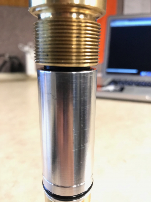

Yup, bleed hole is facing up. Here are some pictures of what I'm talking about:
Now with some force I can push it past the ORING. Problem is if its not pushed exactly center it will sit sideways or even worse push the ORING out of place. Either I find a thinner ORING, or I do some sanding and reduce the diameter of the valve SPRING NUT. What it looks like is the regulator isn't getting a proper set onto the valve because of this nut.
