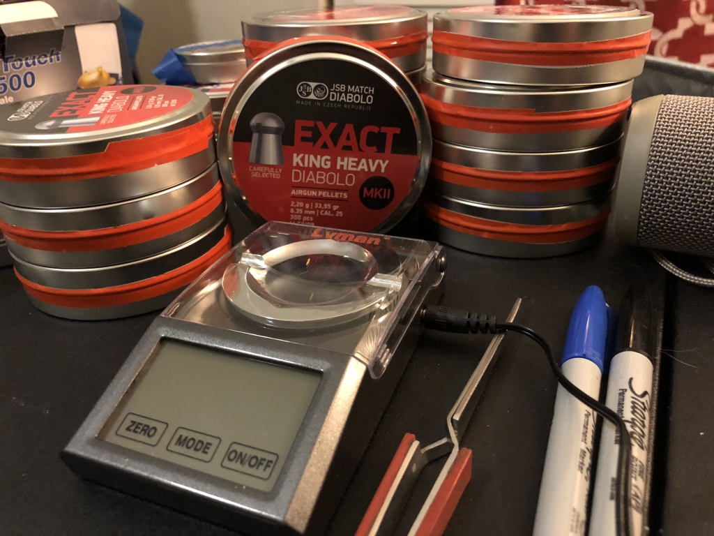

Weighing pellets is not going to drop the velocity spread from 35 fps to the teens. I never weigh pellets and the worse spread I see is with cheap Benjamin pellets that are terrible for consistency and still yield below 10 fps spread. At most weighing will help you far down range. Sorting for imperfections will make more of a difference but those are rare in good brands that have been handled well.
