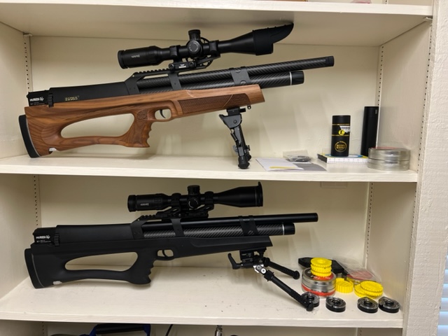

I have 2 myself 2021 LE in 25 cal. and just got my 2022 in .22 cal.
