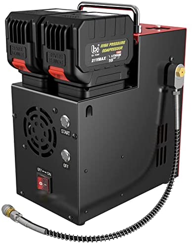

I've purchased a GX-E-L3 Compressor:
https://www.amazon.com/gp/product/B09FDCD3WT
Basically it's a new part of the GX lineup, similar to the GX-E-CS3, but Lithium battery powered.
Everything seems great out of the box, but it will take time for me to really see how well it works.
There is a simple instruction manual (1-2 pages), but no information on replacement parts and no vendor contact information at all - just the brand name "GX Pump" and looks like manufacturer "Intertek" on the batteries themselves.

Base company will sell this product in any configuration, color, name that the client wants. So there are several distributors that use the same base unit. You can probably find the base company from alibaba and source replacement parts from them. I think also this unit uses the makita 18 volt platform. So you can probably use a makita charger and battery if time comes you need replacement parts in that dept.

I've now done initial pressure tests - setting the pressure shutoff at 2000, 3000, 3500, 4000 psi, letting it pressurize, then bleeding if off, and also testing how it holds pressure, all seem to work fine.
Indeed, Makita batteries are interchangeable, which is nice!
The unit is nicely small & portable & seems solidly built.
Unfortunately this is my first HPA compressor, so I don't have any baseline to compare it with.
Question: will it typically damage these compressors if I were to run it all the way up to its max 4500 psi?
That depends on the compressor. It also depends on how long it stays running filling a tank above say 3800 psi. As it works it's hardest at high pressure. For example on a 300 cc tank it will not spend much time above 3800 to get to 4500 but on a 580 cc tank it will spend a lot more time between 3800 and 4500.
Remember not to restart the compressor with air pressure in the lines. Always bleed off pressure in lines first before restarting compressor. There is a one way valve at the air gun. So air should not leak out if you have the line connected
