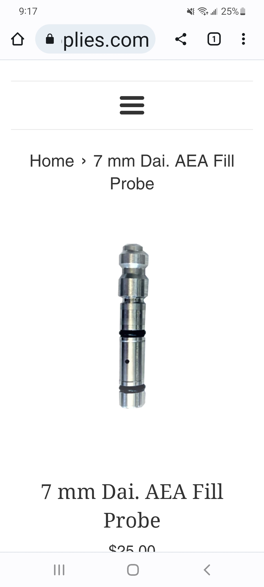

Thanks it does come with a fill probe

That filter is the same, or very similar, to my M50 gold one, I'll include copy of the Owner's Manual Cover, for reference. Fill probe looks like no need for adapter, already has male foster end. Silicone grease is a big plus for PCP owners, little dab on clean fingertips lightly smeared on those two "o" rings can help with sealing and smoother fit in gun. All seems complicated but you'll get used to it. I had to buy a few high-pressure hoses and adapters to get system going, imagine most have to. The items on shelf don't get removed, the stand, bucket, water pump/hoses and bottles all get put away after fill session is complete. Dump water in washing machine or on garden. Don't hesitate to ask questions, many here willing to help. This is a very welcoming place. WM
