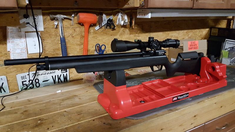

So.... finally got my replacement synthetic MRod .25 from Pyramid (the first one was leaking as much as 600 PSI overnight).
And have done some initial shooting.

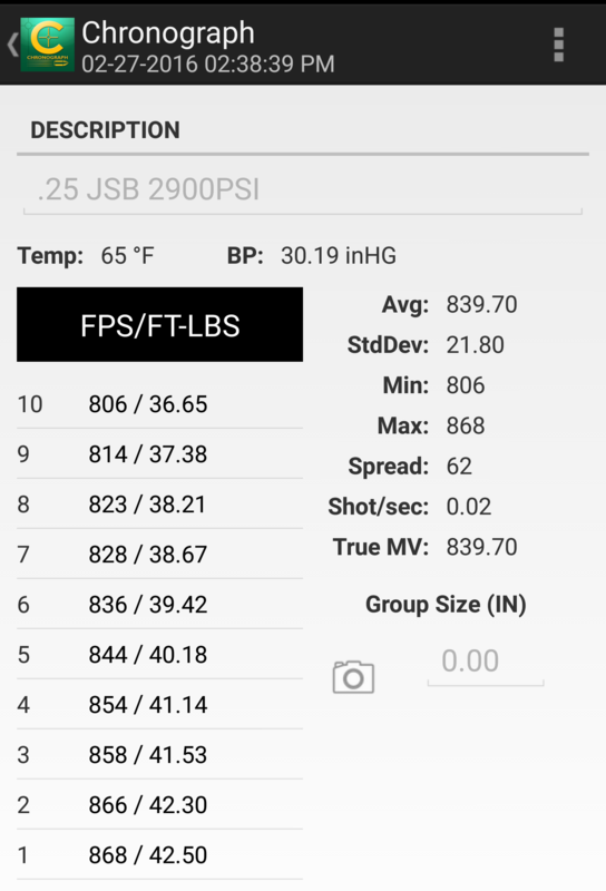

3500 psi isn't really a good idea. Besides the safety factor, it may or may not valve lock, but your shot bell curve will be shooting really weak till your spring and hammer over come the pressure against the valve and it gets to the top of the bell curve. Was 860fps the first or last shot you took?
TNHunter I can't help you much with your air tank filling problem but it appears you do not have a bell curve going for your fps. If the #1 and 868 fps is your first shot and your next shots continue to fall in fps it suggest you have filled your rifle at too high a pressure a starting pressure. Try filling your rifle to different starting pressures like 2600 or 2700 or 2800 psi and do a shot string of 16 shots. Then see if your fps curve starts lower and then rises and then falls back again. Record each fps and then try a different starting fill pressure and try another shot string. Then choose the starting fill level that gives you the best fps curve and velocity extreme spread. I see with the stock .25 cal. Mrod you can expect to get about 16 shots per fill. The airgun site that will really help you with the Mrod tuning is here

"AirgunBill"TNHunter I can't help you much with your air tank filling problem but it appears you do not have a bell curve going for your fps. If the #1 and 868 fps is your first shot and your next shots continue to fall in fps it suggest you have filled your rifle at too high a pressure a starting pressure. Try filling your rifle to different starting pressures like 2600 or 2700 or 2800 psi and do a shot string of 16 shots. Then see if your fps curve starts lower and then rises and then falls back again. Record each fps and then try a different starting fill pressure and try another shot string. Then choose the starting fill level that gives you the best fps curve and velocity extreme spread. I see with the stock .25 cal. Mrod you can expect to get about 16 shots per fill. The airgun site that will really help you with the Mrod tuning is here
http://www.marauderairrifle.com/forum/
Thats not correct. If the rifle was filled to high for what the HS pre load was set and the HT was set at then it would be partially valve locked causing very low initial shots and climbing to a peak and then back down. If he keeps the settings as they are for that string and lowers his fill pressure he will only cause the string to be worse and less shots. If you have a declining string you need to either increase the fill pressure or lower the hammers energy by adjusting the HS and or HT.
