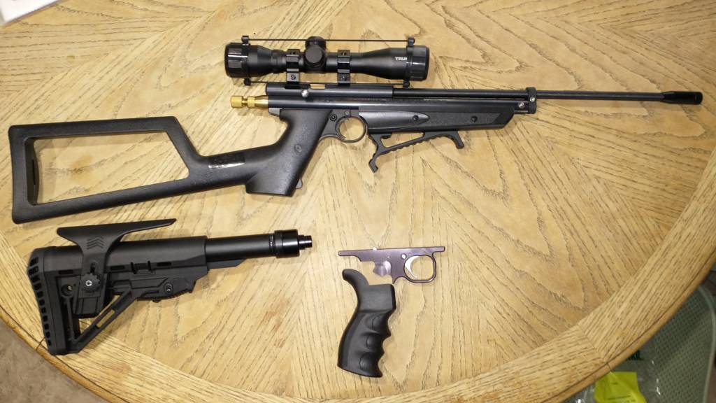

Here is mine so far, and a few upgrades that are coming... Magnum air power provided all my internal upgrades... Blue fork designs for the new trigger frame, and basic AR pistol grip... The AR stock adapter is from China, and mil spec AR stock is just a nice 6 position adjustable stock with adjustable cheek and tactical sling plugin... That what I had planned for this 1322, but now I'm thinking of getting a marauder pistol and putting the AR stuff on it in stead... Yep, addicting hobby...
