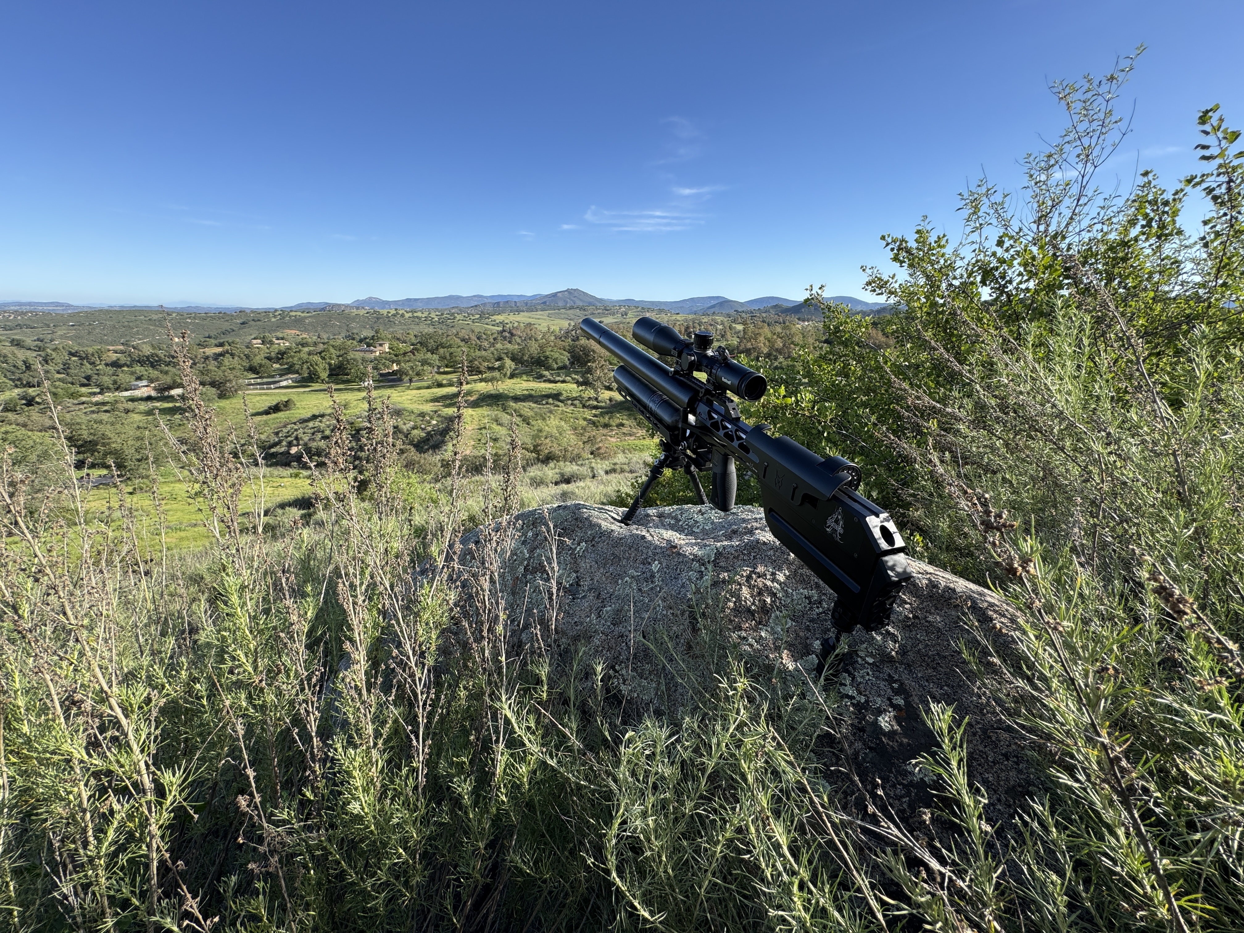

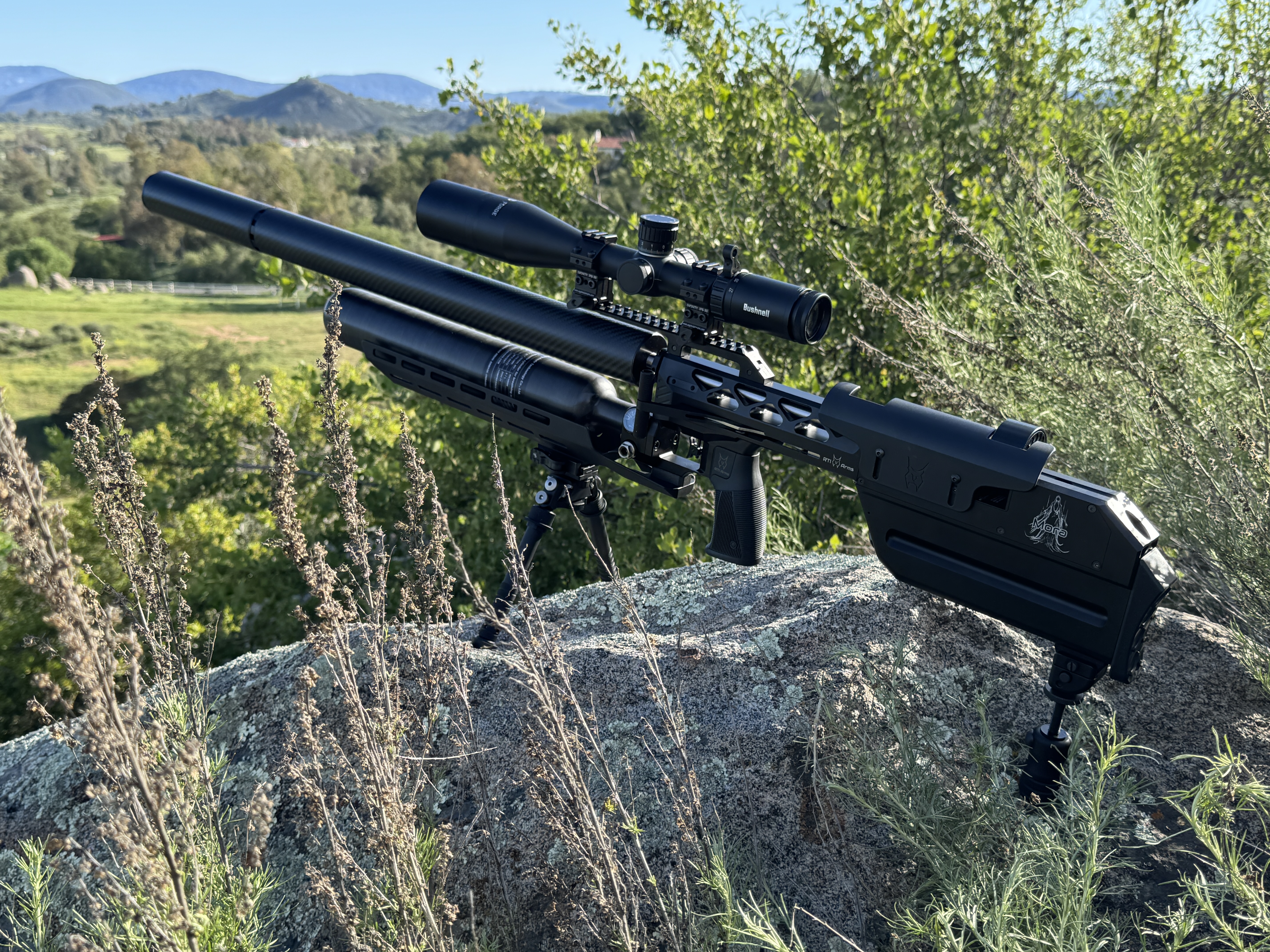

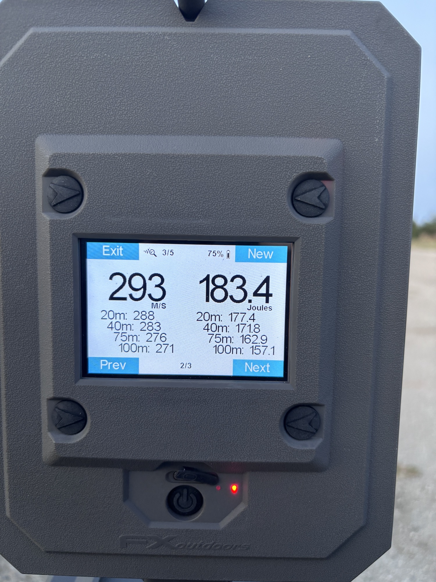

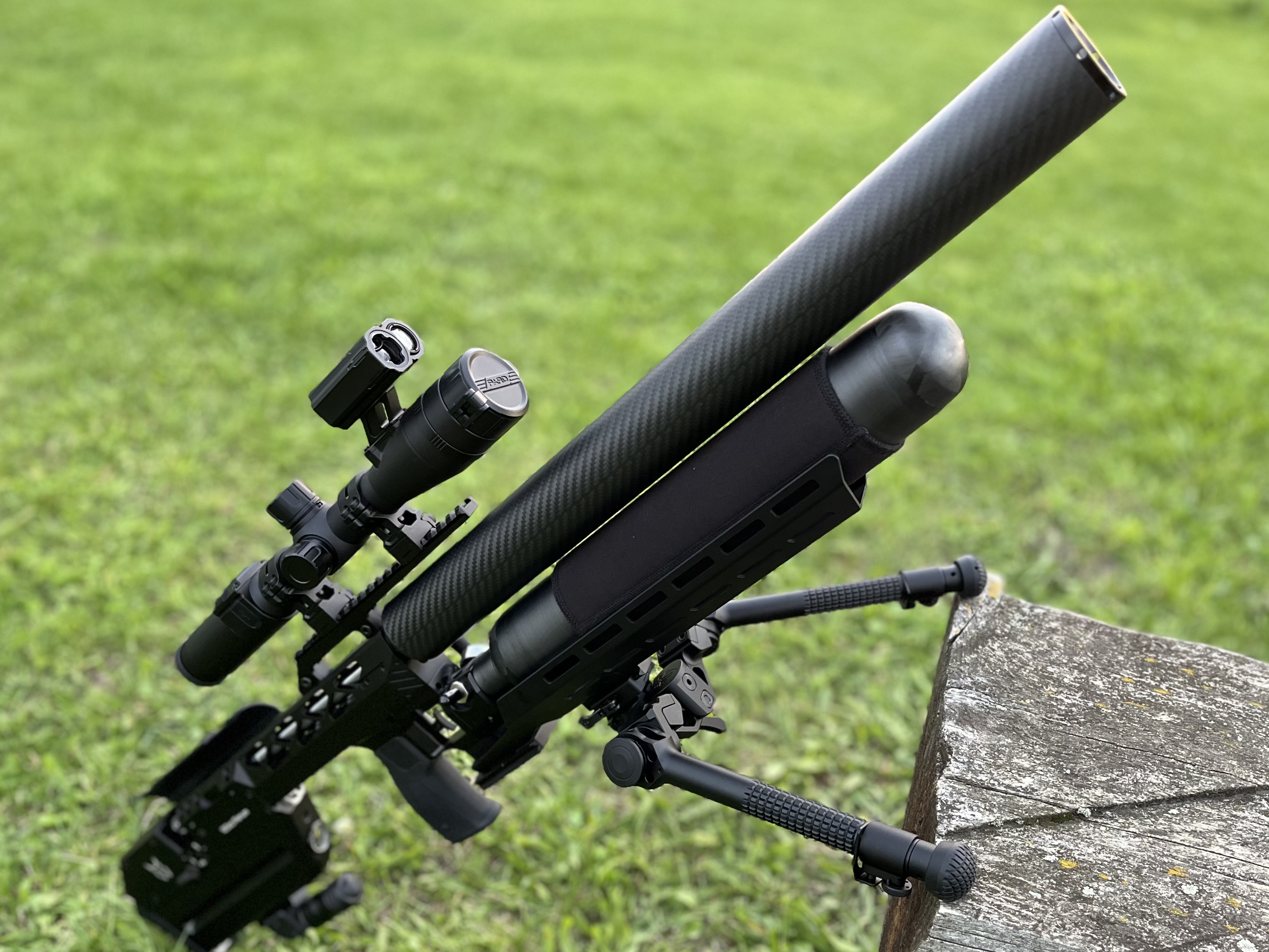

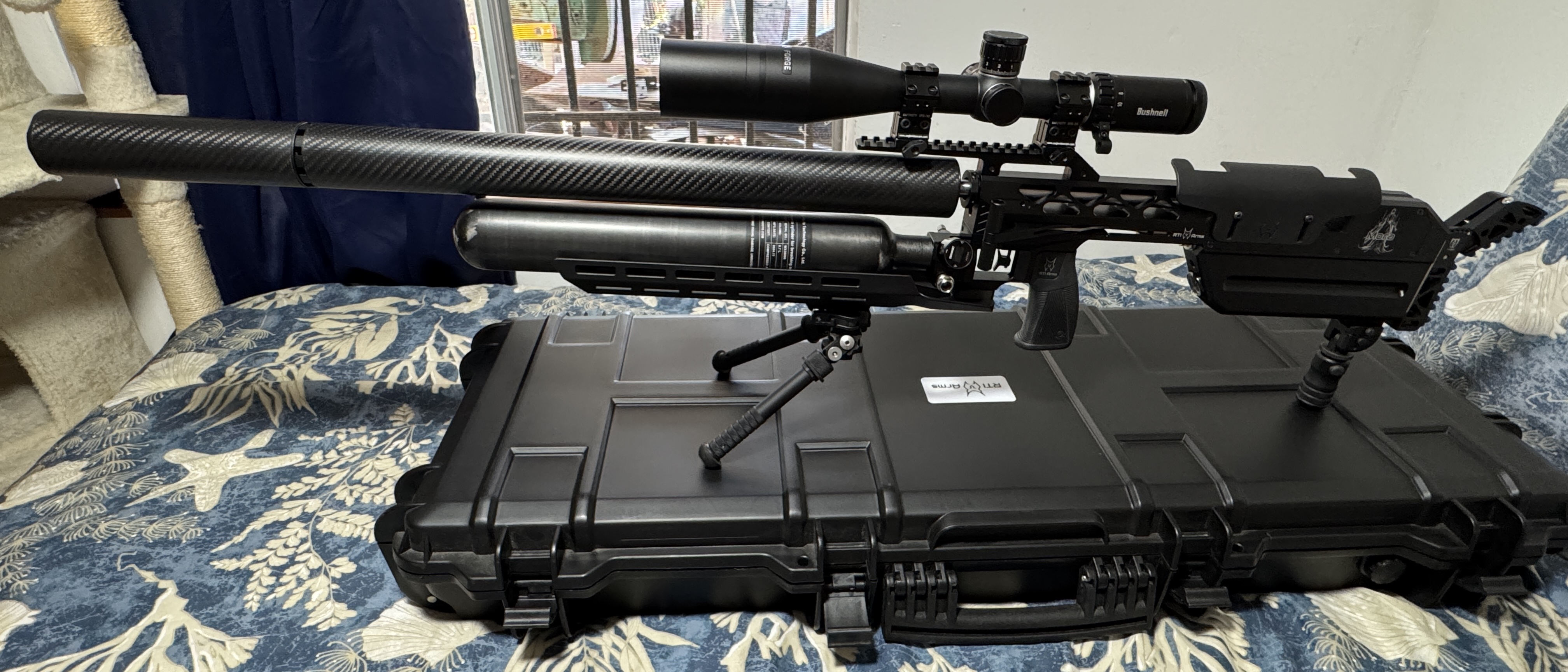

I got a .25 RTI Mora Sniper for my new hunting rig. It’s currently shooting 60 grain ALTAROS ATP Queen boat tail slugs at 920fps which is giving me 112fpe! With a lot more room to add more power.

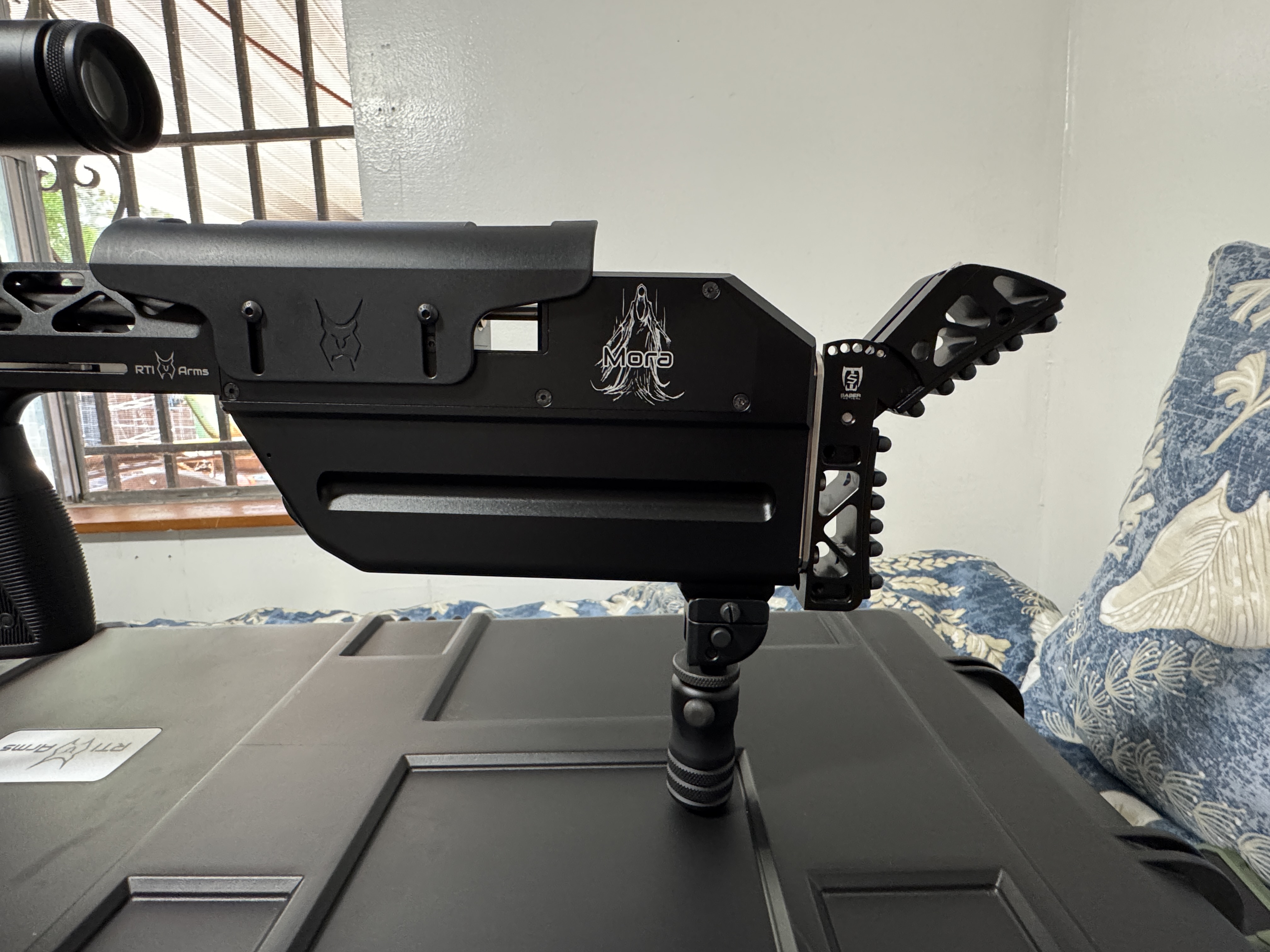

Nice butt pad. Im shooting queens too, they shoot the best of all the slugs i tried.

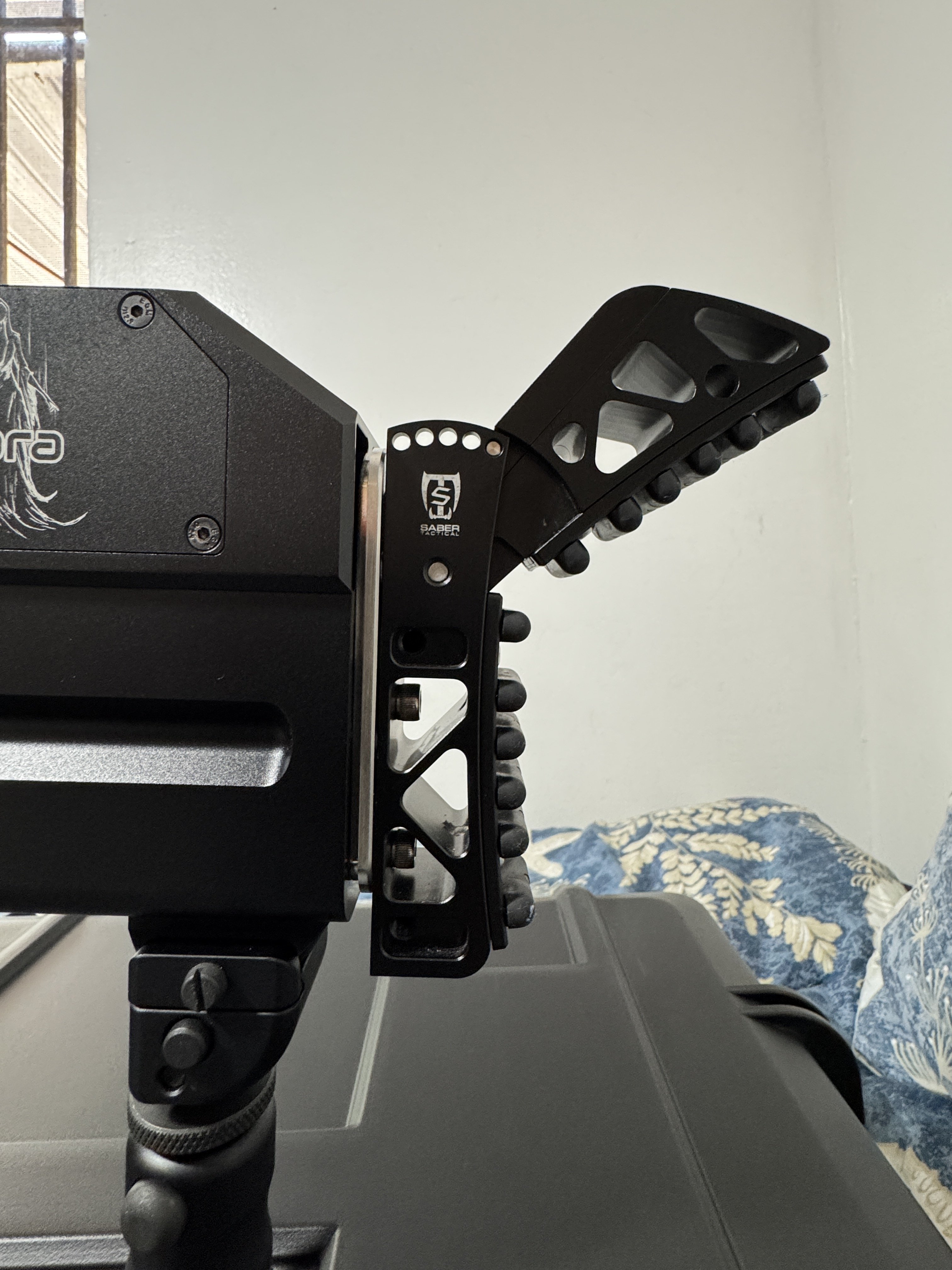

I didn’t like the OEM butt pad as it wasn’t adjustable and it would pop off too easy. I bought the adjustable Saber Tactical butt pad and modified it a little to make it fit which works great.
Reactions: jmohme

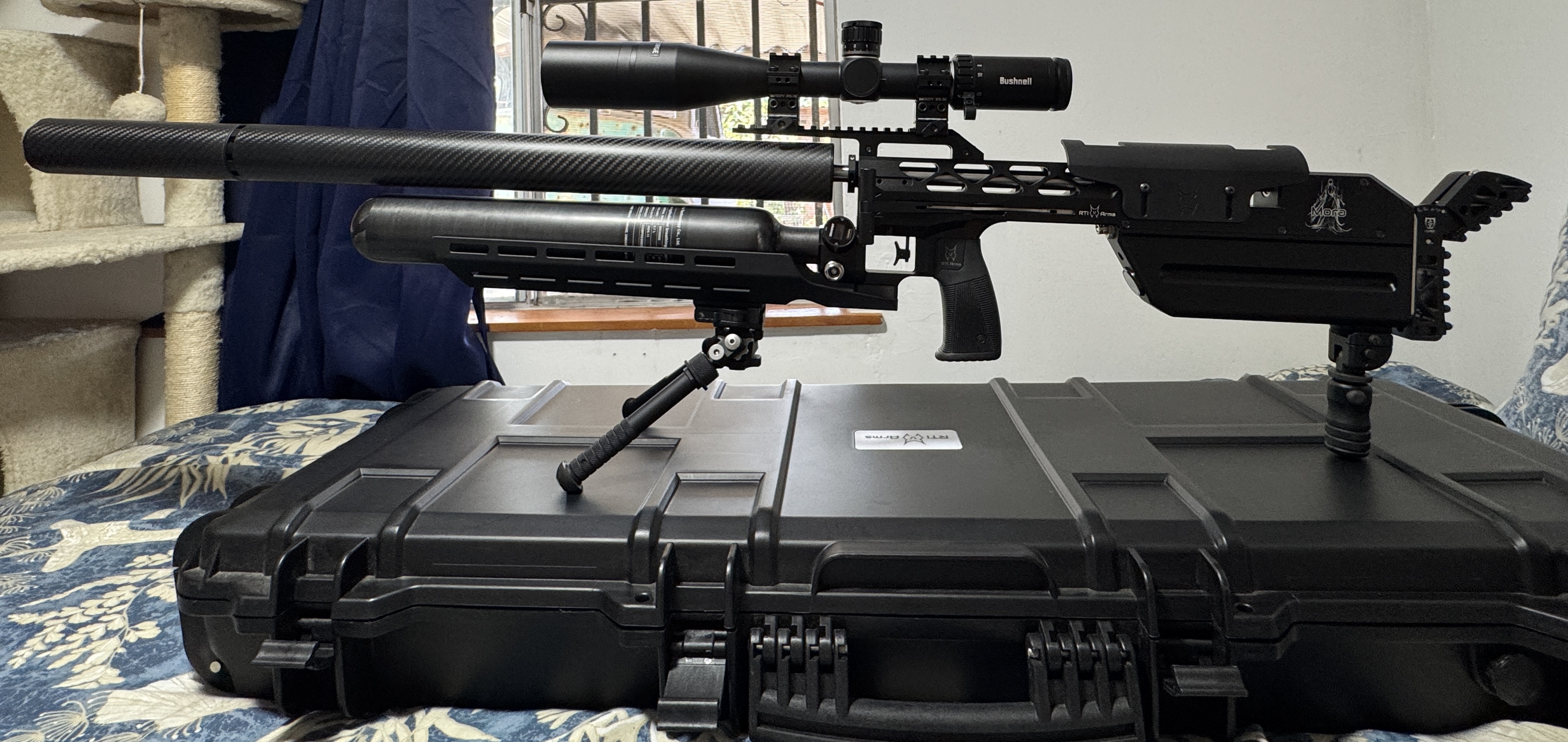

Hello. How high did you set the regulator? I see that the rail under the bipod is the same as mine, i.e. as close as possible to the trigger through the weak cylinder cover (it bends). Despite this, I felt that there was little stability until I bought a bipod utg Goliath. This great bipod and wide legs give a certain position. For now, I'm using an altar 49.5gr and I'm satisfied, but I think I'll try 60gr.
I set my regulator to 150 bar and about 2 lines showing on the valve. I haven’t had a problem with my bottom rail bending. I use the Atlas PSR bipod and I found that having it set to 90 degrees straight down gives it a better balance and 45 degrees facing back gives it about a 50/50 balance.
