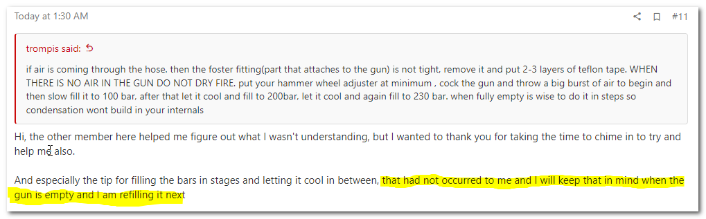

if air is coming through the hose. then the foster fitting(part that attaches to the gun) is not tight, remove it and put 2-3 layers of teflon tape. WHEN THERE IS NO AIR IN THE GUN DO NOT DRY FIRE. put your hammer wheel adjuster at minimum , cock the gun and throw a big burst of air to begin and then slow fill it to 100 bar, after that let it cool and fill to 200bar, let it cool and again fill to 230 bar. when fully empty is wise to do it in steps so condensation wont build in your internals

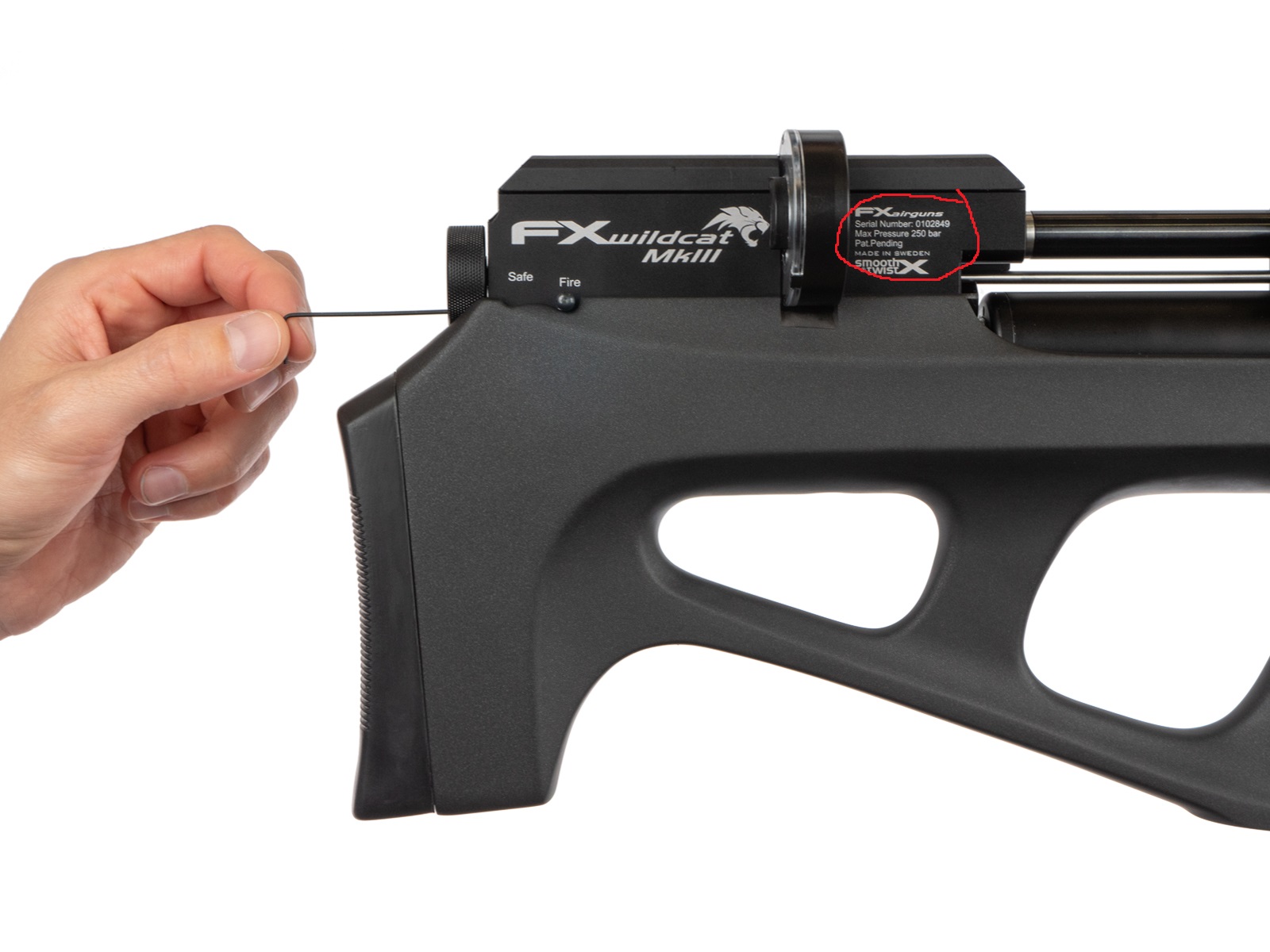

Here is where the max fill pressure will be listed

I am saying if its the 250 bar model then its almost full and do not fill it to 300 bar. No the rifle will fill to whatever pressure you try to push in it at least until something fails.
Look at the pic I posted it shows the location of the engraving that tells you what the max fill for your model is.
Alright, I think I got it now.
I guess I am super lucky then, that the tank could not push more air in it, because I definitely would have tried to fill the gauge up to the 300 mark.
Honestly, looking at the gauge, it should have red markings past the 250, because it is not intuitive at all, to me it looks like it should be filled to the full line.
Actually i am just going to take some red nail polish and paint the edge of the dial from 250-300 (serious)
Hi, the other member here helped me figure out what I wasn't understanding, but I wanted to thank you for taking the time to chime in to try and help me also.
And especially the tip for filling the bars in stages and letting it cool in between, that had not occurred to me and I will keep that in mind when the gun is empty and I am refilling it next
