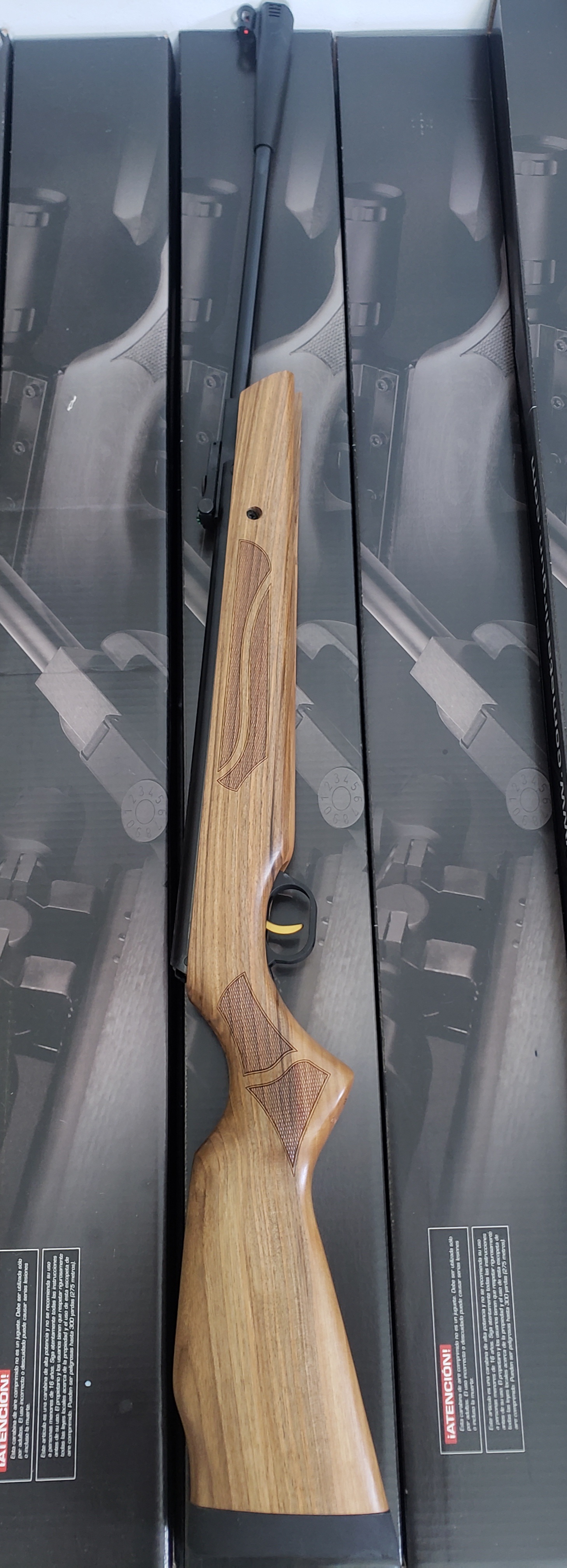

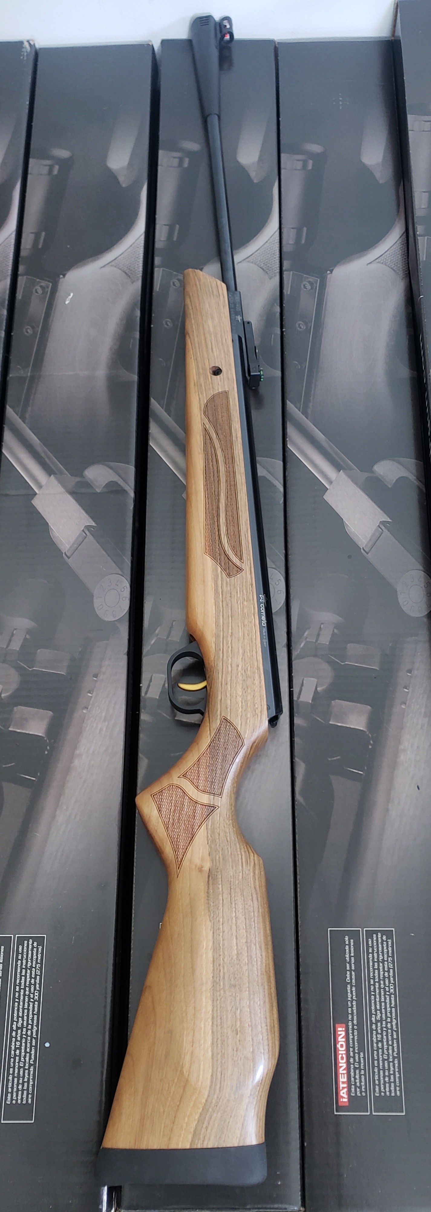

It is back together and I'll be testing it tomorrow for you. Here are some pictures to hold you over until you get it! Hope you like it!Yesterday I received my two Cometa air rifles and like them so much, and today I ordered a new tuned Cometa Fenix 400 Premier in .22 caliber from Keystone Airguns. Charles
Dang! Happy for him, sad for me lol... Out of the Premier in .22! I don't think I need the adjustable comb on the Star and I like the lighter tone wood. I'm sure you'll get more. What a beautiful stock with lots of character.It is back together and I'll be testing it tomorrow for you. Here are some pictures to hold you over until you get it! Hope you like it!
They're pretty hard to beat for the money. Its a 17ftlb hammer in a pretty walnut stock that weighs about 7.2lbs... for under $300. I should note though that @sekiar lucked into placing an order when I just got some demo metal triggers in so his got upgraded for free so I could test one. They typically come with synthetic triggers (that work absolutely fine!!) from the factory. The upgraded triggers will be available and very cheap shortly though. They are insanely easy to put in. Take the stock off and push out one pin remove the old trigger and then install the new one. In and out in under 5 minutes and then you just need to carefully adjust it to your liking.such a beautiful machine.....i gotta have one![]()

Looks beautiful and I'm really impressed with the stock and trigger!!! Thanks for the extra effort in making my day! CharlesIt is back together and I'll be testing it tomorrow for you. Here are some pictures to hold you over until you get it! Hope you like it!
