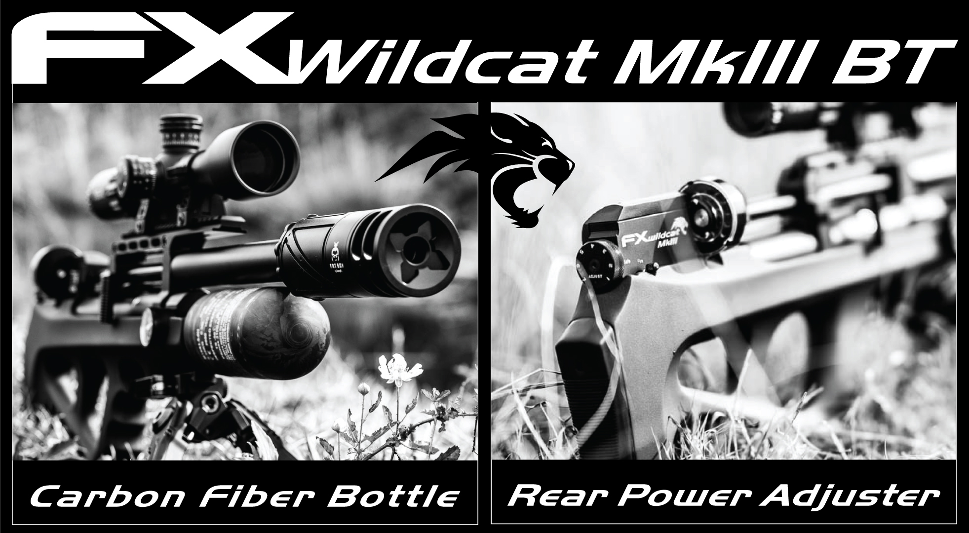

Taming this massive power center and refining accuracy, is accomplished using dual FX AMP Regulators. The first AMP regulator is placed just after the carbon fiber bottle (aluminum bottle on the lower priced VP version) to reduce the initial pressure in preparation for the second regulator. This provides less stress as well as allowing the use of 300 BAR bottles. The second AMP regulator allows the precise amount of air needed for consistency with each shot. Combined with the world’s most competition winning barrel system (the FX Smooth Twist X Barrel System), this ensures you have the most accurate rifle possible in your hands!
Complete adjustability is in your hands with the Wildcat MkIII BT! Both regulators are externally adjustable, and the rear power adjuster makes dialing in the right power easy to adjust for shifting hunting situations. A shooter can shift from the higher speeds needed for a long outdoor shot to dialing down the power for a shot taken in a barn or for target practice in the backyard. This rear power adjuster also allows quick micro and macro adjustments to fine tune the desired speed for the projectile you are shooting.

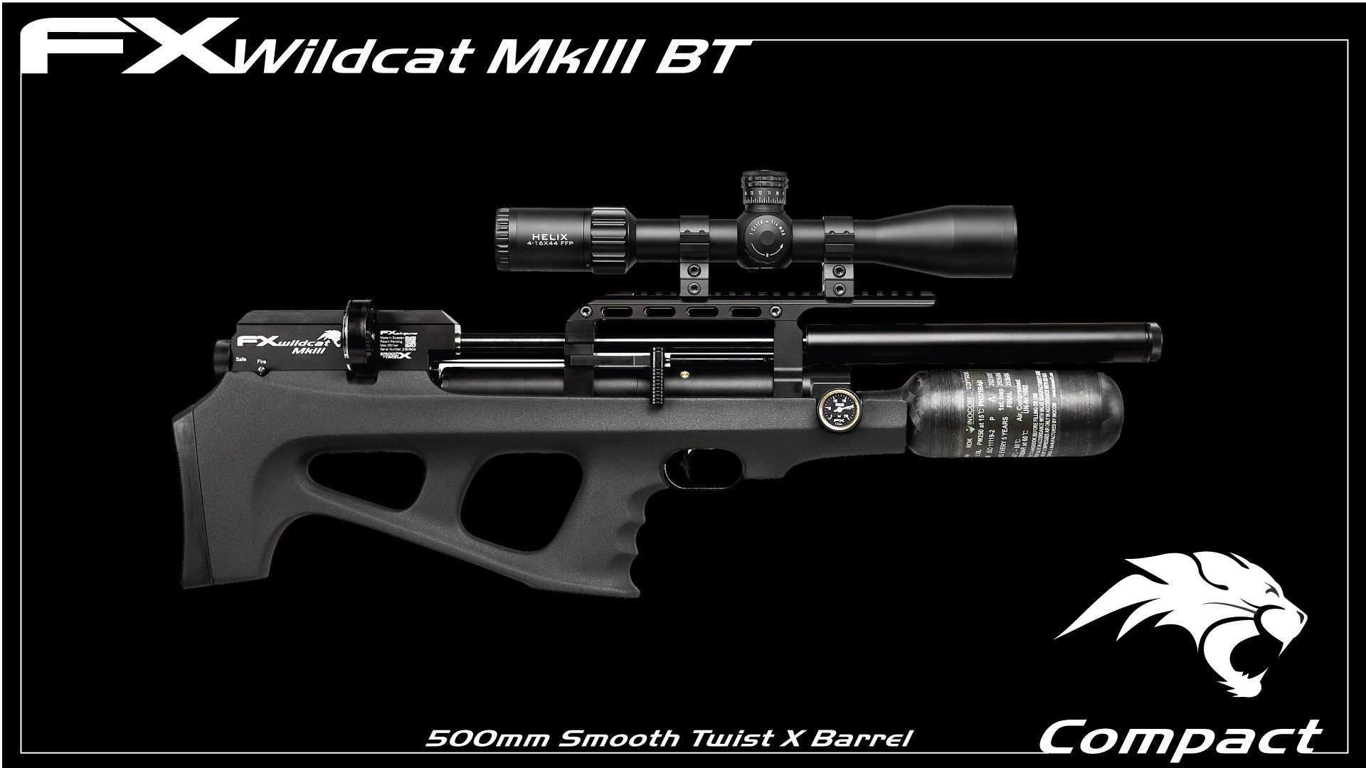

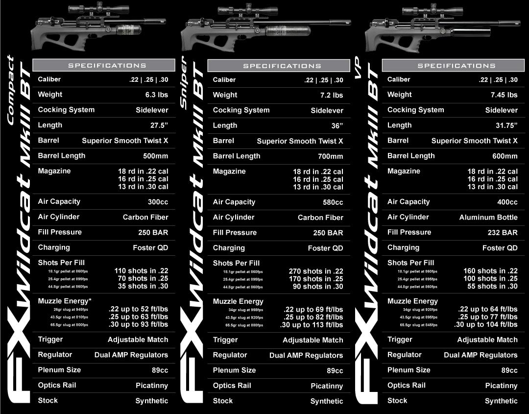

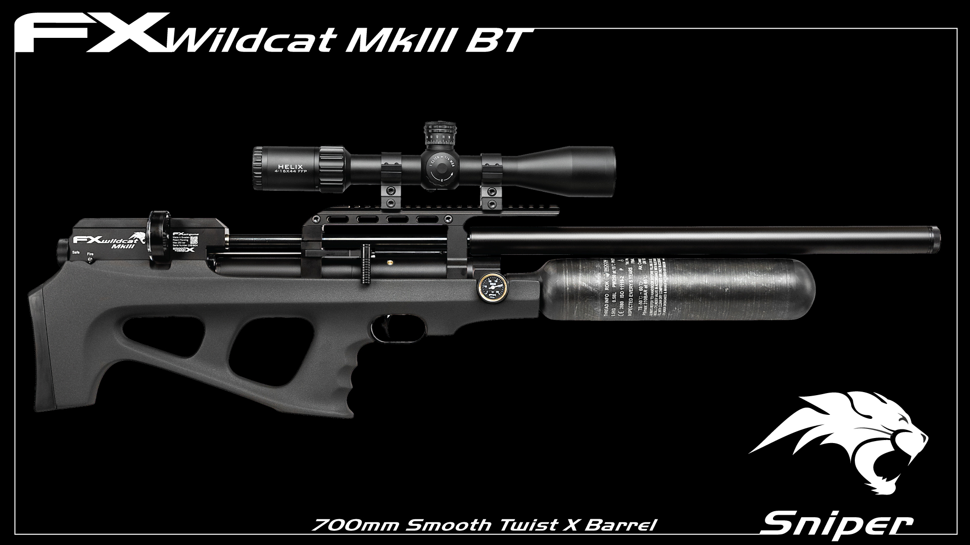

The FX Wildcat MkIII BT comes in three configurations: The Compact with a 300cc carbon fiber bottle and 500mm barrel, The Sniper with a 580cc carbon fiber bottle and 700mm barrel, and the value priced VP with a 400cc aluminum bottle and 600mm barrel. Additional barrel kits in calibers .177 thru .30 are sold separately and are easily interchangeable.

Pricing is as follows within the US: VP $1449.99 • Compact $1649.99 • Sniper $1799.99
