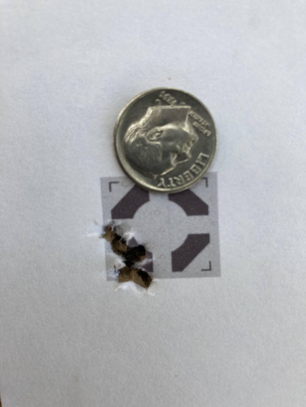

I’m not sure about the SSTX .177 liner, but the STX liner really wasn’t that great. When I was setting up my Crown for FT I tried that but the accuracy wasn’t good enough to be a competitive gun. So I bought off AGN Classifieds an older ST barrel (the solid barrel with just the rifling last couple of inches, not the liner system), and that was much much better. It’ll easily shoot dime size 5 shot groups at 50 yards with the 13.43 grain JSB RD Monsters at 820 FPS.

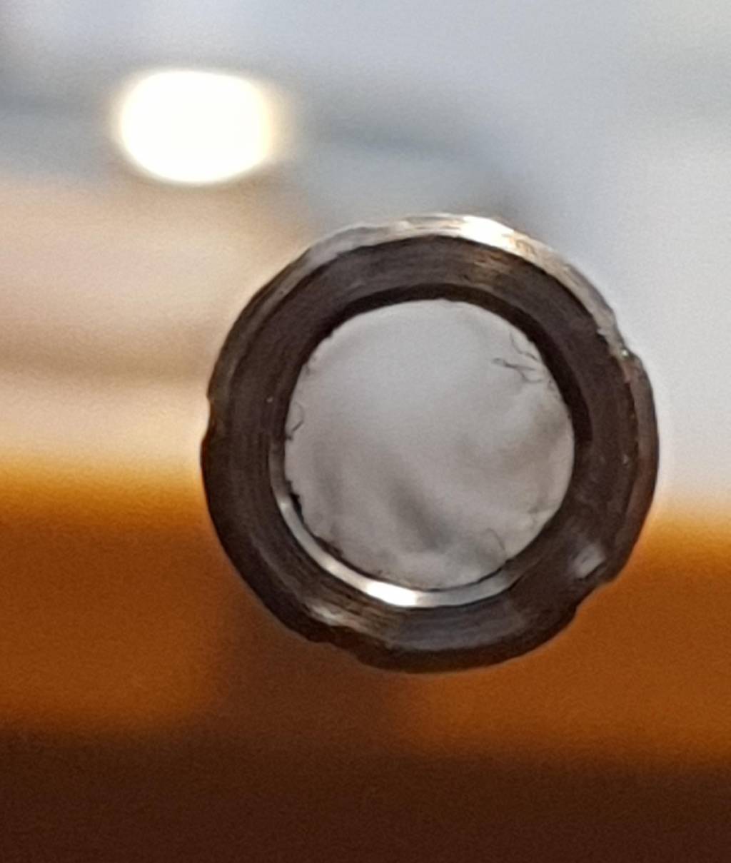

When I hold both in my hand it is only the small differences that I mentioned earlier where my biggest surprise was the twist is turning the pellet the other way around. (And it doesent matter what end you look at ;-)
Before i fitted the liner i pressed a couple of pellets throug each of the liners. The Superior is more tight and it feels like it has more choke too.

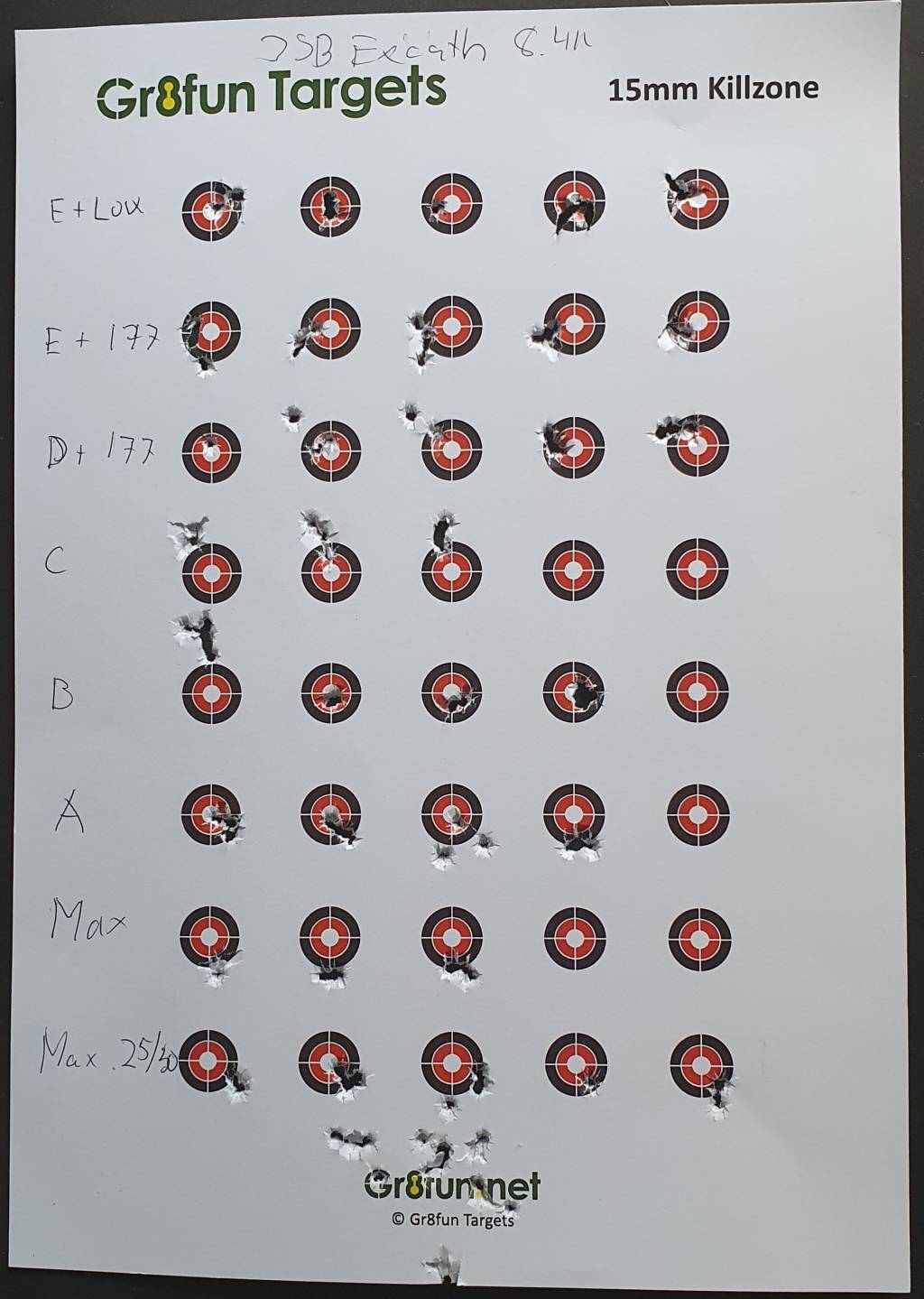

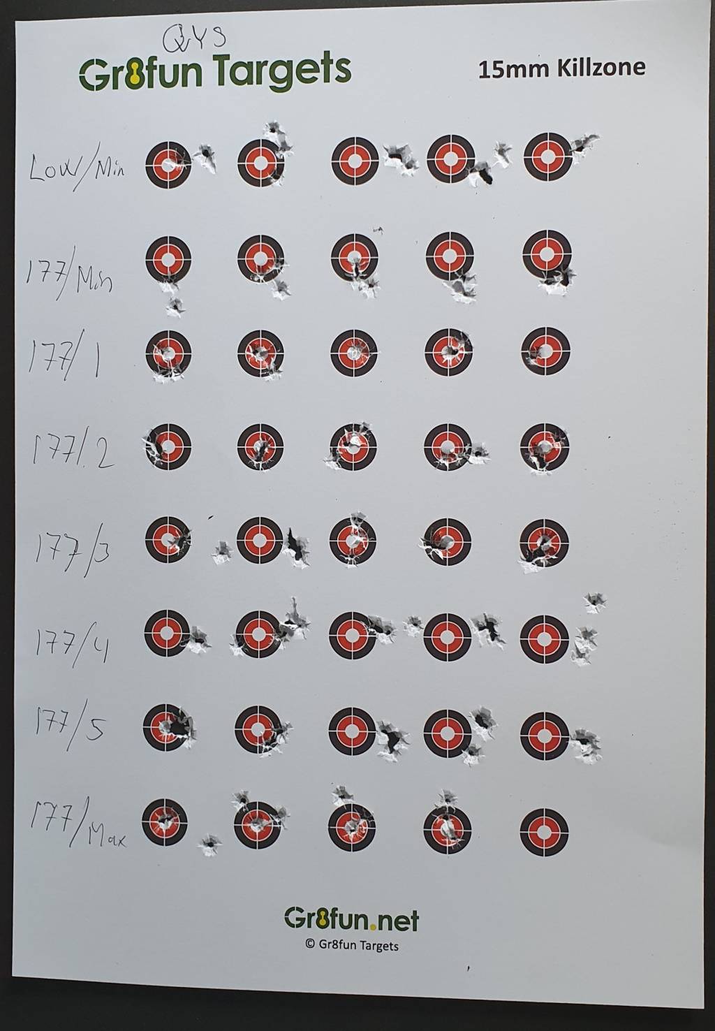

Example the Exact and Qys are accurate over three hammerstroke settings (ex: A,B and C)
With my STX it would be accurate with Exact and QYS only (and the QYS only at around 900 fps +/- 15 fps)
The superior seems to allow +/- 100 fps and still being able to keep tight groups.

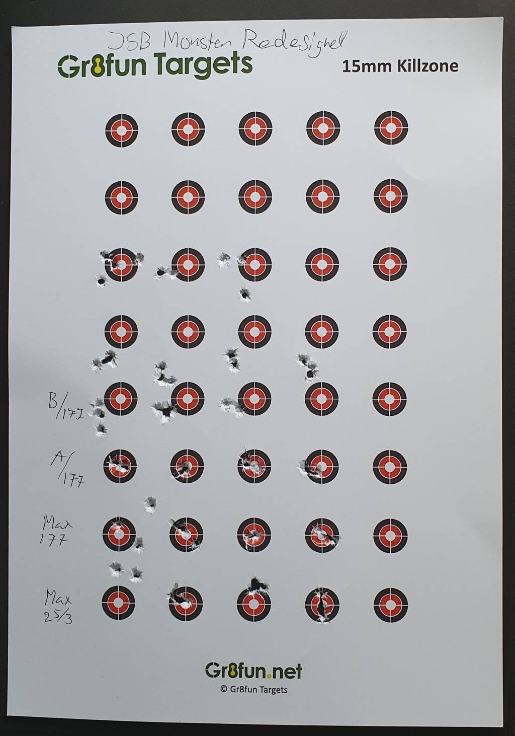

Some examples (The first target on the right i fired 3-4 shot to let the rifle ballance after changing the hammer stroke) I fired 3 shots in each target. some I stopped earlier because i saw it was consistand good. On the heavier pellets It opened up the groups as I reduced speed so i did not keep trying at lower speeds.

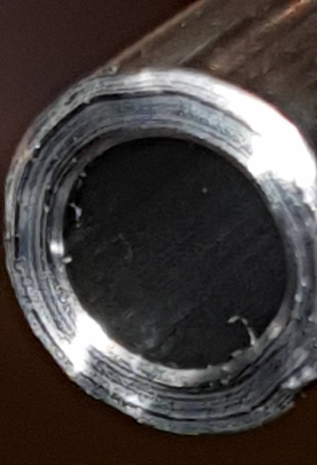

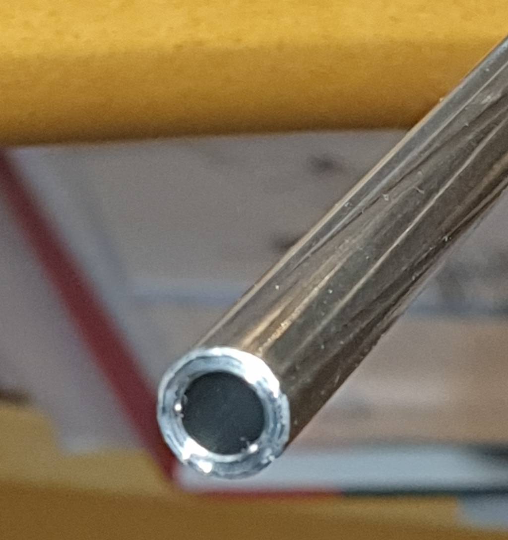

The STX Superior all viewed from the mussle end
