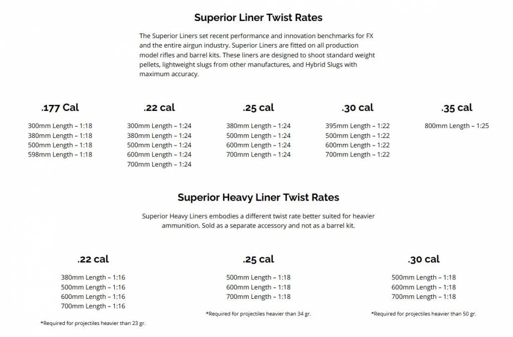

I suppose that I can add an update to my prior post in this thread regarding the 37" twist Superior .30. I've concluded that this barrel is most accurate around 915FPS with 44.75 JSBs. The minimum speed for this thing to shoot under an inch is 880FPS. Accuracy clearly degrades over 930FPS. The fastest that I have shot these pellets from my 500mm Maverick is somewhere north of 1000FPS.
I have also shot the 50.15 JSBs with this barrel to about 980FPS. They were bucking the wind like slugs at 100y and shooting just as tight as the 44.75 on a calmer day, but then I would get anywhere from 1-3 nasty flyers per 13 shot mag. They suck under ~920- great from 940-960 , but I haven't been able to eliminate the flyers with sorting by head diameter.
In retrospect, I still have the .30 700mm pellet liner with a 44" twist from my MKII Impact, and that barrel is just as accurate with a max velocity of 905FPS with the 44.75gr.
