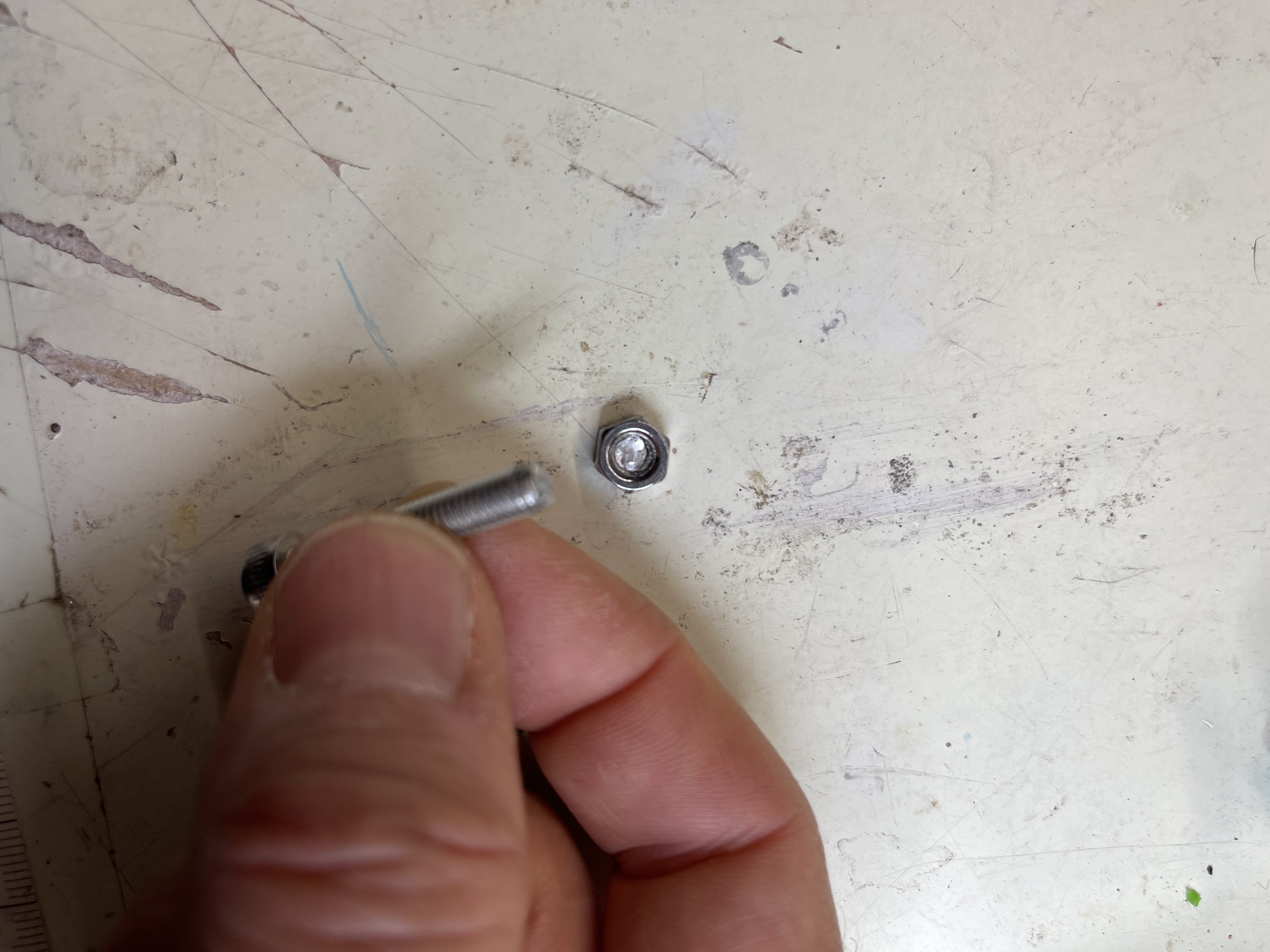

When I got my FX Chrony V2, it marred the picarails on my 2500 dollar BRK Ghost...🤬 (I call it the revenge of FX...;))
It would not unscrew (I figured it was on purpose, as it seemed it was some type of friction clamp, or to prevent the bolt unscrewing fully... turns out it wasn't...:( So when I wanted to get it off the gun it was stuck. I finally got if off, and when I wanted to separate the nut and bolt it required so much force to unscrew that it broke the screw! If you look closely in the picture you can still see a piece of it "welded" inside the nut! o_O

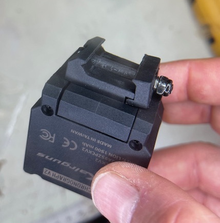

Then let's start off with a picatinny spring clamping system that does not require any tools to attach or detach...
For this you only need an M4 (meaning 4 millimeter) thick bolt with a locking nut, a piece of shrink tubing and a small spring. (ISO the M4 you can use an imperial size that comes close, it is not critical in size, as long as it is slightly thinner than the original (M5) because it makes the clamping mechanism work a little smoother when covered with shrinktube.
The shrink tube has a dual function: to prevent marring of the pica rail the Chrony attaches to, and to make the moveable piece of the clamp slide easier.
So when shrunk on the bolt you want to cut the shrink tube off long enough so it passes THROUGH the hole of the moving plastic clamp part, and if your spring has a large enough diameter it may be exending into the coils of the spring, but it does not have to.
The spring lives between the locking nut on the very end of the bolt and the plastic moving clamping piece. It goes into the hexagonal recess where the regular nut used to be but of course it needs to be wider than the hole the bolt passes through, so the spring compresses when the moving part is pushed towards the locking nut.
You have to figure out the exact length of the bolt depending on the size and strength of the spring used, and how hard you want the clamping force to be while still being able to "hook" and "unhook" the Chrony to and from the picarail. (This takes a little trial and error, but when you get the right length you can saw off or dremel the end off. Take your time when Dremelling, as you must not let it get so hot to melt the plastic pieces nor the plastic ring of the locking nut! (of course have the whole thing unscrewed from the chrony (by means of loosening the 4 hex screws on the side of the chrony) while working on it...)
You need a selflocking nut so it will not work itself loose when operating the mechanism, or due to any recoil of the airgun. (you could use a regular nut with locktite instead, but that takes time to dry and makes it more cumbersome to adjust on the fly, if your clamp is just too tight or too loose)

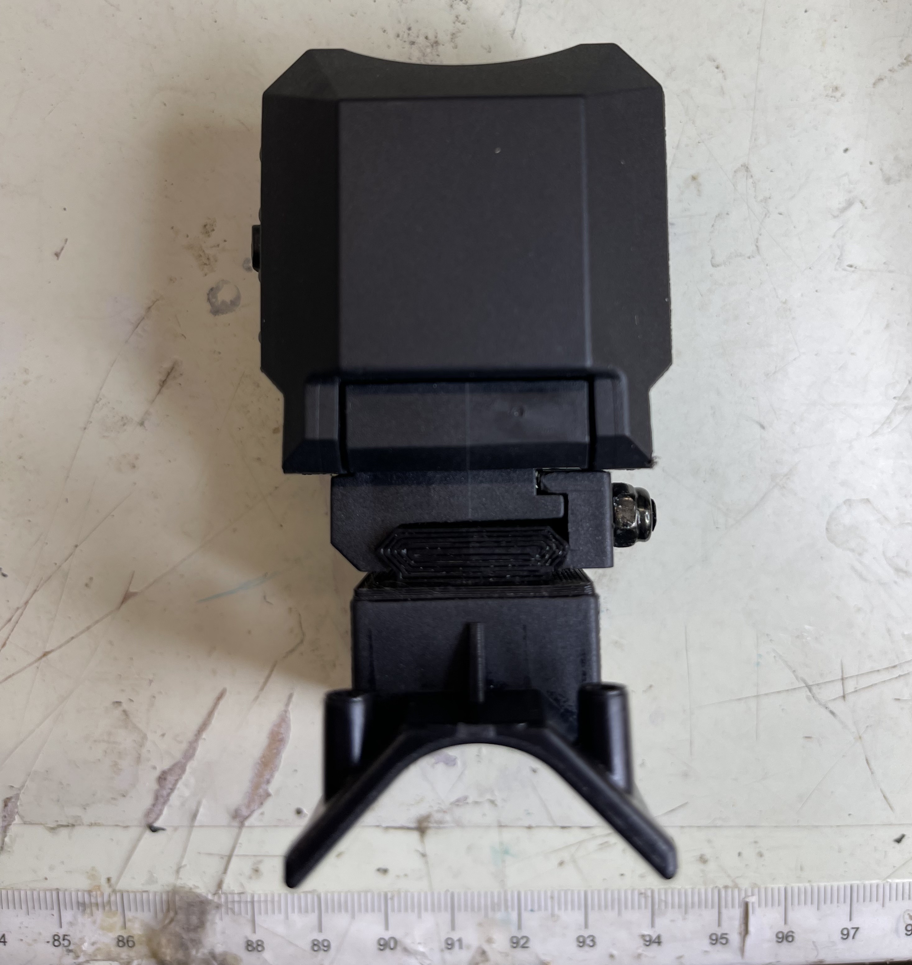

The picture shows a thousand words:
Once finished it now has a perfect spring tensioned clamp that needs no tools to get on or off your picatinnyrail equipped airgun. Cool! 😎🤩

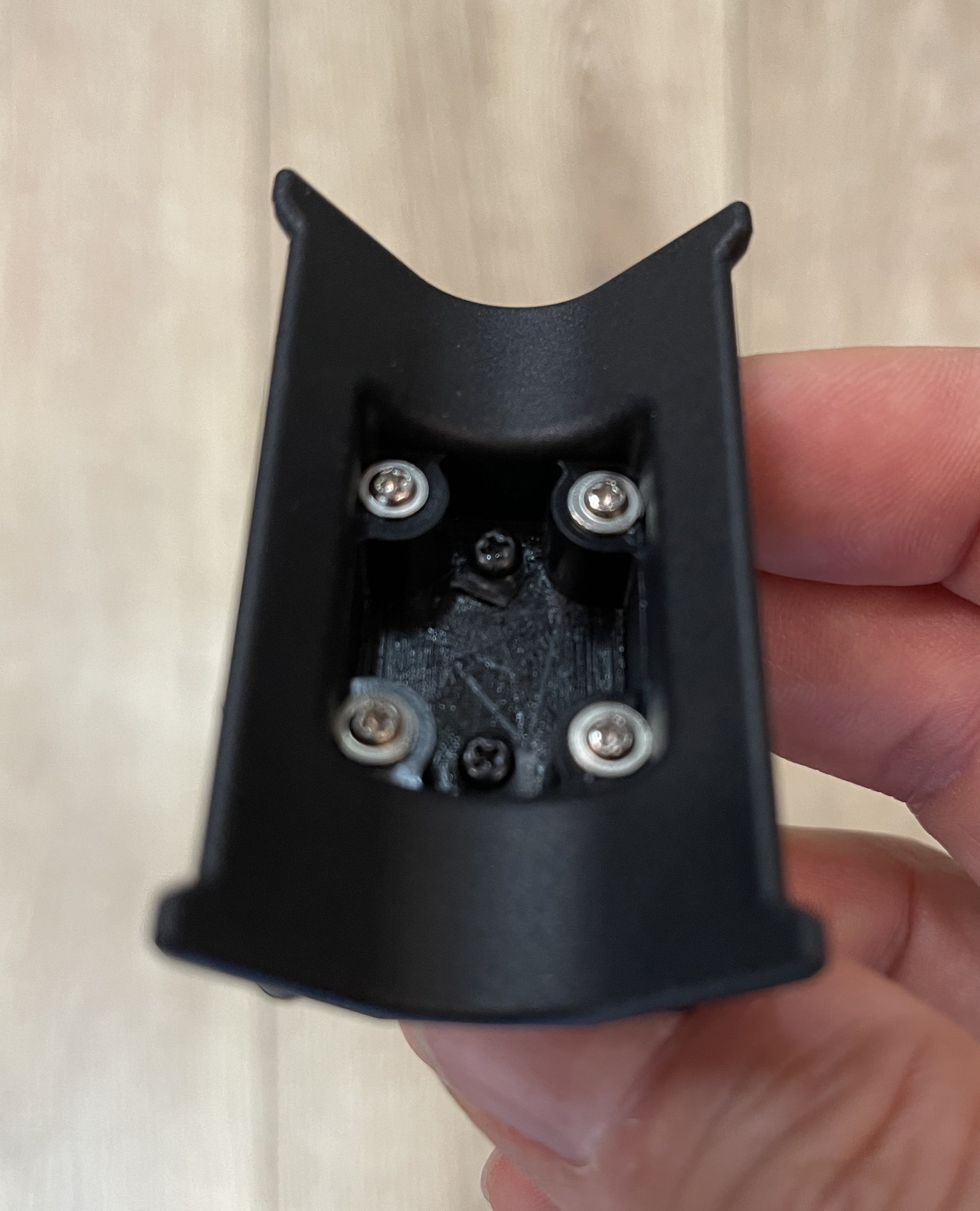

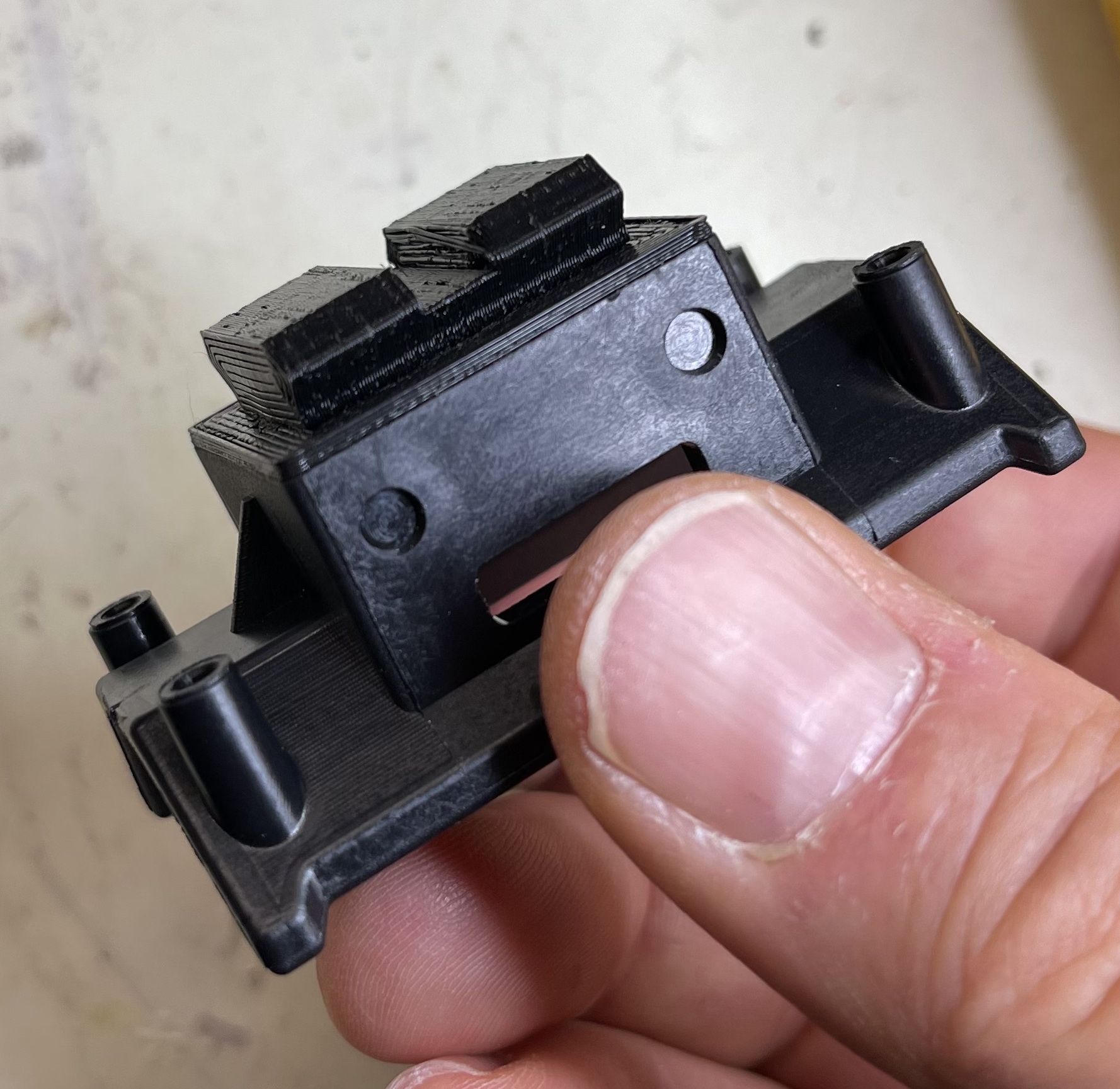

Now on to make it user friendly when using it incidentally on a non picatinny rail equipped airgun with the supplied concave piece...
As it turned out, the supplied FX concave piece has 4 holes, so it seems they maybe intended something like I envisioned, but they didn't pursue it as it was more costly for them. Anyway it made life much easier for me to draw someting up that could be used...

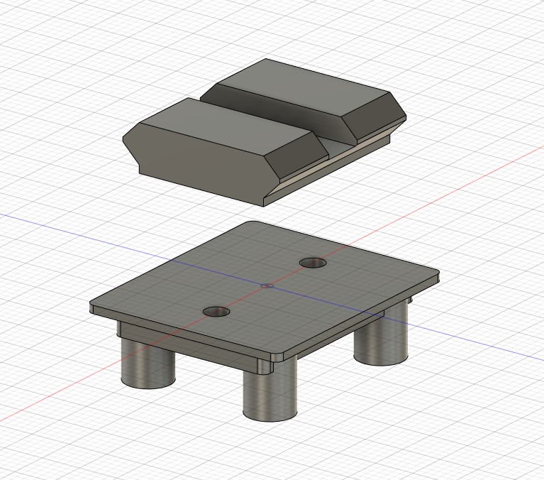

After some spielerei with Fusion360
Voila:
A 3D print piece of picatinnyrail for the Chrony to clamp onto, and a small "table" to connect the whole encillada to the FX concave part.
The silver screws are used to join the "table" to the concave FX piece, (that is where FX made the holes already for me) and the black screws are to join the small piece of pica rail to the table.
There are no extra holes or any other permanent deformations to the original FX hardware, so If ever wanted, everything screws apart, and nobody is the wiser!
The completed thing looks like this:
And since we already had a toolless springclamp equipped Chrony V2, we can now simply attach or deattach the whole thing in under 1 second...
Ooh yeah baby!
When used in this manner, it is a little higher than when using it the way FX intends it, but it still a lot smaller(!) than the earlier version of the FX Chrony, and you have the same flexibilty that is a lot less time consuming as well!
Should you want to make it, the 3D print file can be found here: https://www.thingiverse.com/thing:6360272
And please upload a picture if you printed it!

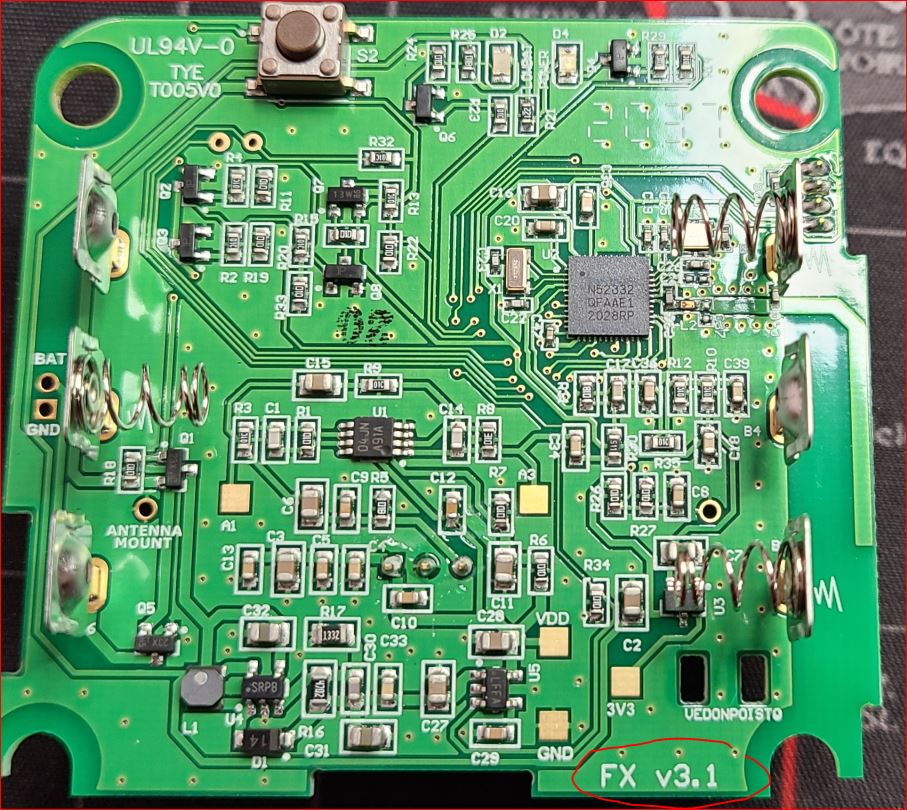

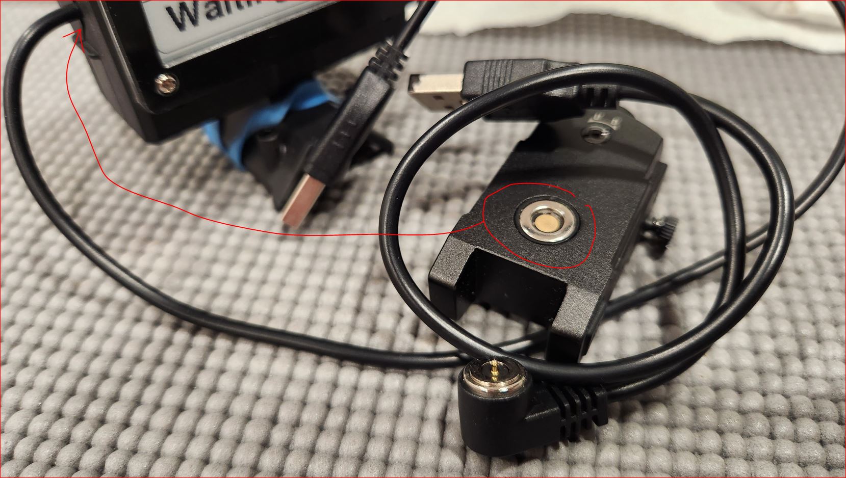

I have the very first FX radar, replace it ones under warranty, this second radar is working ever since.

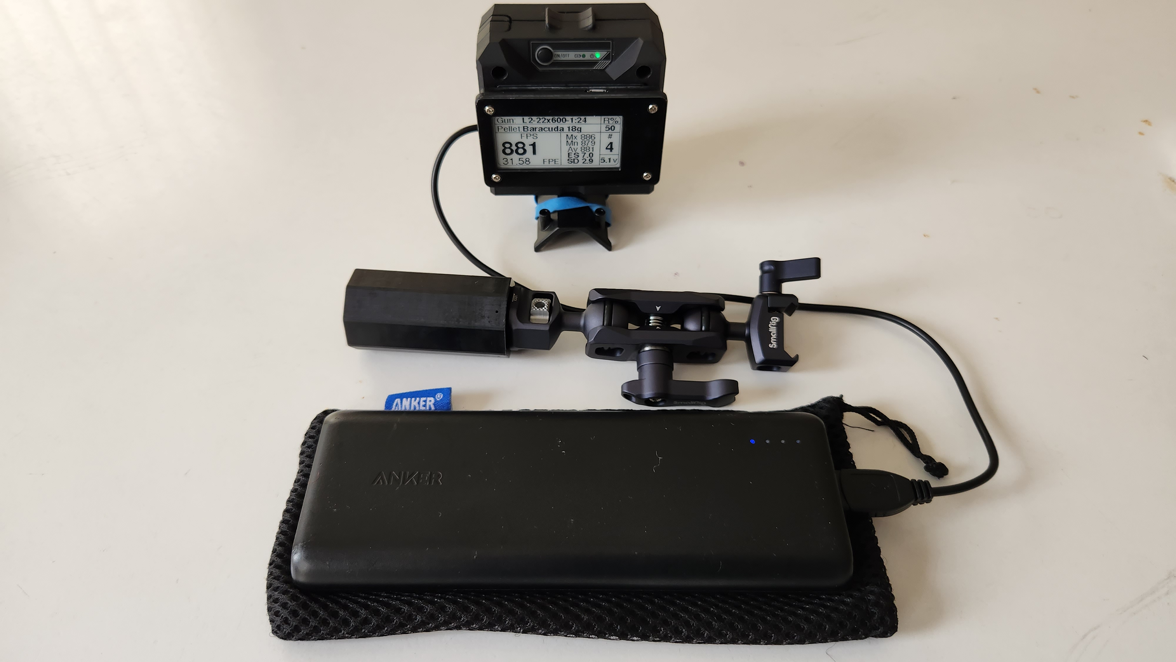

FX ver.3
Also, I upgraded with a screen and external battery power
I already have the parts, but didn't got there yet to make the cable removable... as I have it on the green lazer

I like what you did to your FX.
If I get one, I will do external power mod for sure.
Display mod is too advanced for me, but I am ok with checking the phone.
