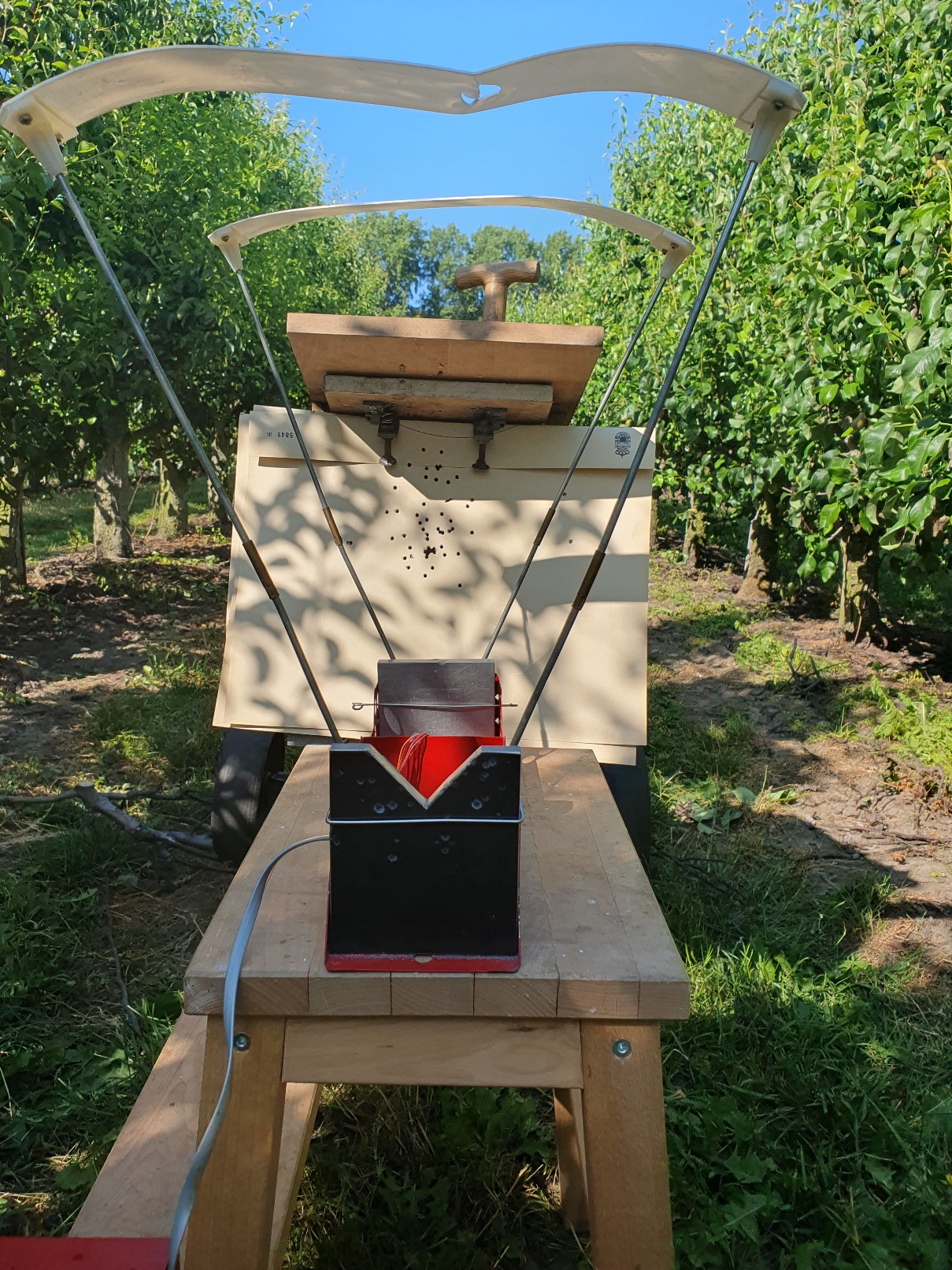

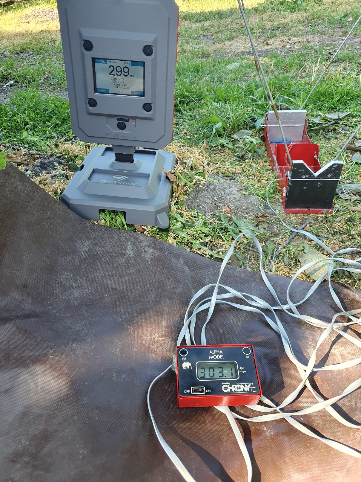

I did some test today, with a alpha chrony next to the TBC and they are very close, the TBC.
Alpha chrony at target 50m or 100m see pictures, and a V0 measurement. It would be great if you can export al the recieved data.
What I dont understand is why the TBC gives readings after the slug/pellet is stopped in the catch box? So that is calculated data.
The battery from the TBC is great! Still at 100% after 4 hours use. It's easy to use and tracks almoost all shots 99%. Its easy to use and I'm very happy with it.
I would tend to believe the FX (or Labradar), rather than any optical unit. I say this, because I don't know what the oscillator specs are in either unit. This said, the FX most assuredly uses a temperature-compensated, crystal-based oscillator, and any frequency variation would be rather small. The Alpha crony's oscillator is not compensated. QED
