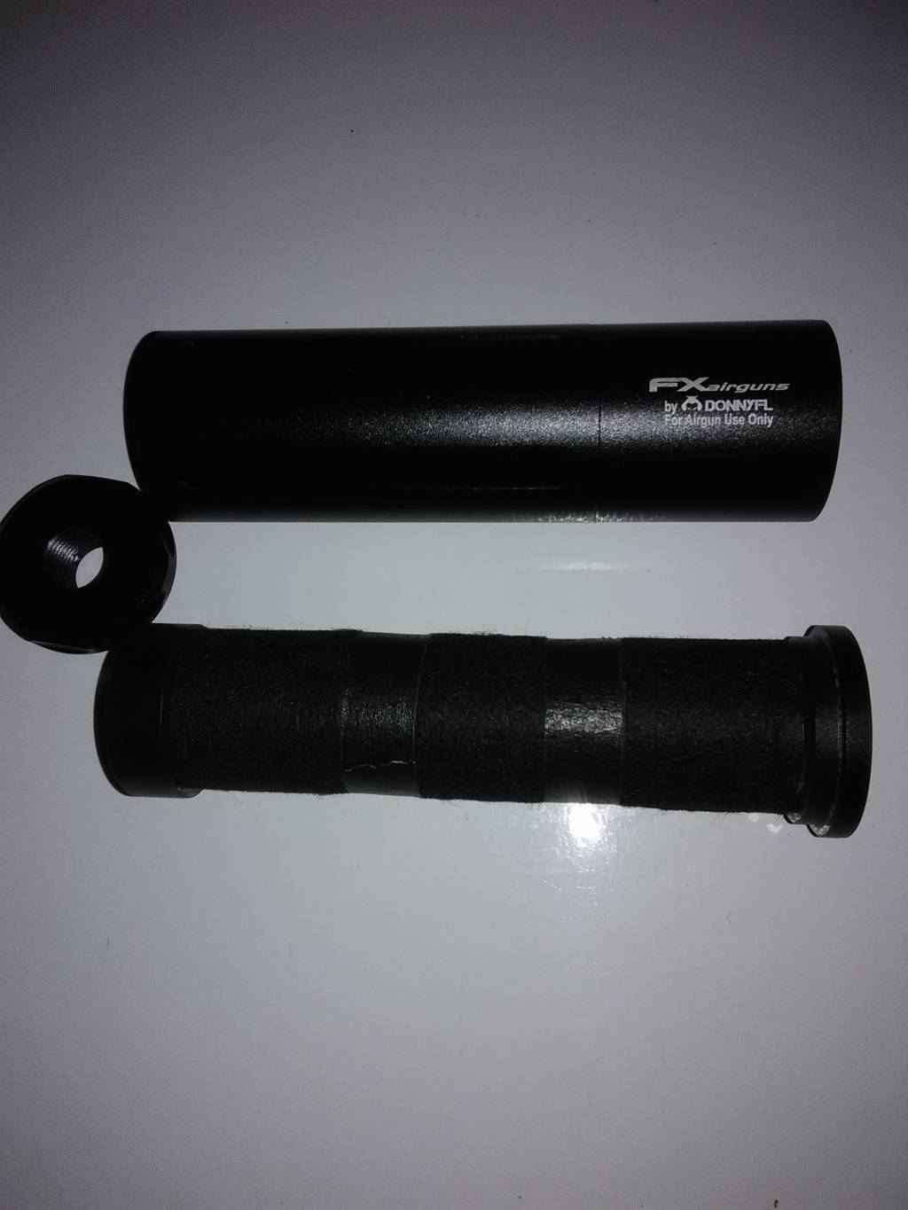

2. Also, my gun came with a moderator that screws on the end of the barrel. After closer inspection there is nothing inside of it. No small end cap was included in the case either. Is this normal?

I've the same gun in bronze. Side of bottle will state 250 or 300 bar. (Mine says 250) Recommend following 250 bar limit as shown on gun. Some have purchased 300 bar bottles and stronger regulators, that is an option you could research. As I understand, only compact M3s had end caps included. Also, my DonnyFL moderator is not an empty shell. Contact dealer about that. Best of Luck, WM

Looks like you and I have identical guns. 18.13 is correct, your bottle reads same as mine, 250 bar. I'm at a loss with the empty FX moderator by DonnyFL. There was no mention about any options regarding the moderator, from my Dealer, and it's clearly not an empty shell.
I've followed threads regarding replacing the 250 bottle with a 300, however many question the OEM regulator's safe ability to handle the load and suggest an upgrade. I'm satisfied sticking to the 250 limit, seems might prove a little easier on everything, including my compressor. My new AGT Uragan in .25 is fully rated for 300 bar, with a gauge to match, but I'll stick with 250 bar fills. WM
The FX made suppressor is empty and you can add 3D printed baffles to make it quieter than anything DFL sells. https://www.thingiverse.com/thing:4914398

Took apart the FX moderator, by DonnyFL, that came with my M3. Again, no extra charge for the insert. WM
All DFLs come that way But I'd prefer the empty can made by FX and included at no extra charge. When you put 3D printed baffles in it it's way quieter than the others and you can add an extra center section for larger calibers or high power tunes to make sound much like a blowgun. Here's my former impact .30 tuned to 132fpe with the extra center section in the moderator with 7 air stripper baffles. The gun was quiet but the slug hitting it's mark was loud.
