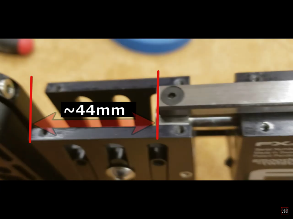

This is how you know if your pellet proble is perfectly aligned with the bras insert. Measure the 44 mm
interesting ranting video, by his logic the dreamline has way more adjustments. My question is how do you check prob port alignment in the gun? having it outside isn't going to be the same as how it is in the gun. The loose prob could be an interesting find.
Mark the probe position at the edge of the entrance to the brass TP with the bolt closed. Pull the probe and barrel and look at your mark when inserted in the barrel's TP. You'll see that the probe aligns perfectly, and if you have a fresh or decent TP O-ring, it seals tight enough and doesn't blow out any air at all like it would if it were to be as loose as what he makes them out to be. There is a small amount of play for a reason, obliviously . You'll also realize that the probe doesn't bottom out inside the brass TP as he was demonstrating in the video with his illustration.
Measure like this
