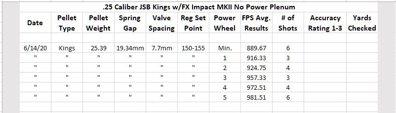

I am finding out that some like to shoot their gun inside the house. Those lower velocities are good for that, plus the 12 FPE laws in some countries. None of which was mentioned of course. Sometimes it is what is left out of a video that you have to watch for to get the "truth".
I do like how my Impact power wheel is working for me so far. I bought my Impact for power...I don't shoot my guns inside the house.
