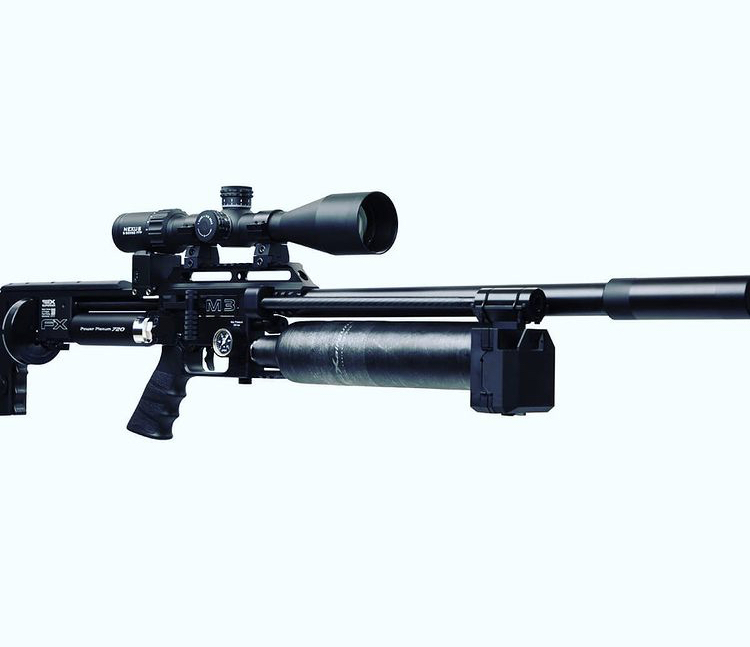

Integrated Chrono in the barrel? Really? Looks to me like an optional FX Chrono on a stick with remote Bluetooth readout. Integrated in the barrel??? Maybe they meant ON not IN?
From the video I watched there seems to be 2 options, The promo video has the Moderator with the built in chrono. It looks like there's also a side mounting ability if you have the older promo and from some research this morning you can get the Display for the old chronographs separately.
Sooo. Yeah the chronograph is integrated into the moderator.
