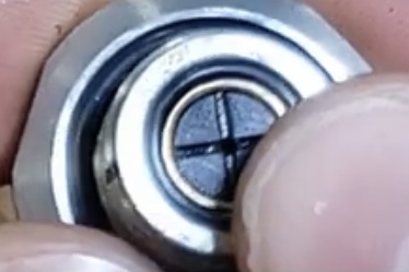

Been thinking about how fx did this. It’s quite an achievement when you think about it.
It is able to do 3 things and yet just looks like a simple small coupling between the bottle and the gun.
What does it do? First and foremost it is a regulator and controls the pressure from the bottle reducing it to the factory setting of 150bar.
Then it also must allow air through to the bottle from the filling.port for this it must have an open pathway through past the regulator.
Then also on this open line from fill port to bottle they have a gauge for bottle pressure.
Putting it basically in the neck of the bottle takes up no room and doesn’t require any changes to the way the gun looks. Really clever.
If you went back 5 years to the first Impact could you imagine how it might have changed the guns evolution if this had been there first choice for regulator position!

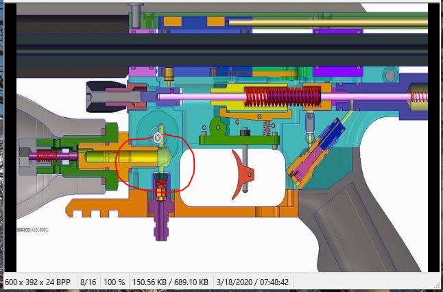

I’ve been asking the same question. I guess when filling the bottle air must get there on a dedicated pathway so I’m thinking there must be some changes to the internals of the m3 for this to happen.
Otherwise you’d be pushing air into the plenum. But I’m just guessing.

You can install new regulator on MK2 bottle with additional o-ring but you want be able to attach to the gun. Looks like M3 block is female connection not male like MK2, or I’m mistaking.
B
The thread in all impacts is female from what I see. Theres a similar looking part that the bottle attaches to on mk1/2. Youd have to remove the mk1/2 one of course but would be female from what I see.
Even if it did fit, how would you fill the gun (I think the bottle valve is different)? I agree with @airsupply The Engineering on that regulator is impressive. FX has come a long way since the Home Depot Engineering on guns like the Bobcat Mk1.
Yeah you'd need that special bottle as well I'd imagine. Nice step forward👍

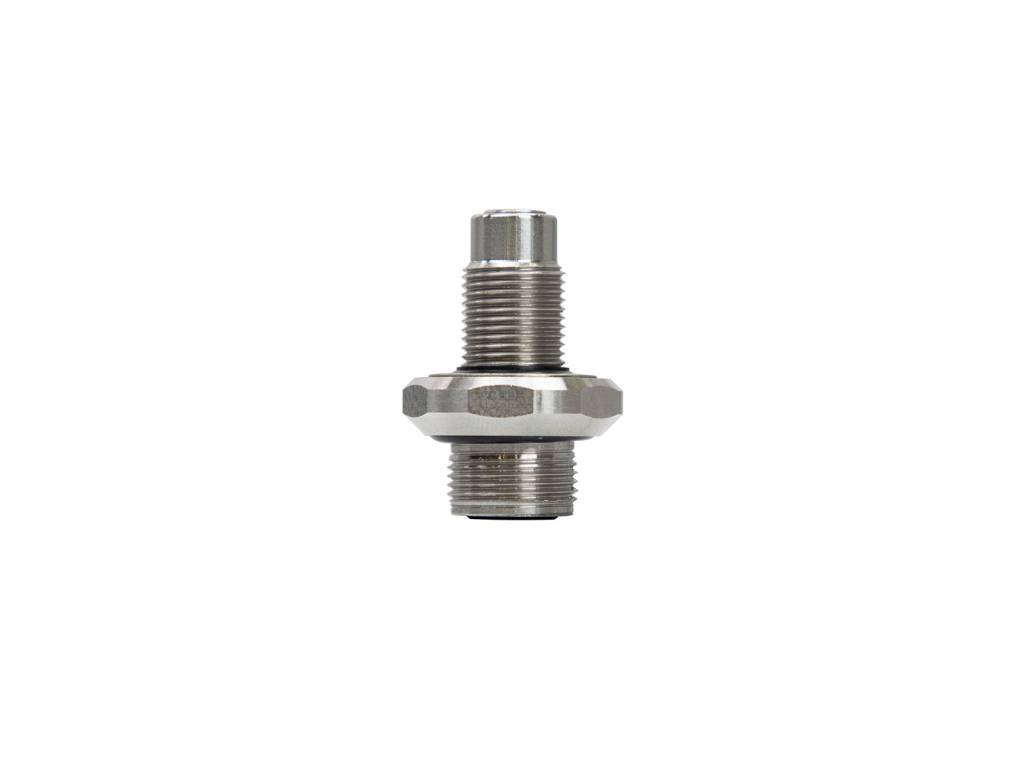

Yes on the gun side of the regulator you now have “2” sealing orings. The fill airs dedicated path way would run between them. Then the regulator has its own oring to isolate its regulated air on its way to reg no 2.
The m3 would have a new internal sealing surface for the regulated air.
You can see an inner and outer orings in the photo.
I’ll bet you could make a small adapter with just a fill port on it to use this on older guns. It would move the bottle forward the width of the new fill port. You’d loose the bottle gauge as it would become first regulator pressure.
Or you could buy an M3 🤔
Could also make a picatinny rail that incorporates the new fill port and put a blank in the old fill port spot.
