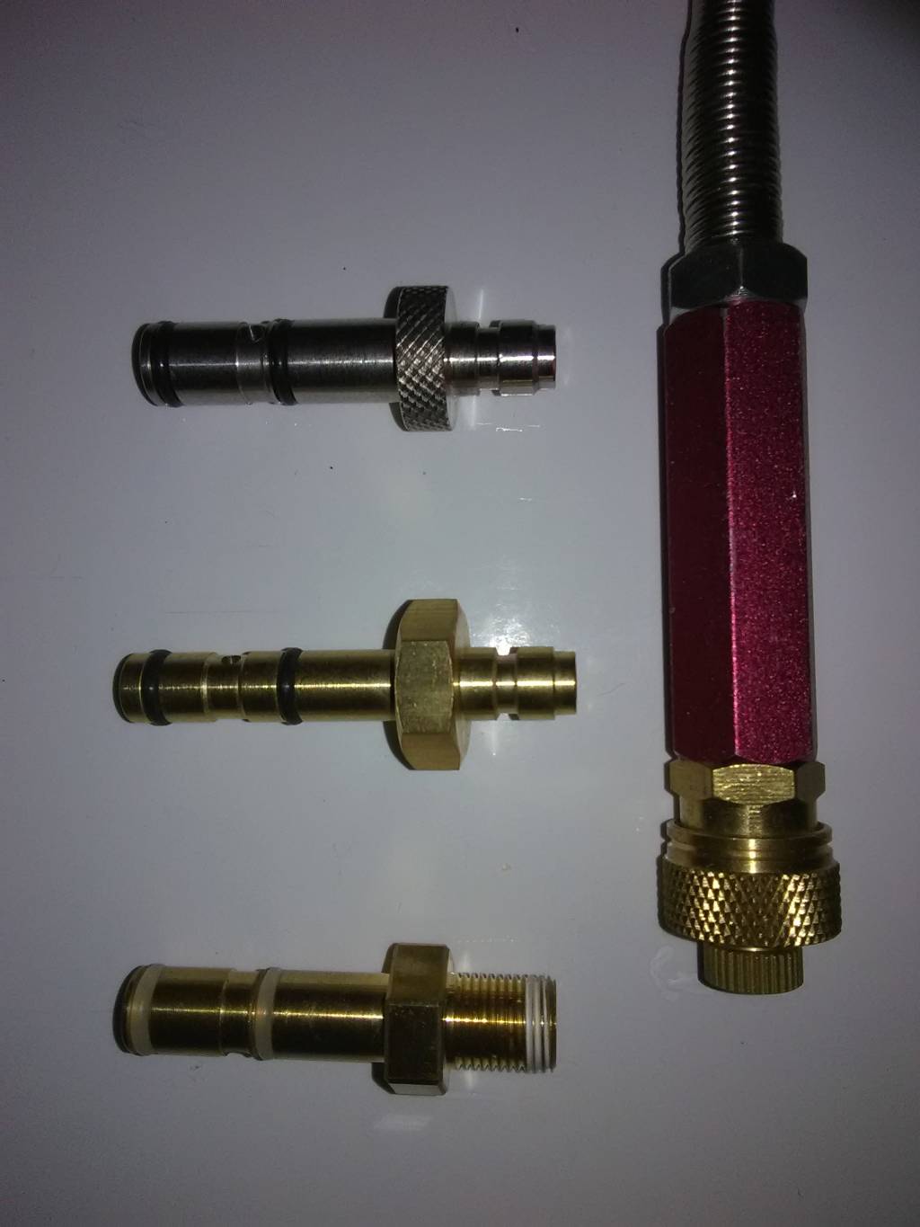

Sorry, reflecting on my Wildcat III experience reminded me of some other things. #! Owner's Manual will be, most likely for earlier Wildcat models and won't show how to load magazine. #2 Fill probe will need attention.
Bottom is what FX will send, top is what you need. Don't waste time taking apart end of fill hose and trying to screw FX probe into red end. Middle probe was $13 (too small) I got from Chinese seller on eBay, swore it would fit FX. (Full refund, they said keep it.) Top is $30 stainless steel probe from DonnyFL. (Tapping a scrolling flag on AGN page top will take you to vender.) Two other choices; a British company also offers SS probes (cheaper) and Pyramid Air sells adapters (stamped Air Venturi on side) that report to fit on FX OEM probe. Think in retrospect I'd try Pyramid adapters first, like $6.
