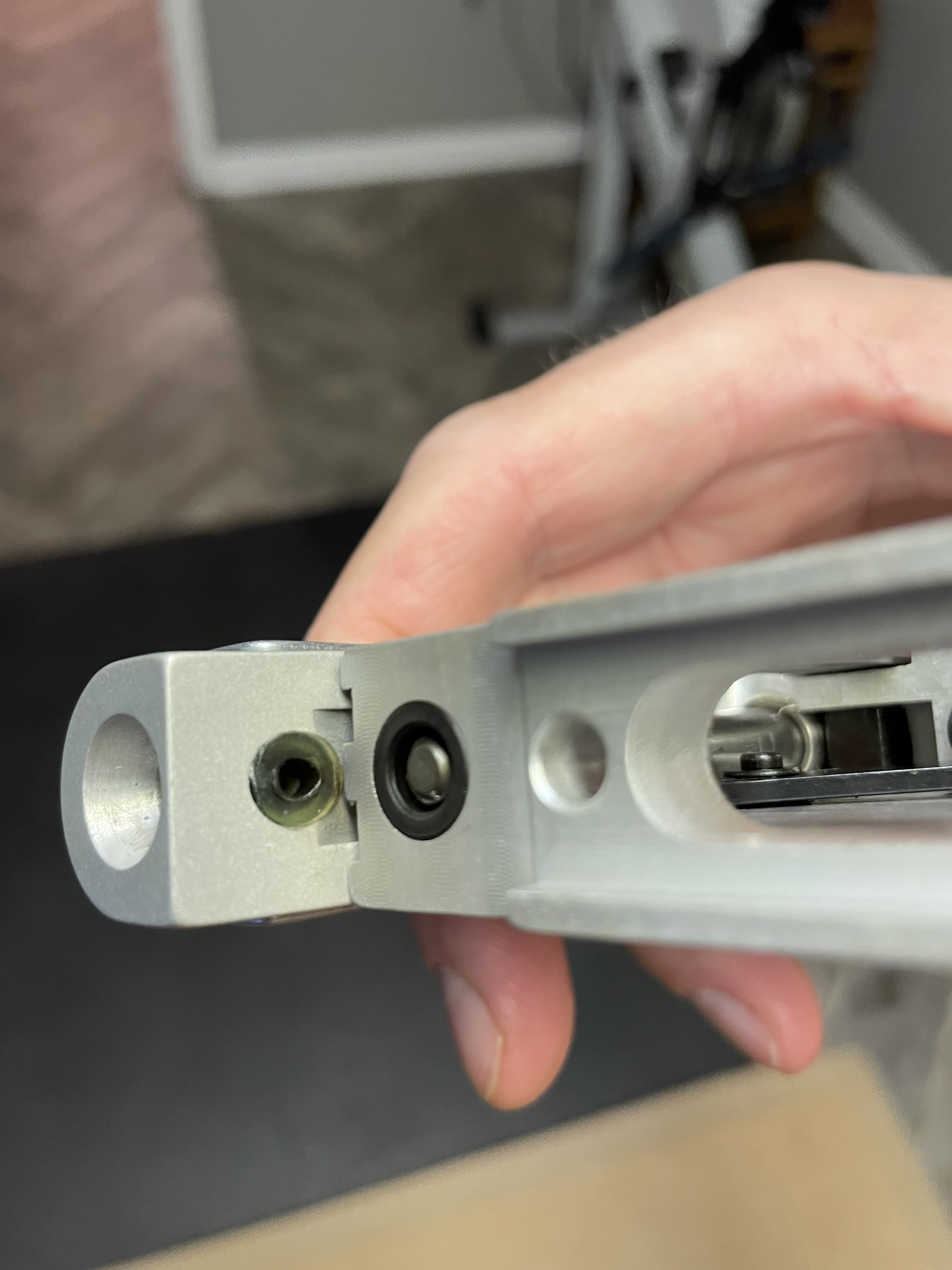

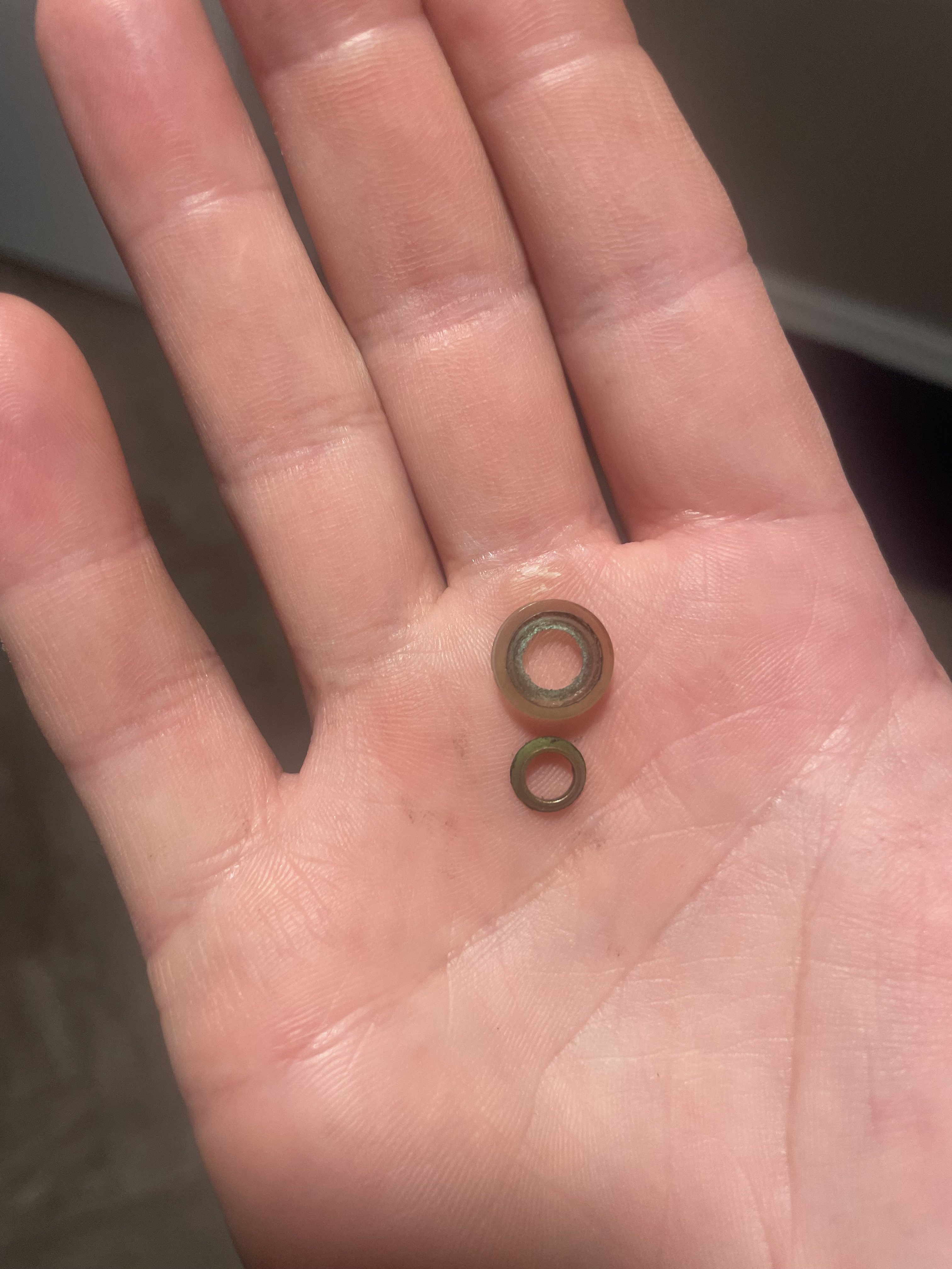

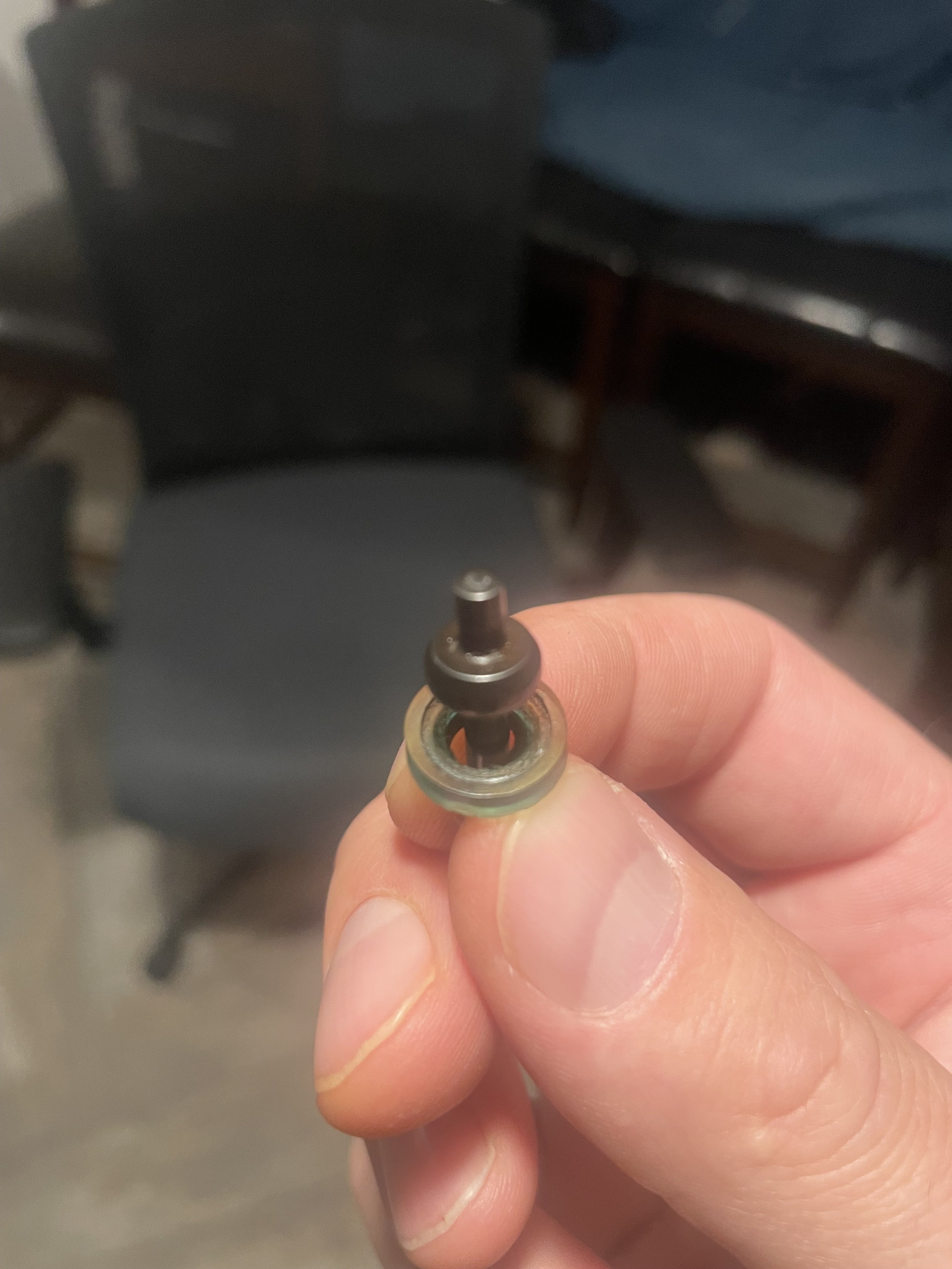

It would appear that the exhaust and transfer seals are toast. The problem is that the only parts I could find are in Canada and the eBay seller no longer ships to the US.

Another fun fact... That may help those that follow. While disassembled I was curious if the charging piston was charging air. While covering the exhaust port with my thumb I was not able to get more than about 25% of the way through the return stroke without air being forced past my thumb. While not conclusive it is probably a good sign that pressure is being built, just no retained by the exhaust valve seal.
