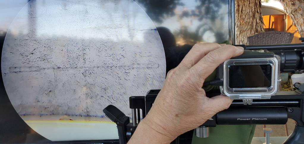

Alex, I tell you my head is about to explode attempting to focus the retical. 🤯

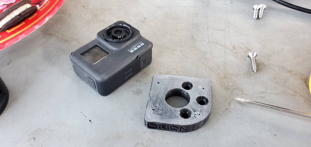

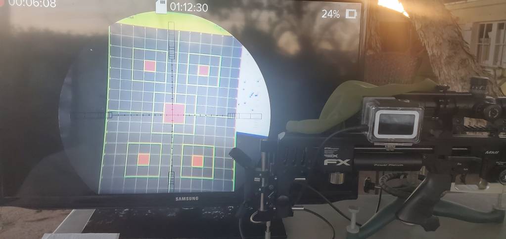

Well after fighting with quite a bit, I am at least close. While fighting all this I started debating about just buying the $1200 gopro kit with the it all working, but I don't like spending money like that unnecessary. Its getting dark and video quality is going down dramatically so it is about time to call it a day. I got my adapter from Orion but I think it was made for the older style gopro. So a little additional work needed to be done to make things work.
Use a solid flat-field, like a white wall. Set your scope's variable diopter adjustment to it's mid-point.
Screw the lens in until it just has enough thread engagement that it won't fall out. Then check focus of the reticle only. Screw lens in 1/2 rotation and check focus again. Continue until the focus is the best. If it's not good enough yet, leave it there, then see if you can bring it in the rest of the way with the diopter adjustment.
Thanks Chuck, I ended not needing to adjust my diopter. I'm so blind I needed all that for me to see and shoot. Since my camera case and adapter was screwed in and camera was off center (made for a earlier model gopro) I detached the case from the mount and held it at the opening by hand after each adjustment. It made it easier to focus since it seemed no matter what I did it was not close to being focused. Fumbling with the case on was a mess. With it off it was easier but it still seemed like like hours for it to start coming in. once I got close enough I centered the clear case to the adapter by looking at the screen until I got what I thought was center. Added some super glue to the mounting point and waited for it to set. Check to see it was centered... dang it moved. Pried it off, sanded the surfaces and retried. Second time worked. I drilled some holes and screwed the case to the adapter. This will work for now and I will readjust as necessary. Thanks for the help. Hopefully tomorrow I can get a short clip.
