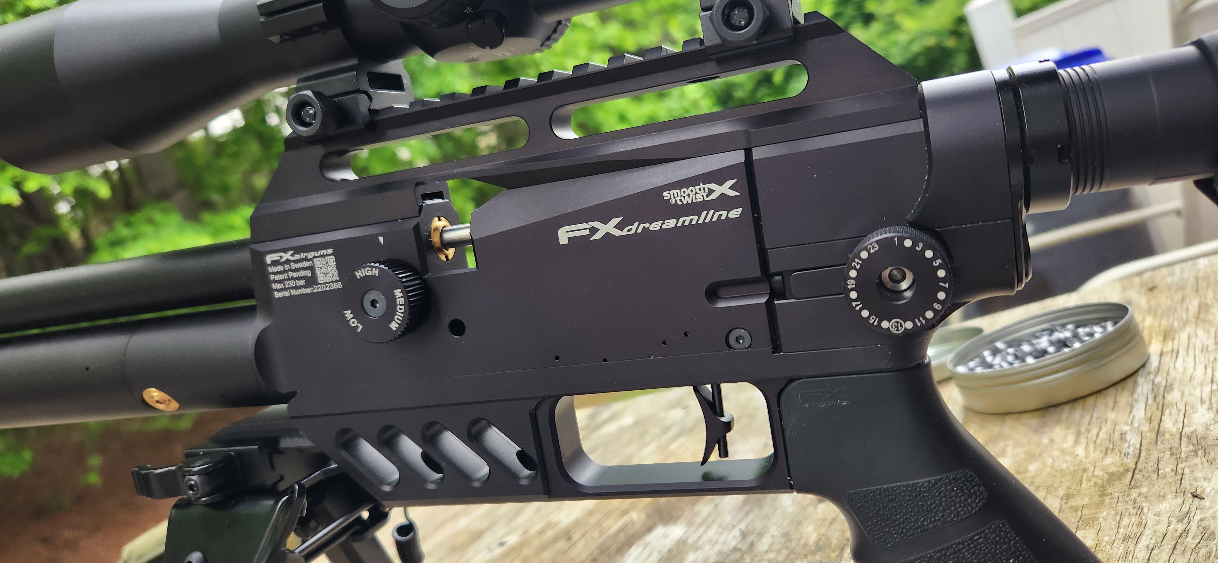

Hey, total new guy, day one. I just purchased an FX Dreamline tactical .25 tube version from Utah Airguns.
EDIT: I am shooting Exact Kings 25.39 I've gone thru about 2 150 rdtins trying to figure out a tune. I would like to be at 880. But everything I watch doesn't seem to apply to my gun other than the fact that they were right about the balance between the HST wheel and more pressure Def doesn't mean more power. I've tried every position on my wheel (which isn't labeled A-E 1-5 and "MAX". Its 1-23 1 being low side of the cam 23 being the high side. I have gotten the best results from about 118BAR on the reg and Max on the wheel and I'm getting 863-868... AND that's through 40 shots give or take 5. (More on the give). I have gone from 110 all the way to 140 trying to get 900 and I've seen 880 once. At 115. But it was at max and the spread was about 25fps and when I backed it off on the wheel... dropped to 845/850 . My TP is on "HIGH". I'm not understanding how the lower my reg the higher my velocities. On every position of the power wheel. Anyone got any information or tips to try out.
BTW, Name is Alex, I live in Gwinnett County GA (Buford/Lawrenceville area) I'm 38, nice to meet you all. Any tips appreciated.
Couple options here. If the adjuster for the hammer tension is anything like my crown you can change the preset. Try and take the "power" wheel off and see if there is a small Allen screw you can adjust on the sliding piece that rides against the wheel detents. Make sure not to lose the tiny ball bearings under the power wheel.
Option 2, get a custom hammer weight. This will open the valve more at higher pressures. The hammers in these guns and mine are pretty light so you don't need much weight to have an affect. I'd suggest maybe 4gm for your use case. Just don't ever dry fire the gun when it's low on pressure or empty of air. Also if your gun is anything like my crown you may need to shorten the hammer spring guide a bit if using an additional (custom) Hamer weight.
Thats about it. The valve is lifting less as pressure increases cause you don't have enough hammer weight to overcome the pressure behind the valve.
You might be able to massage the ports and probe a bit to help.

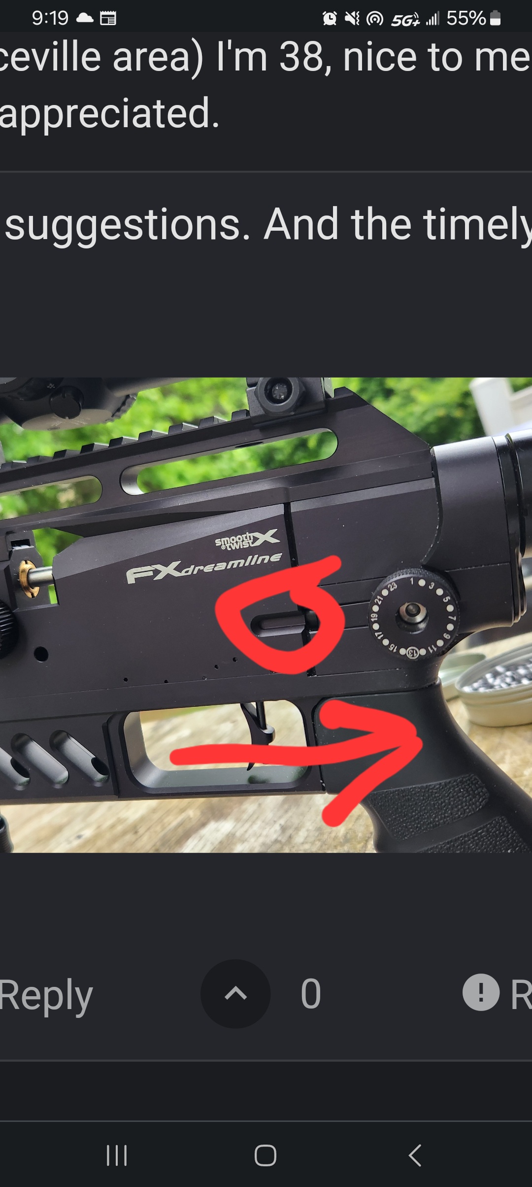

So, looking at this, pretty sure you dont need to take the wheel off, but it would make sense to remove the sliding piece under the wheel for adjustment so as to not mar the action or reciver while doing it. But im certain you can insert a small allen key in the recess and turn the screw clockwise to increase preload on the hammer spring . With everything fully assembled.
So, looking at this, pretty sure you dont need to take the wheel off, but it would make sense to remove the sliding piece under the wheel for adjustment so as to not mar the action or reciver while doing it. But im certain you can insert a small allen key in the recess and turn the screw clockwise to increase preload on the hammer spring . With everything fully assembled.View attachment 459115
Was hoping not to have to get into that yet. AEAC tunes a DL TAC 30/600[ and gets over 880 without having to go so far, and then gets around 940/98fpe using heavier Slugs. 910 airguns tunes a 25/600 tube DL tac to 940 pre addition of power plenum on 25.39 Exact kings. Thank you. Any ideas why 110bar-118 bar seems to be the sweet spot for me and everyone else I see is over 125-145?

Put your power wheel on max power, turn the small allen screw that adjusts the hammer spring in till you max out on velocity, then start turning up your reg till you start to hit the velocity you want +5%. 924 fps would be your max velocity. Once there, back the power wheel down till you get your 880 fps and all should be right with the world. You may need to bump up the small hammer spring adjuster screw the high your reg pressure gets, but usually isn't very many turns.
@Long_Gun_Dallas circled the hammer spring screw in the above picture.

I'm going to go ahead and accept Joe, Dallas, and Sqwirls answers as the likely solution as that's the only thing I've not tinkered with at all. Possible it's all the way on the low end considering this is a new out of box gun?
Anyway, maybe leave good enough alone. 865 at a relatively low pressure getting a great 45-50 shots with very consistent velocities and tight groups is plenty.

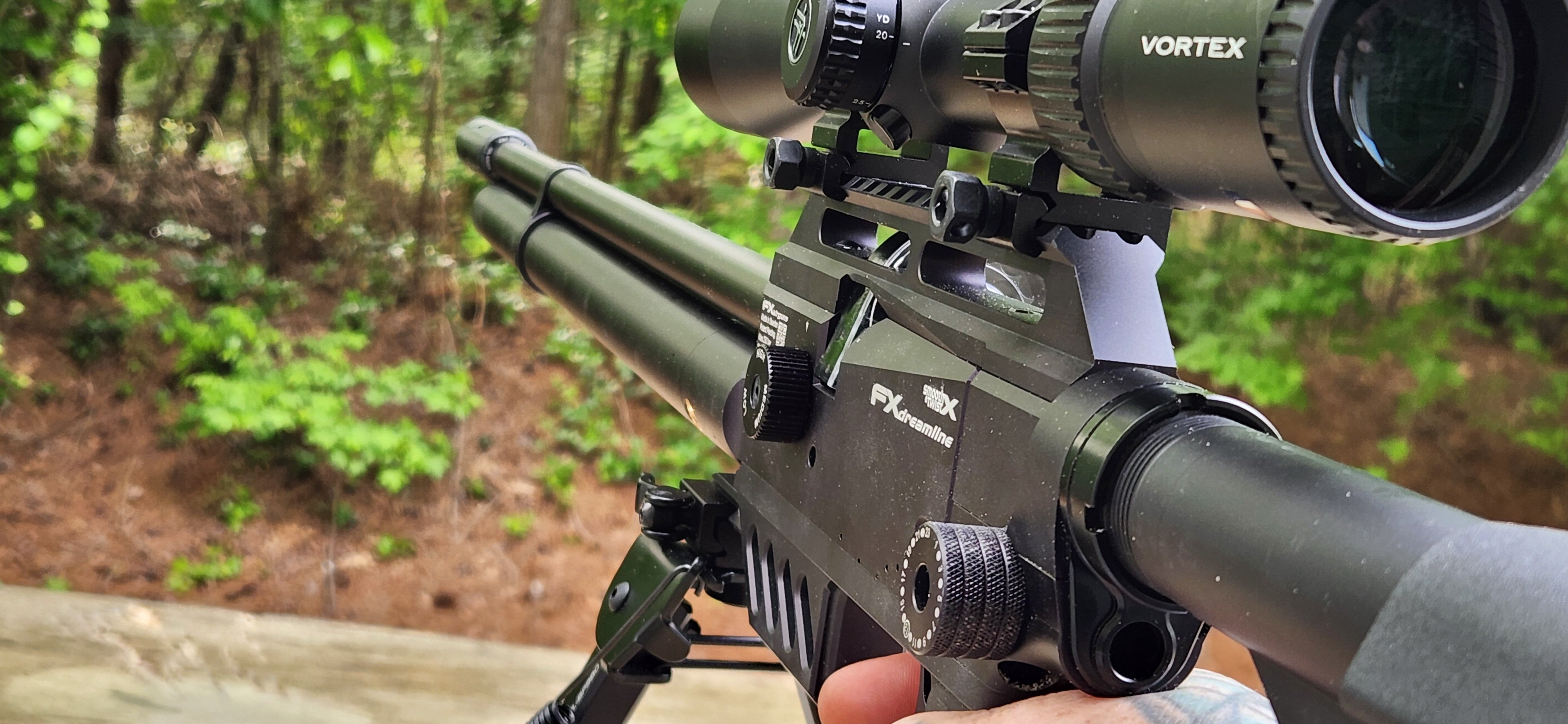

Knowing about that little hidden screw is key. I found, when chasing the power drive 16gr .177 pellets at 880 fps or so, the gun would do it but felt pretty harsh to shoot and shot count dropped by 50% or so over the 10gr pellets it came tuned for. I opted to use 13gr for my heavy pellet instead of throwing money at it.
Speaking of throwing money at it: I like that power wheel better than mine (the letters and numbers job). I may have to order one. :ROFLMAO:
