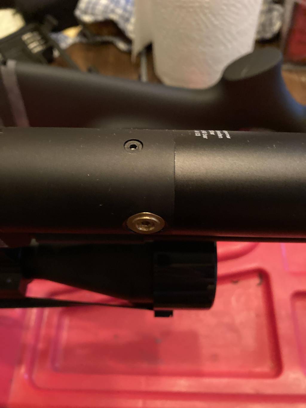

New Dreamline not holding air
Sadly my Dreamline did the same thing when I received it. I too contacted and sent it back to Utah. It was returned within a week and after I inquired.... was told the fill nipple was not tight enough.... easy fix. A little dab of soapy water around the nipple should tell you and with "slight" tightening, save you some frustration and lost shooting time.
 I did find the leak. It was the little black screw at the bottom of the air tube. The tech at Utah airguns had me snug it up a little. That seemed to stop the air bubbles. I filled the gun again and I’m going to let it sit over night and see if it holds.
