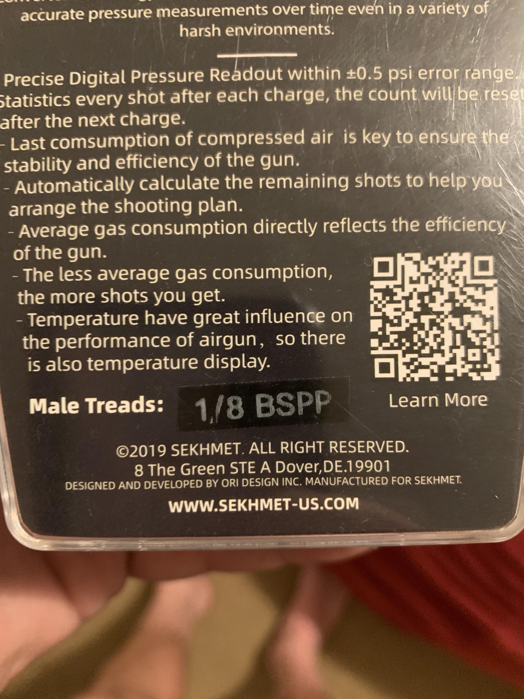

I just looked on the back of the packaging I have for the gauges that were sent for my Impact, they are indeed 1/8"BSPP. Sorry, I missed that. I was looking at the gauges available on the website under product parameters and they are listed as BSP. On the drop down menu though they are listed as BSPP. I should have looked at tha packaging too. Sorry about the confusion guys. The packaging I got my gauges in is labeled BSPP and I am using them on my Impact. That's what you'll need!
Stoti
1/8BSPP is what I have on my Impact. Sorry about the confusion, their website has them listed differently in two places. Here's the packaging on the ones I got for my Impact.
