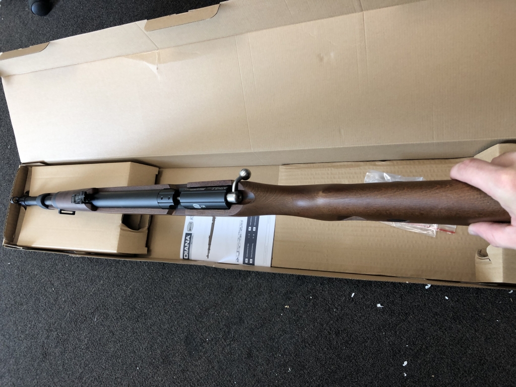

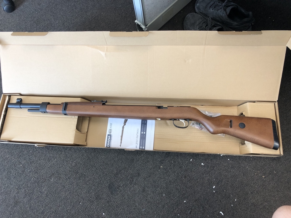

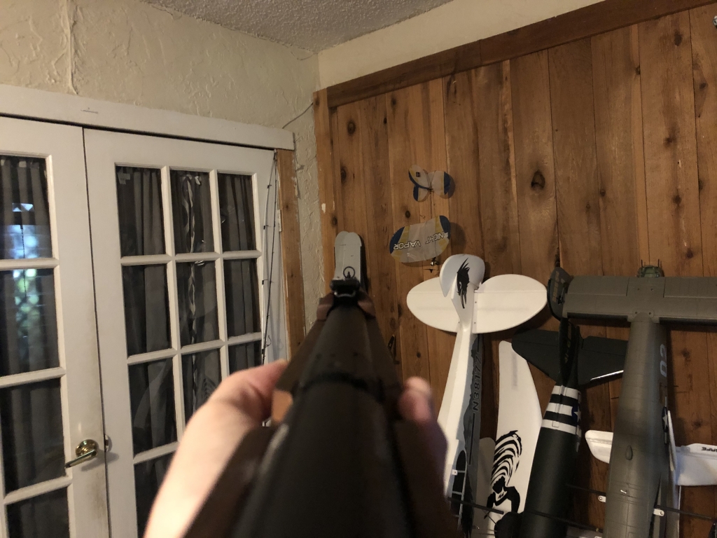

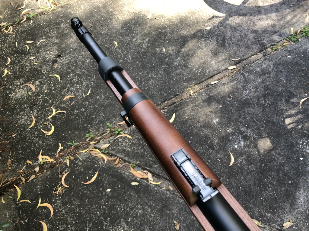

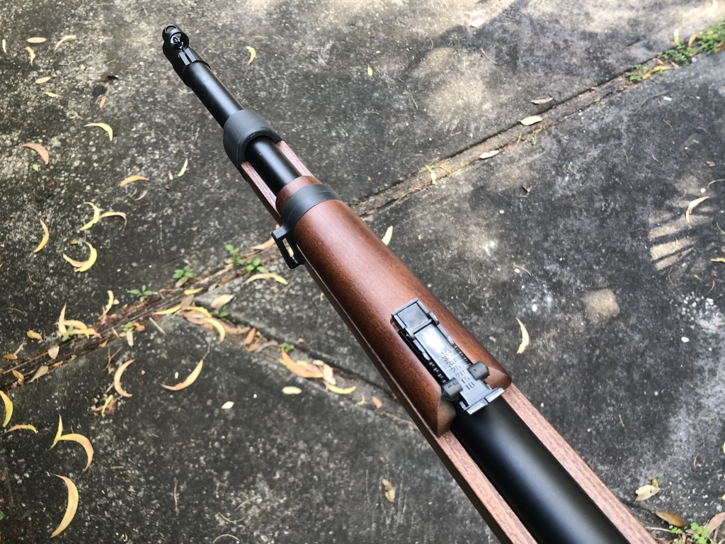

Received the K98 today. I have a small issue with the iron sights being loose and sloppy. I think a tightening of a screw will remedy the issue but getting to the screw may take a little tear down. I emailed pyramid letting them know there's no way this gun will hold zero on windage with the iron sights the way they are there is too much side to side free movement. I am sure it will be a simple fix but I am on the road to St Augustine for vacation so it will have to wait for me to tear it down. I did shoot a magazine through it and taping the iron sight so it will stop wiggling allowed for about 10 hole in hole shots at 15yds off hand with some JSB 15.89gn pellets. So this thing has potential. I will get more updates when I return

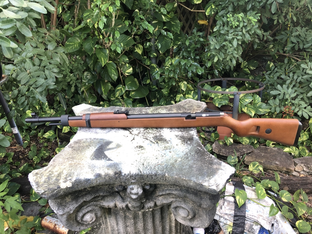

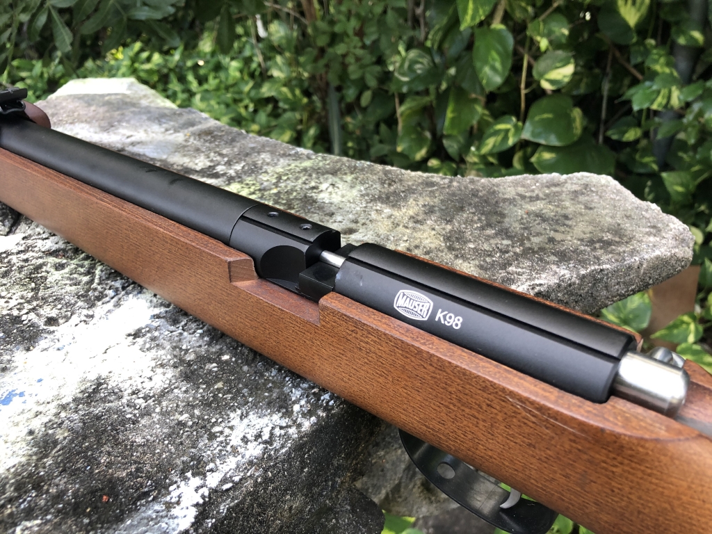

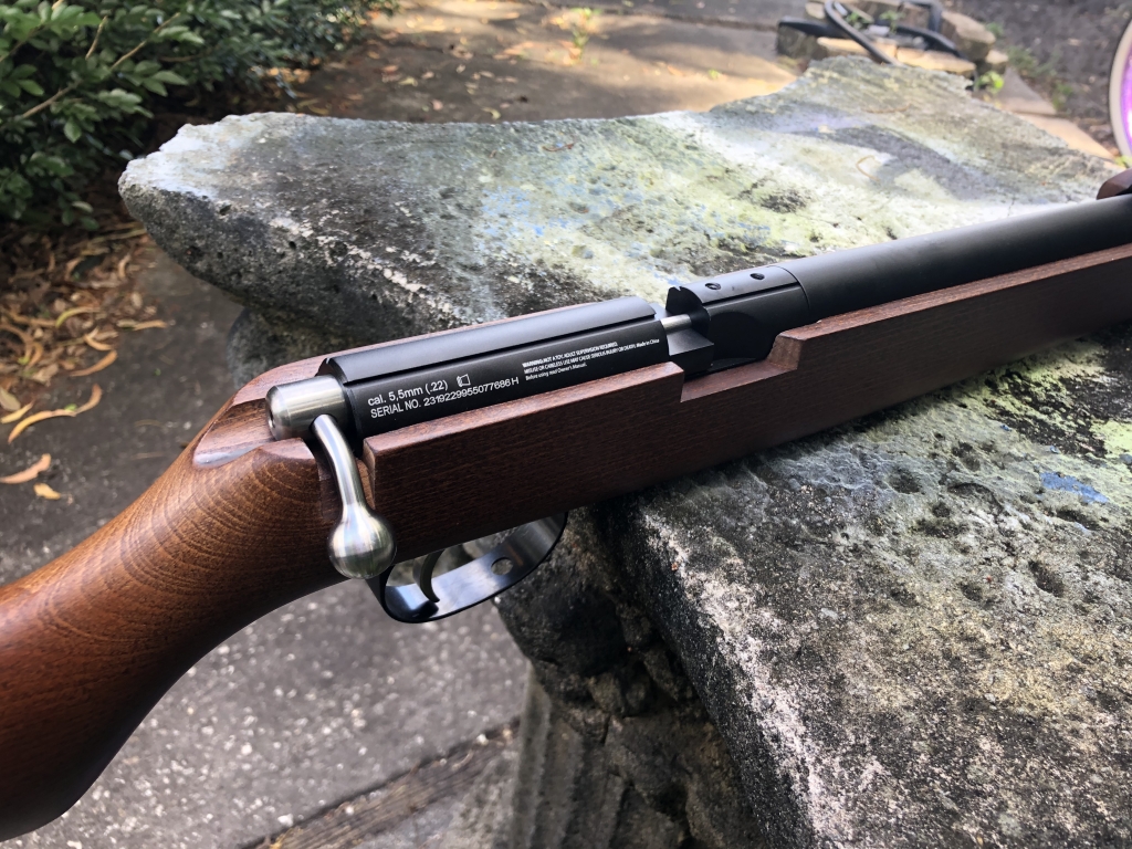

I was able to give the gun a good handling today and some range time. I fixed the rear iron sight, the metal plate pops out reveling two philips screws. I was getting about 21-24 shots on a fill today. I used both the magazine and the single shot tray and both gave the same accuracy. I have not fired it on the bench yet as I was having too much fun shooting off hand today and left my Streamline on the bench for 100yd practice. Ill show you two groups I shot off hand at 25yd with the iron sights. I was bouncing quite a bit but the gun performed great. I really enjoy this replica even some powder guys at the range were impressed. The front iron sight has a very fine point which really helps at longer range and I enjoyed it very much.
