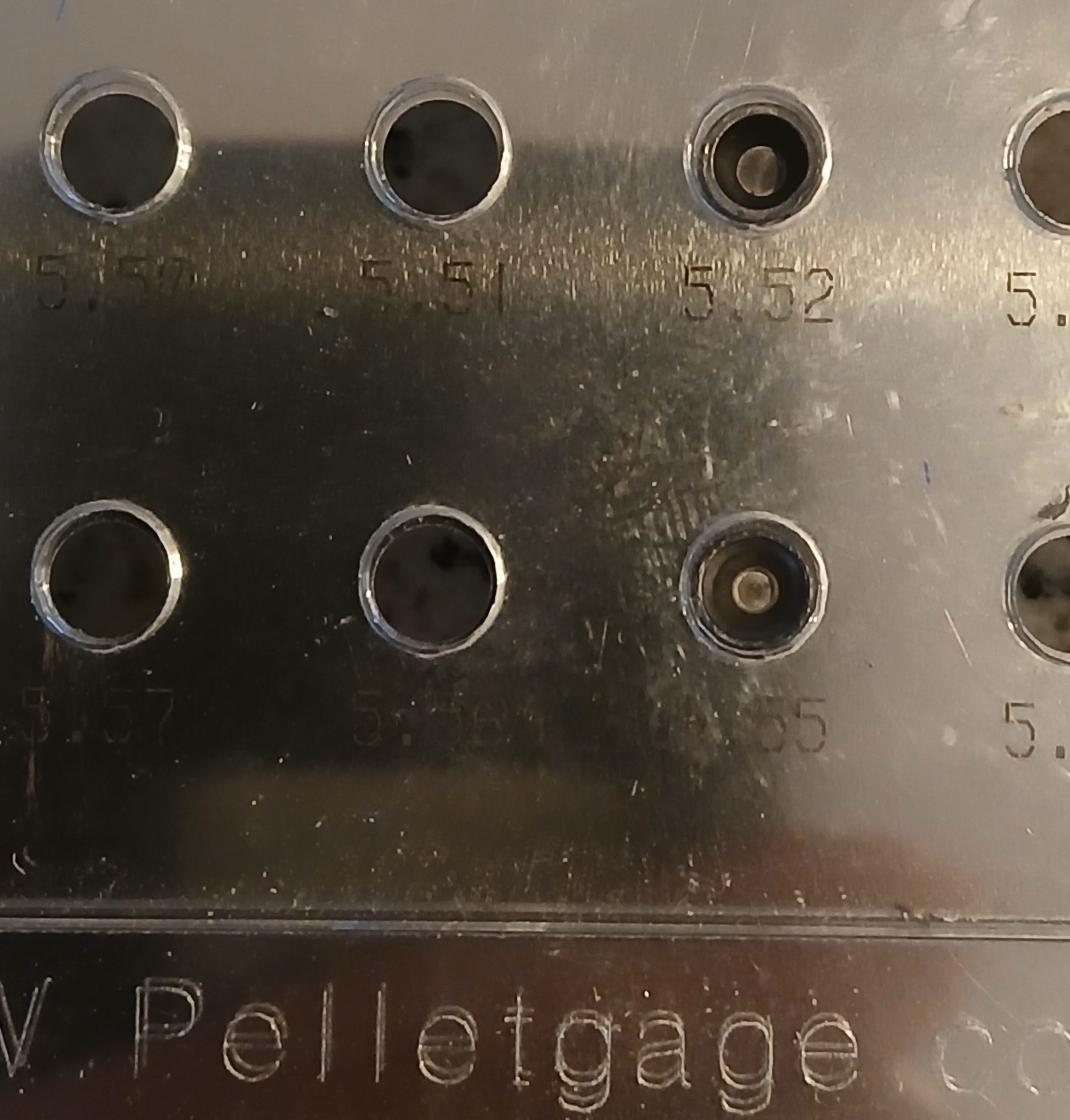

if you look at both pellets, you will understand, watch my video I show two pellets zoomed in from the back.
Diameter of the pellet same, skirt diameter same, skirt thickness same, just that opening is different.
look at the photos on top of the page.

If you look at the pics on page 2, they redistributed the lead from the skirt to inside the pellet. So the skirt thickness is thinner, and the inside is "filled up" more. This brings the flat part of the shape closer to the skirt opening, and since it is a cone, makes the hole look "bigger".
Since it is simultaneously taking away weight from the rear (skirt), and adding weight to the center mass, but also farther back... no idea how that shifts the center of gravity.
