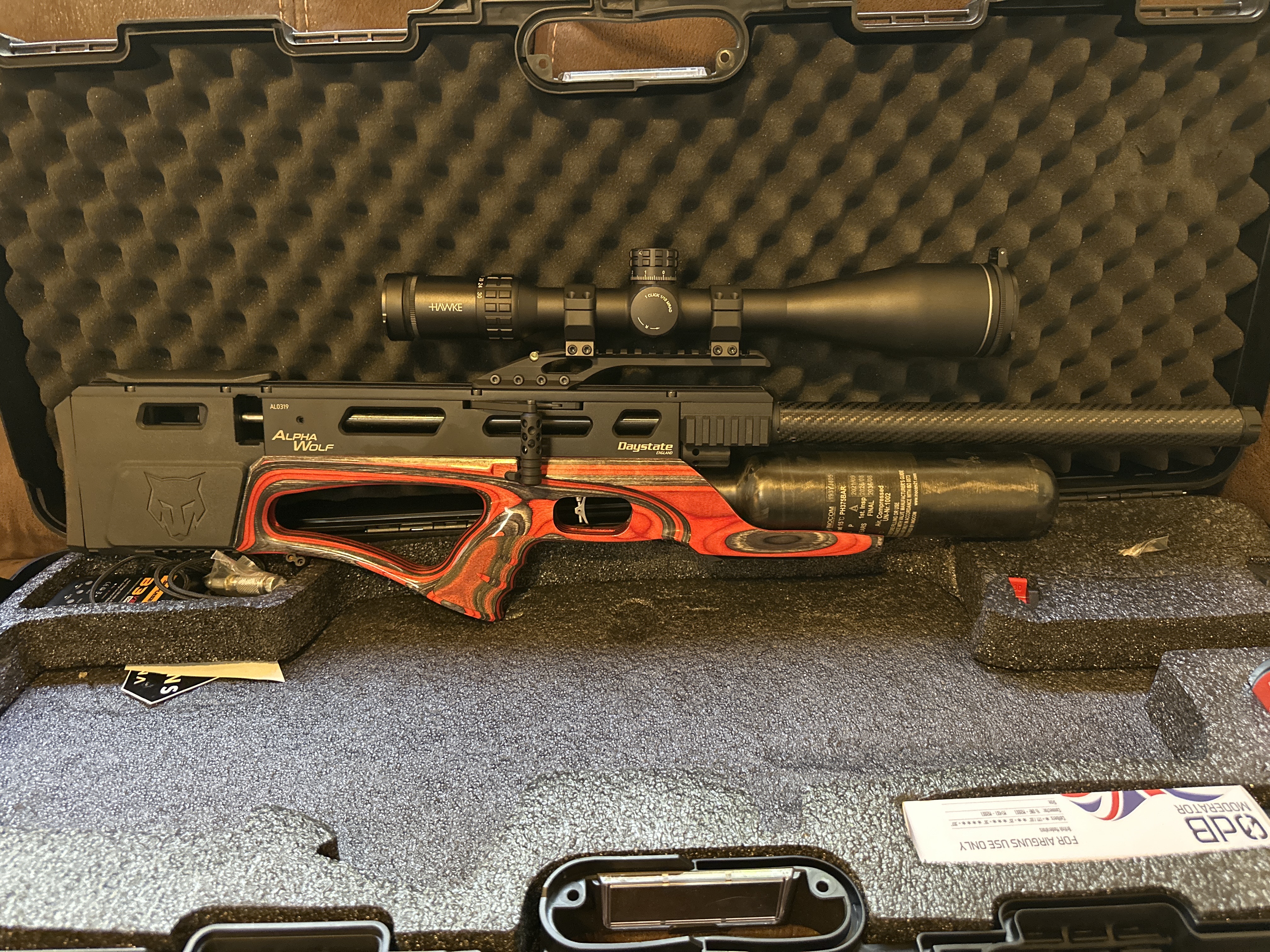

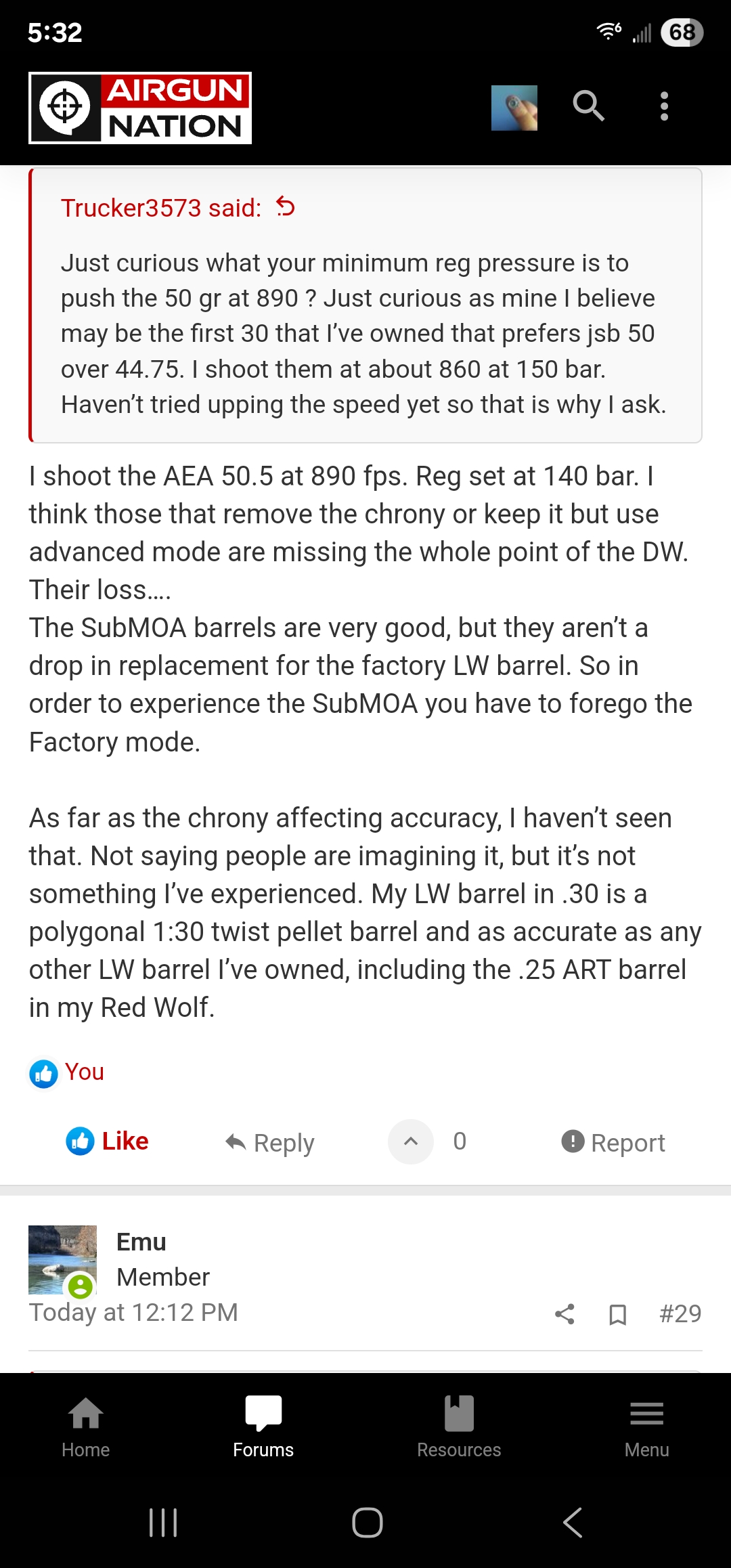

Hello All! New to the PCP world, just picked up my first from Airguns of Arizona. It’s a Daystate Alpha Wolf HP .30 with 23” barrel. Currently shooting the JSB Diabolo Exact 50.15gr pellets. Trying to figure out regulator pressure. There is a factory setting for this grain pellet and it sets the regulator pressure to 195/196. With a full tank at 240 Bar, I can only shoot a couple of mags before it drops below the regulator setting and gives me the low pressure warning. Curious if there is a better tune or regulator setting that is lower so I can get more shots out of the tank. Please forgive my ignorance as I am still learning about all of this but figured I’d reach out and see if anybody can share some of their knowledge/experience. This gun is amazing and I’m excited to see what it can really do as I learn!
