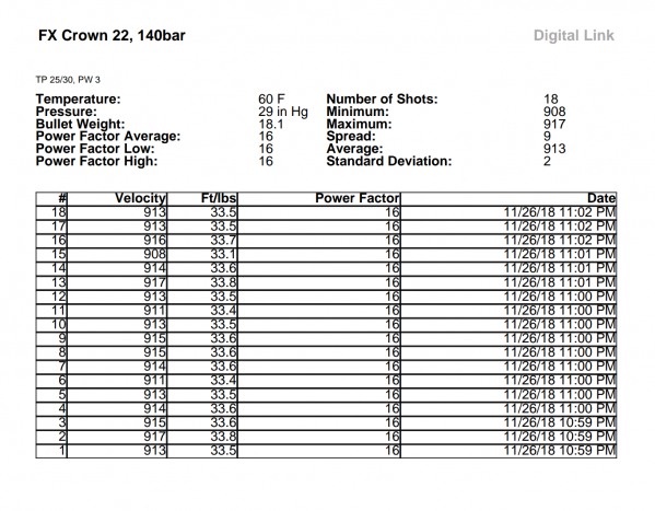

I have the Competition Electronics ProChrono and Digital Link add-on. This is what allows me to generate the charts.... actually it does that all in it's own, I just have to save them to my phone and/or print them out.

I was working on a new tune last night, as Matt Dubber said in one of his videos that he is shooting the 18gr JSB pellet accurately at 900fps. So I found this combination of settings that got me a bit over 900 while sounding nice and quiet.
Super impressed with this rifle and regulator performance!!

I also own a crown and have a question: When you tune, do you check the max velocity for the reg pressure, like when tuning at the "knee"? In your graph where you have 913fps, and the wheel on 3, I would guess setting it on 4, or 5 will reach the maximum speed for that reg pressure? Or do you stay way lower than max speed, where you might not reach it at all at max power wheel setting?
Yes, increase hammer spring tension to the point where there's at least a plateau if not a drop-off....then back it off to just before the plateau.
Reason its on 3 is because I didn't tweak the adjuster to reset the power wheel after that so it falls on Max.
I've thought of making a video, if not then just a thread, on the power wheel adjustment. Seems there's quite a bit of confusion out there regarding the numbers and/or letters.
It's not really important what position your wheel ends up being in for max velocity, rather what's important is that you have adequate pre-tension to be able to use the wheel to find max velocity properly.
If you don't have sufficient pre-tension, and don't know the correct procedure to find max velocity, you might end up on Max power wheel setting but be well low of the plateau.
In that case, the only way to get more tension would be to lengthen the internal adjustment screw. What that would do is shift your Max position down to say 2 or 3, giving you room to use the wheel for more adjustment.
If you then wanted to have your wheel read Max, you would need to decrease the length of the internal adjustment screw to match the profile of the cam with the wheel in the Max position.
When I say "you", I don't mean any person in particular.
I hope this helps.

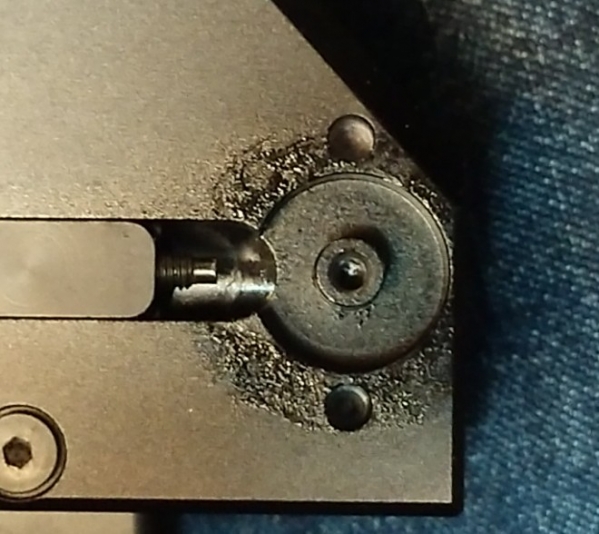

I considered trying it "box stock" but when I saw how much slop was in the adjuster, I just had to remove it. Ernest Rowe maybe, or others have said the first thing that should be done is to remove the slack so that's what I did.
Here's a pic I took before adjusting it....it shows how much slack was in there....A LOT!
I just got my fx crown synth as well. My first PCP. What is this picture and where do I go to clean this? I searched for youtube videos by people mentioned but none found.
TIA
That's just lube....it can stay there. Thats the internal adjuster for the Power Wheel (hammer spring tension knob), top left rear of the rifle.....with MAX, MIN, numbers and letters.
You don't need to adjust the internal part unless you want to tune for higher power/more velocity over factory. I'll link a video for you.
https://youtu.be/OC4ZGtGPKCc
