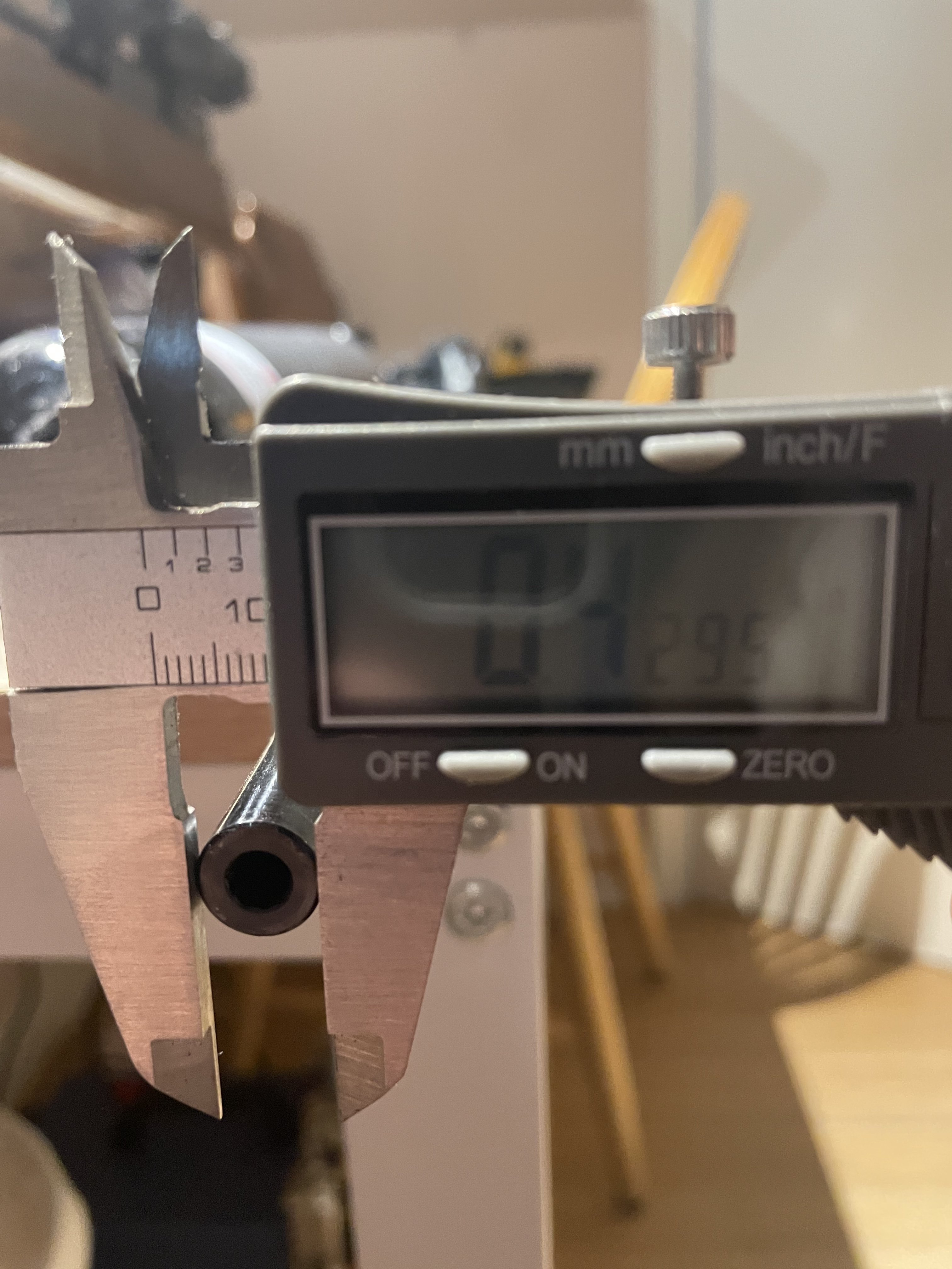

New Crosman barrel smaller diameter?

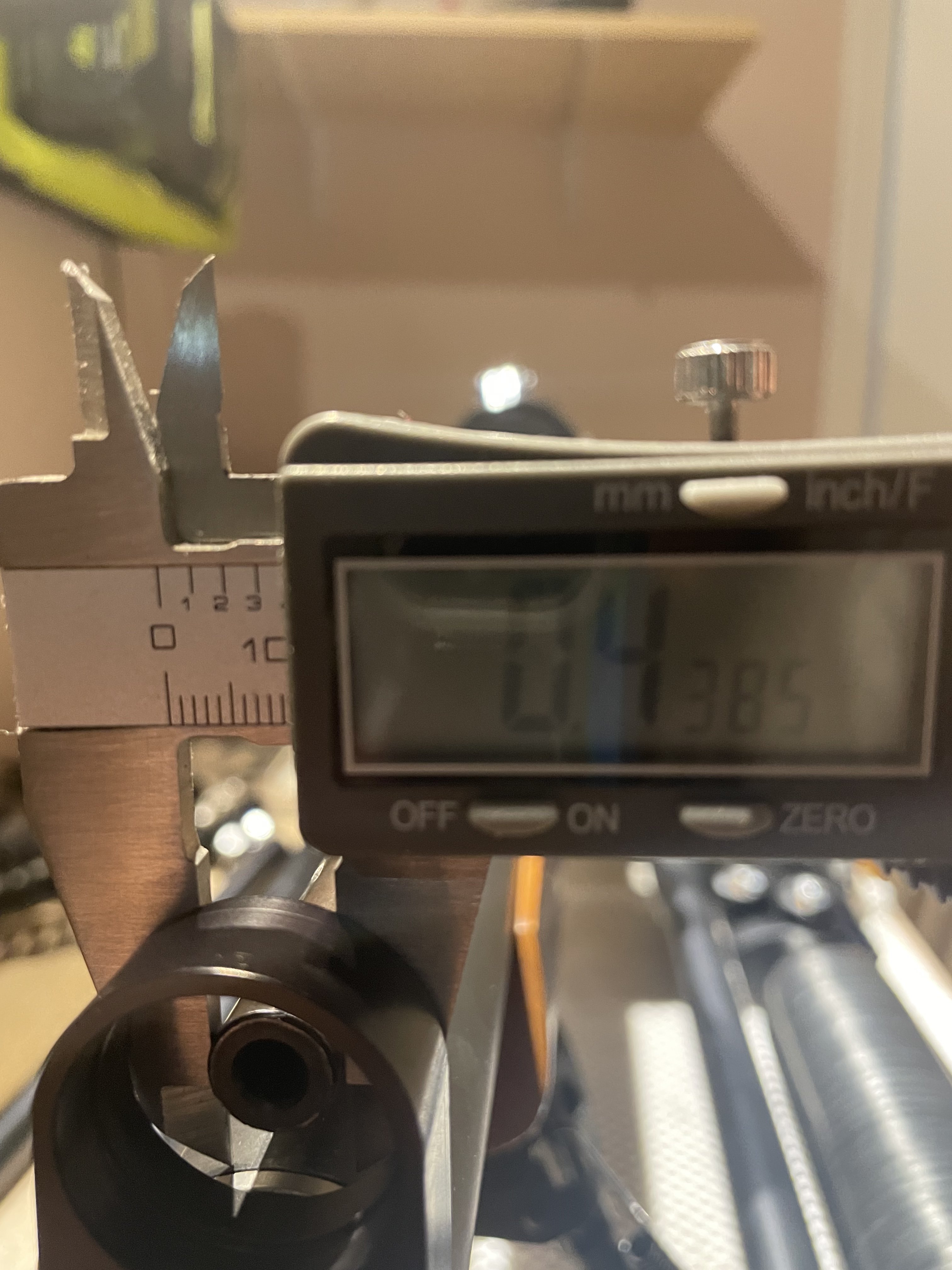

The choke on the newer barrels must be tighter. First picture is the new barrel, one attached to the gun is the old style. That’s why the old air stripper won’t fit. The play in the receiver is the same for both barrels.
I just wrapped a few turns of Teflon tape around the end of the barrel so the air stripper fits snug. We’ll see if accuracy improves with the new Crosman barrel.
If the Teflon tape doesn't stay put for some reason, I have found that a turn or two of clear packing is a very stable way to shim slip on air strippers/shroud bushings.
