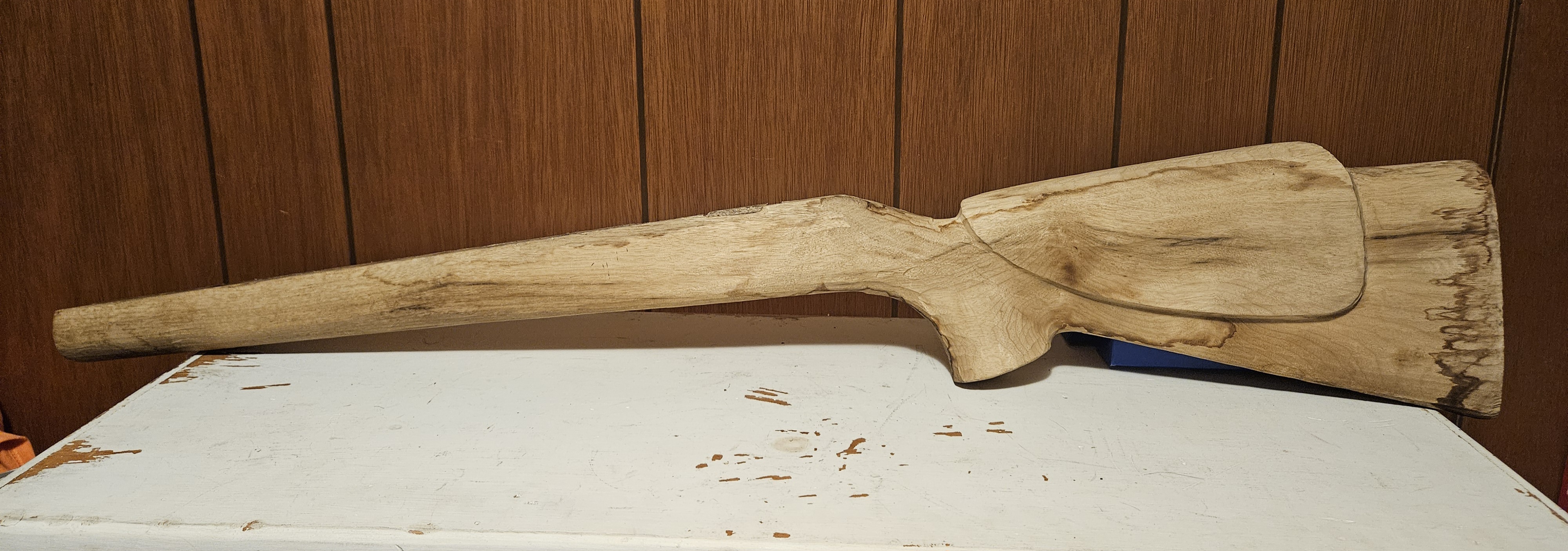

I have a marauder trigger and one of Rob's multi shot breeches for mine. Going to either order an Mrod barrel and cut it back so I can keep the shroud just shy of the air tube end, or drop in a Kral barrel I have here.
Also going in this stock, a Sako K98 mauser. Love the sporter stocks on these thin guns.

Nice stock. I am not sure I understand a MRod barrel and shroud? How??
Oh, the multi shot breech has the same bore diameter as the 22 caliber Mrod barrels @ 7/16". The breech requires a barrel to have an internal o-ring to seal the bolt, as it uses an Mrod magazine as well. The shroud will have to be custom made so its the same diameter as the air tube, or a little smaller. If it's bigger around my OCD will freak out!

I'm personally making a trigger guard for the K98 stock that will fill in the magwell inlet of the mauser so it should look factory when done. I've got 4 of those stocks, so I may be in trouble here shortly when I find myself with 4 more crosman builds. Well, 3... one of the stocks is spoken for... my 2240/1358 beeman tube and valve rifle.
