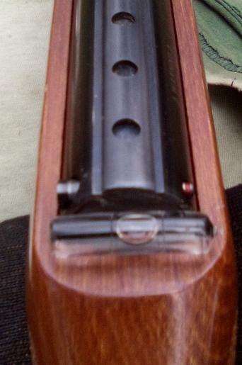

on my Benjamin Titan. Made a big( play on words here) difference.
I have done the same thing many times over the years, but rather than glue, I use a piece of modeling clay or that stick stuff they use to hold pictures on the wall, comes off easy and is reusable!! Gotta love simple and inexpensive ideas !!Lol. Good one ..
My affordable cant , cante device. Just pulled the vial out of a old bent level and glued it on ( easy to remove glue).
Ya, the glue i use was easy removable and rubbery like . Kinda held good and quick easy clean up . Just right for that little jobI have done the same thing many times over the years, but rather than glue, I use a piece of modeling clay or that stick stuff they use to hold pictures on the wall, comes off easy and is reusable!! Gotta love simple and inexpensive ideas !!

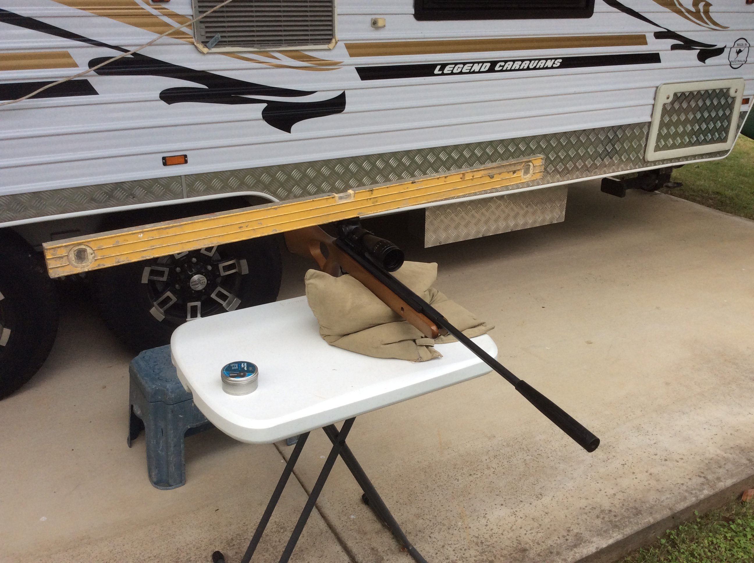

i use a level attached to my scope so that the cross hairs are spot on . then i level the scope so it is exactly in the middle of the bore , the vertical cross hair cuts the bore in the middle. using the mirror method.
On low power i can see the front sight post and its dead on the vertical hair.. like you say right down the barrel..i use a level attached to my scope so that the cross hairs are spot on . then i level the scope so it is exactly in the middle of the bore , the vertical cross hair cuts the bore in the middle.
exactly if you set the scope up this way you can't cant if the level is showing level .Are we mounting or a cante level?
